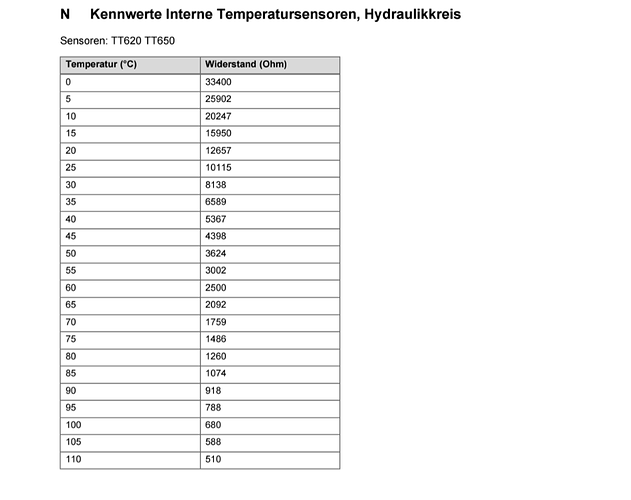

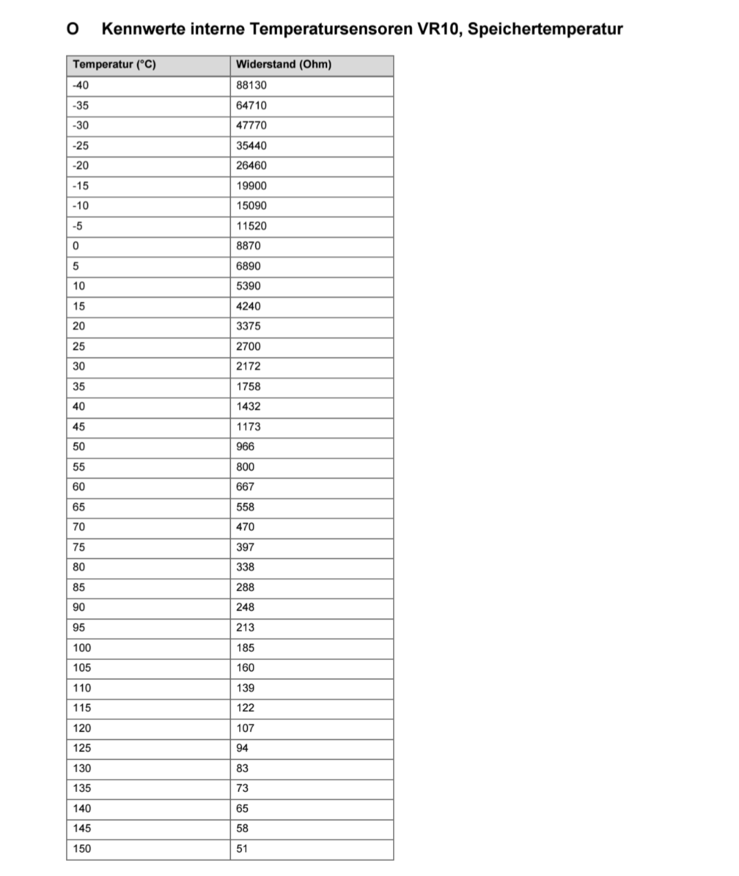

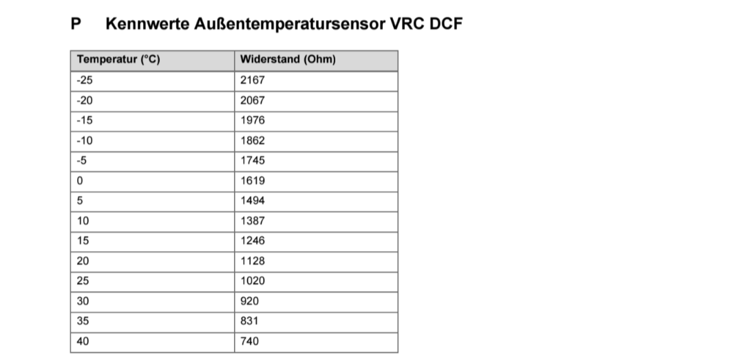

We have Vaillant manuals which contain tabulated data. I attached the full file.
For reference, here are screenshots of the tables. German only, unfortunately.

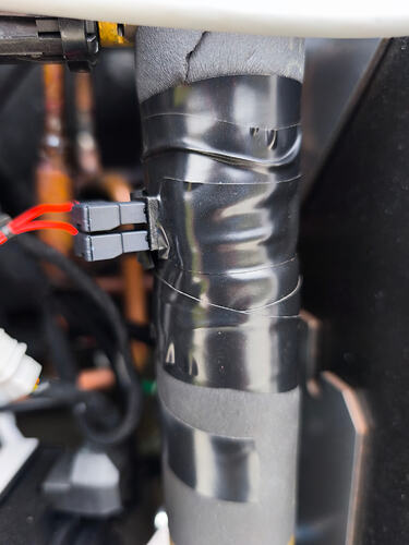

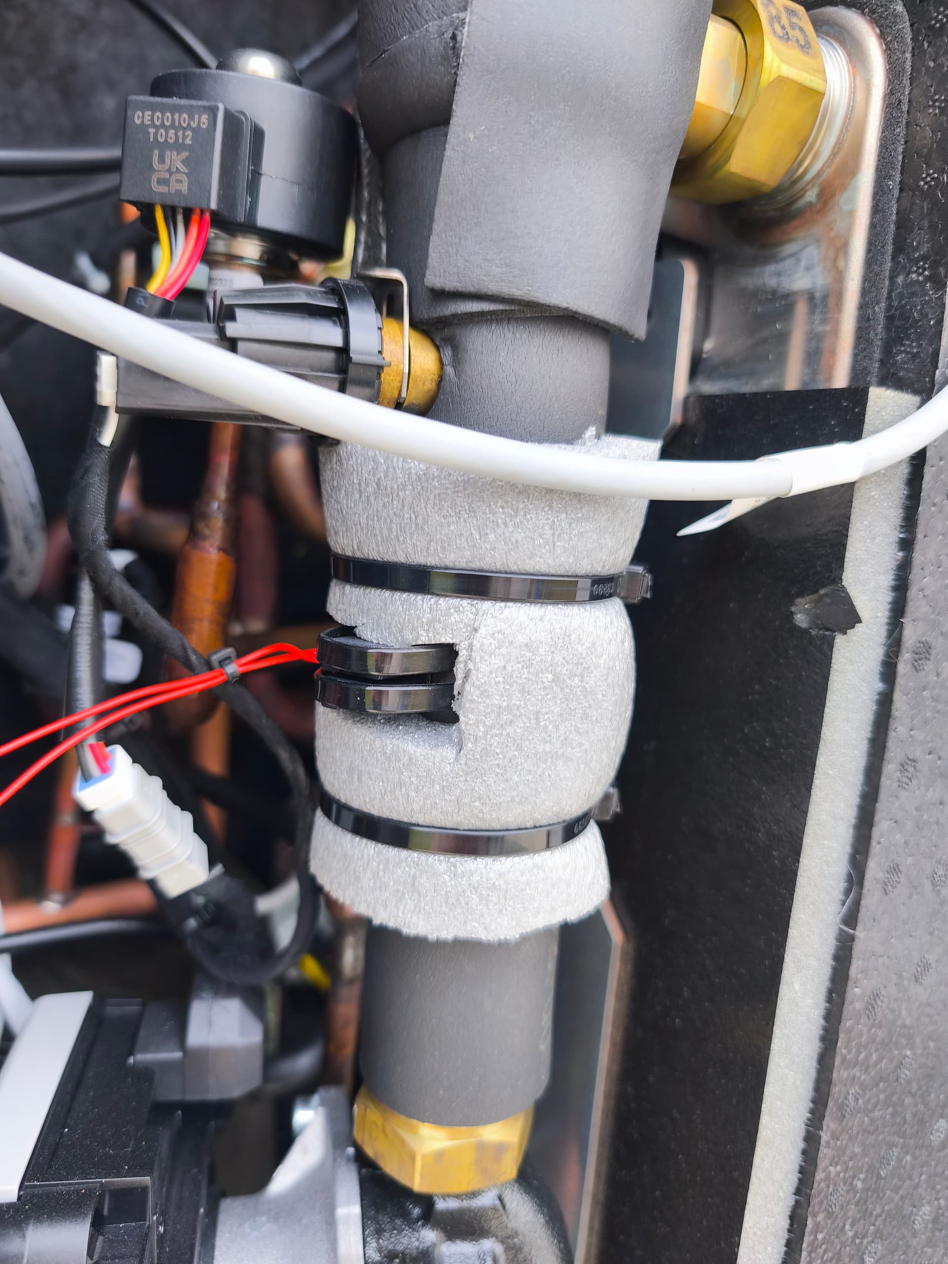

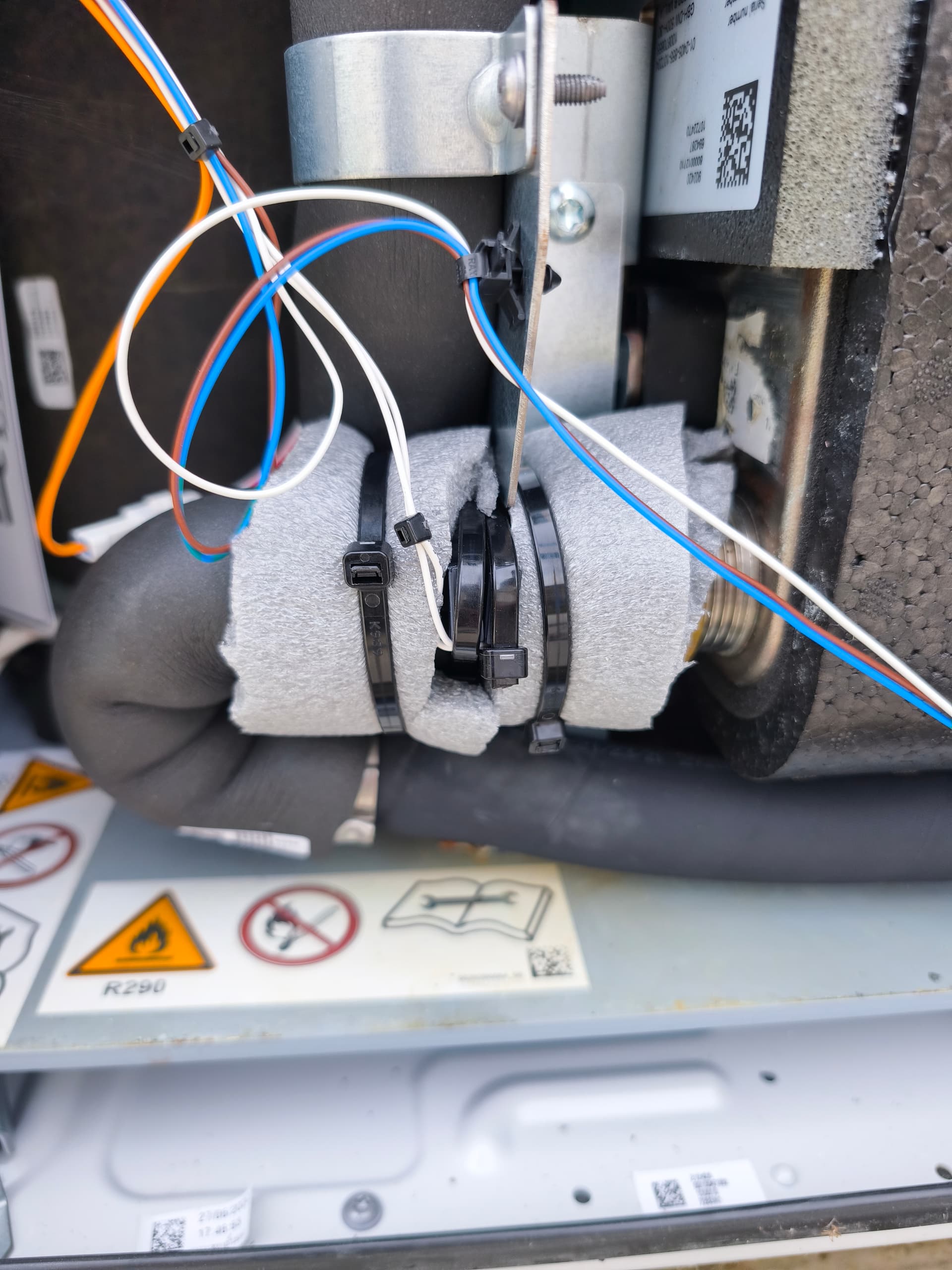

I’ve just had a look at my temperature sensors and found similar to what others have found. The insulation was wedged between the clip and the pipe on the lower sensor, not sure if it’s made a difference yet, yet to test it. I’ve also cable tied the sensors and roughly put extra lagging on (without pinching the cables) to see if that helps.
Unfortunately no difference for me. I have a 0.9k differential, return being 0.9k higher than flow, so under reporting COP I believe? Currently struggling to hit the 3’s.

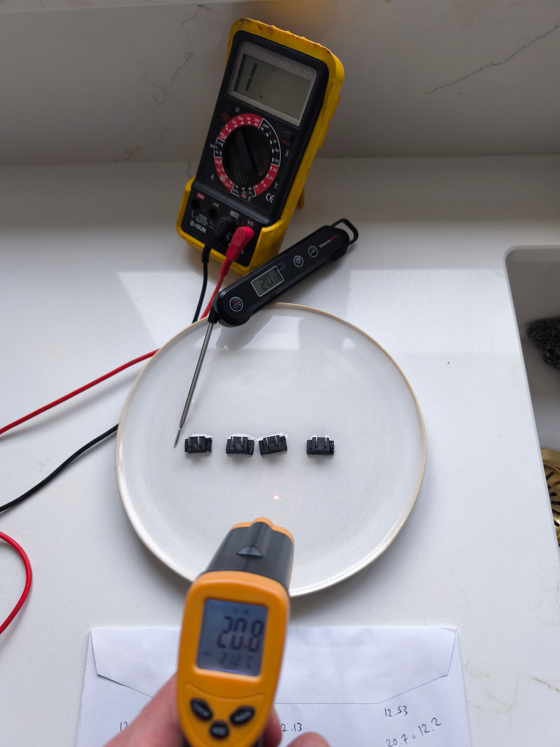

I tested my current sensors once I removed them and found a difference of 0.5k ohms which was equated to difference of 0.9 degrees. Once I got them all in one place I put them in a bowl of water to measure how close they were to each other:
Original sensor 1: 12.12 k ohms
Original sensor 2: 12.55 k ohms
New sensor 1: 11.91 k ohms
New sensor 2: 12.17 k ohms
I ended up re-using orig sensor 1 and new sensor 2 being only 0.05k ohms difference.
I then refit the sensors, made good the insulation and taped up around the sensors. Restarted the heat pump and now have a offline Delta T of 0.1 degrees between flow and return. Happy days :+1:t3:

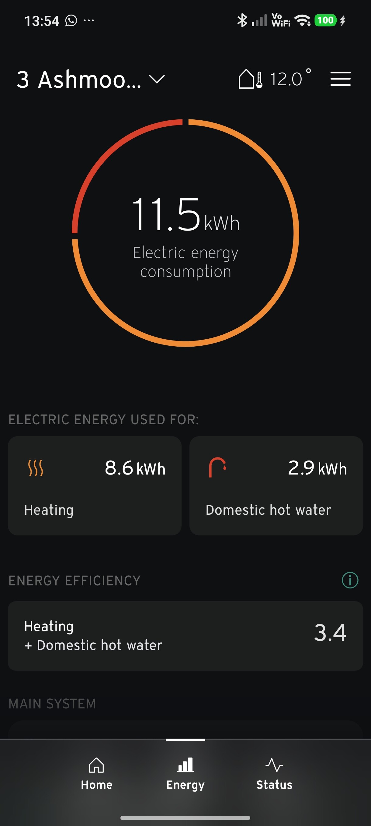

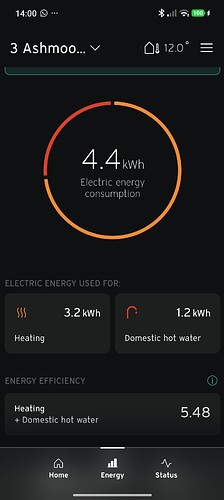

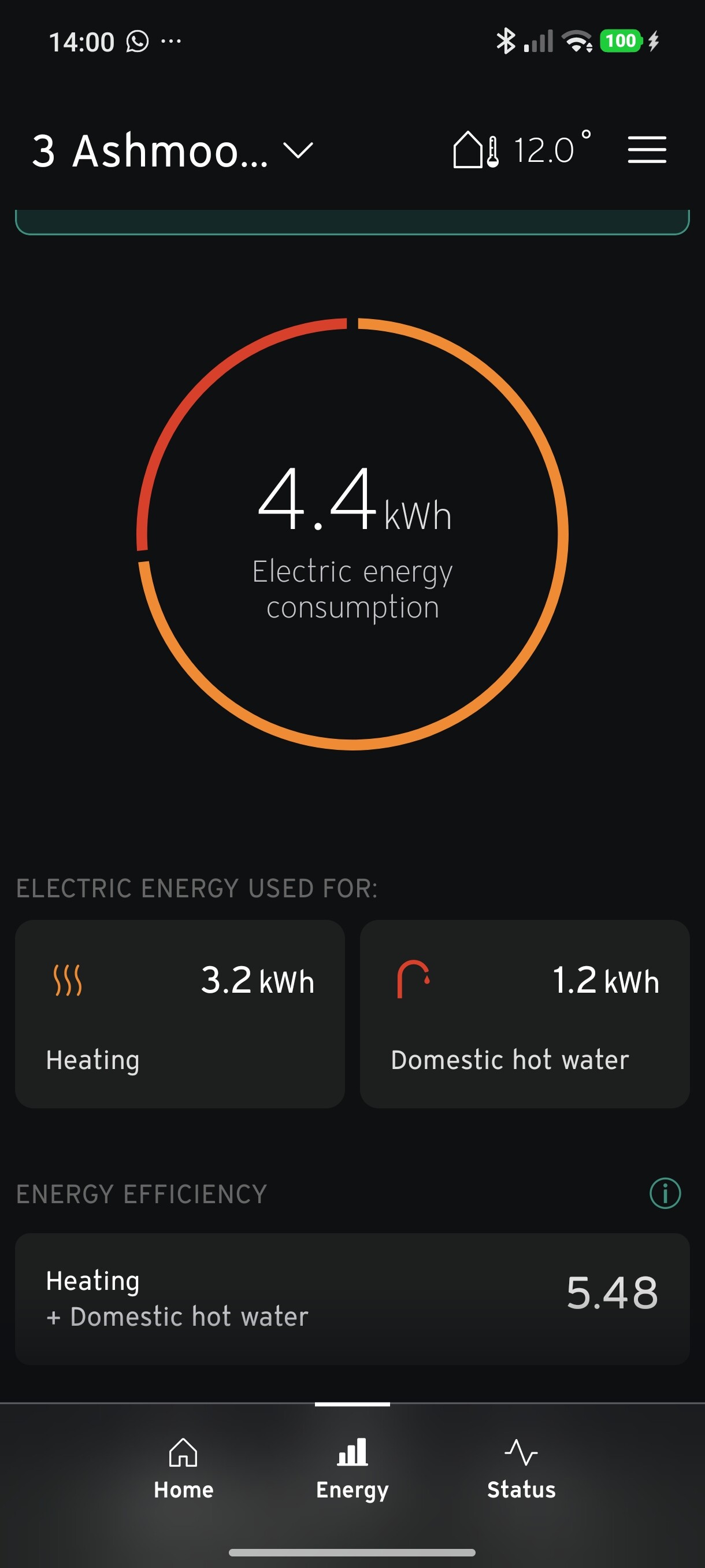

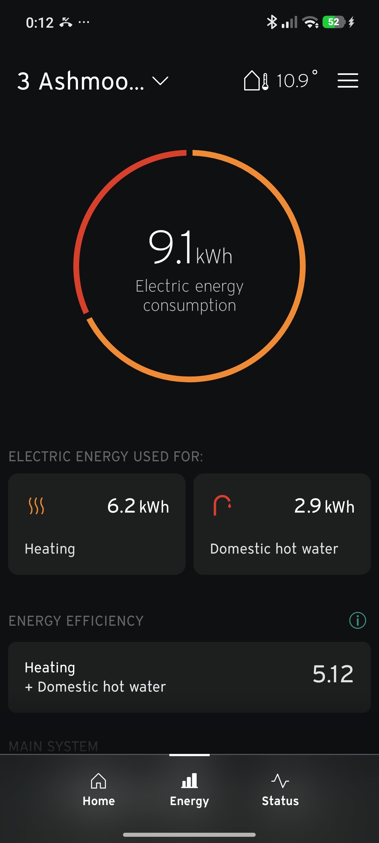

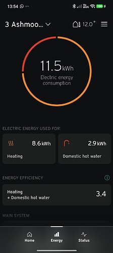

For reference, I struggled to get above 3.5 on the COP on the old sensors (return sensor was the higher reading of the two) but for the last 2 days I’ve been over 5 COP which makes more sense as my flow temps are generally really low and the house is always comfortable. The two images below are from today (so far) and 11th Feb were the outside temps were the same. Previous COP 3.4. New COP 5.48. I will continue to update COP readings to confirm, but a lot better than previous. It’s great to know that you now have two sensors calibrated closely to one another. Thanks for all the help on this.
Just a heads up, your address is partly doxxed in those last two screenshots

Just a heads-up: the adhesive on the PVC tape around the pipe insulation will go brittle and fail very quickly in the environmental conditions inside the ASHP. I’d replace it with double sided hook & loop (Velcro) on a roll; this stuff doesn’t degrade, and is easily refasten-able if needed.
Just to update, COP for the day finished at 5.12! Now to just get rid of the 4 port buffer and glycol :joy:
