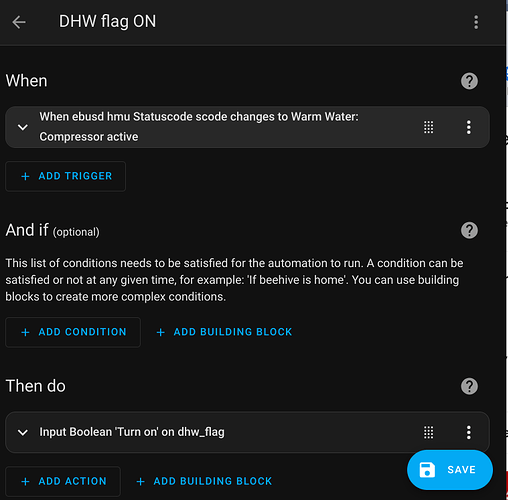

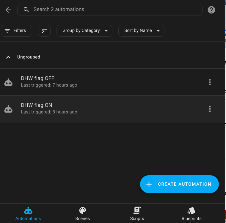

I found that ebusd hmu Statuscode scode was better to use for a DHW flag than ebusd hmu RundataCode scode, the Statuscode metric responds a bit faster than RundataCode

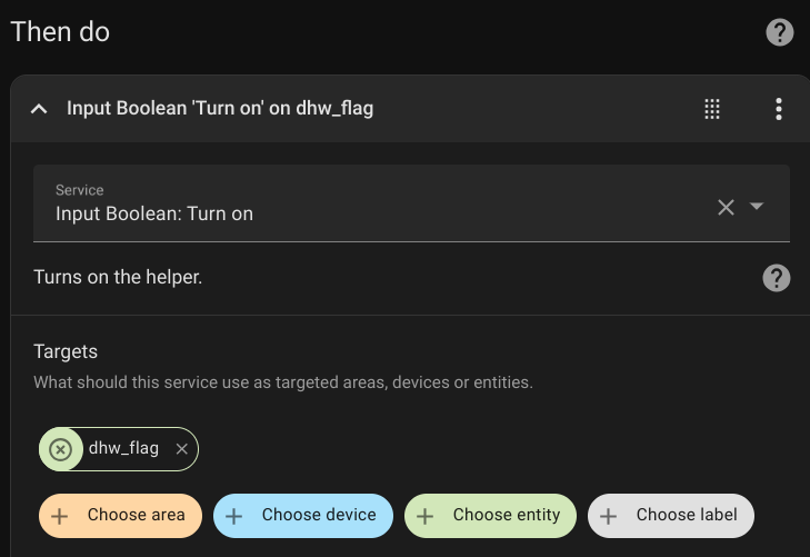

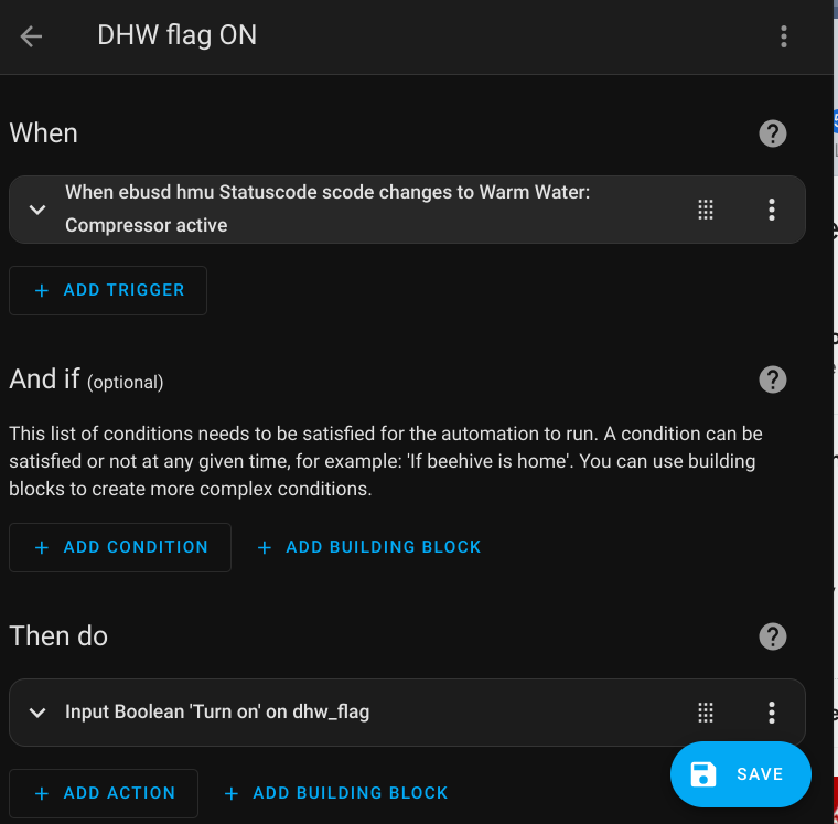

It was actually relatively straightforward to convert RundataCode into a boolean DHW flag. I used a HA automation to trigger for when RundataCode changes to Warm Water: Compressor active
This automation then use a HA helper function to set a Input Boolean dhw_flag to ON

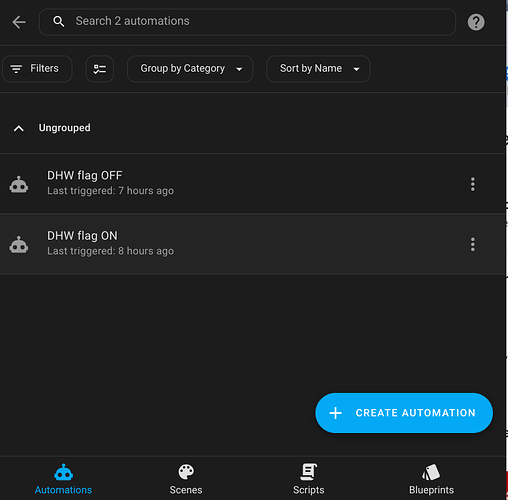

I also created a 2nd automation to turn the dhw_flag OFF when RundataCode changes from Warm Water: Compressor active to something else.

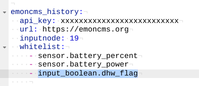

I then used Emoncms History HA integration to post the input_boolean.dwh_flag to emoncms.org
Screenshot 2024-07-29 21.41.05

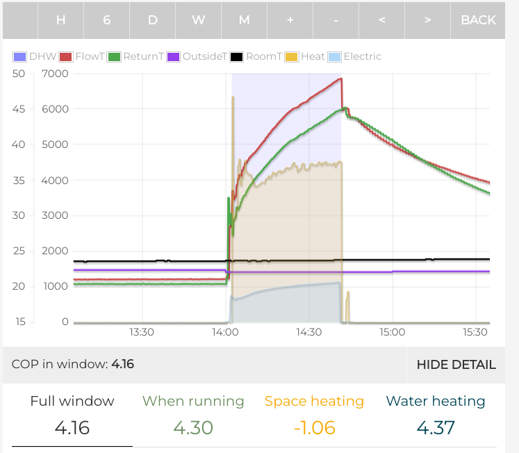

Once in emoncms.org the dhw_flag Input is logged to Feeds and then selected in the MyHeatPump App, the DHW cycles are now correctly flagged :slight_smile:
