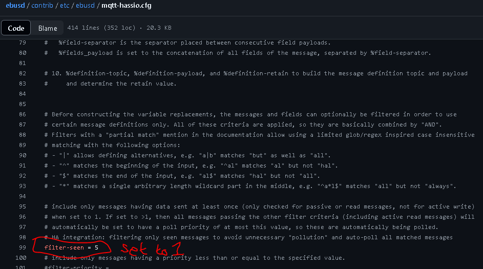

Hi all.
I began my journey with the ebusd integration last week using the ethernet module and running it in HA.I had a few problems; once I had an F9998 error overnight which I cleared and another with DHW like @Zarch experienced. In the MQTT RunDataStatusCode it was showing “blocked flow” or something similar so I turned the ebusd off, reset the Vaillant controls and ran a DHW boost about 30 mis later which worked fine.
I left it a few days without the ebusd connected and no further issues.
Logically then, it was the ebusd so I started again today and pulled JonesPD (rather than john30’s) config which I loaded this morning. Hopefully the DHW will run OK today at 13:00.
One thing I did notice was that on the app, “Ventilation Boost” appeared. it wasn’t there before I connected the ebusd so it must have been something that wrote the config. However I cannot find anywhere in the Vaillant controls to remove it.
Has anyone had this or know how I can remove it manually from a ebusctl command or modified csv file?
To be honest, i’m stuck with my install.
I fired it up last week for the first time in ages and tried a different config file fork
And the first night it screwed up and stopped during a hot water run (so same error as I reported before)
I really don’t know what’s going on with it all.
Perhaps I will go back and try the very default config file. But they seem to be lacking all the interesting values.

Failed after a few minutes with:
error_dhw
OK, so I set the value of “filter-seen” from 5 to 1 restarted the HA ebusd and re-ran the DHW at 12:30.
This worked ok.
I have no idea of any other impact of changing this but did read somewhere it was an option.
