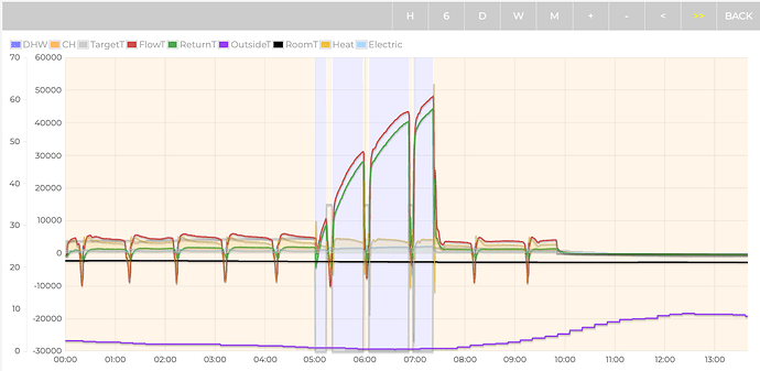

I will observe over the next few days with ebusd off.
But it looks quite clear that the current ebusd/jones files is causing me some trouble with DHW.
Too much of a coincidence that the day i upgrade things go wrong and the day I turn it back off things go back to normal.
My only theory is that there’s too much polling from the ebusd to the Arotherm controller? Ie, it’s too busy now? Don’t know, just guessing.
Just wanted to make you guys aware.
Andre_K
(André Kühne)
72

Just to add, it’s not only a problem with DHW, but heating also.
Check out this trace from Thursday with ebusd running
I should not be getting those cycles / stop / start at 4C outside.
Here’s yesterday with ebus switched off.
Much better. The drop at 9:30pm is just going to setback.

I updated to latest version of ebusd yesterday evening and I also pulled the latest vesion of the JonesPD ebusd-configuration fork at the same time. I am still polling every 10 seconds but have not observed any issues so far.
My use of the ebusd does not include home assistant and I poll data either via i) ebusctl command ii) HTTP/JSON interface. Also, I only read, I am not currently writing anything.
This is today
