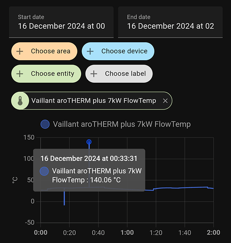

That looks like some kind of bit error. Maybe there’s still something a bit funky with the connection? Are there some sources of interference nearby (PV battery storage, inverters etc)? If they don’t go away you can just filter the values out with a template sensor.
All of the connections look tight now. PV and battery connections are in another room so that shouldn’t interfere. It looks like FlowTemp also had a similar wobble.
Something seems to cause interference on the ebus, but I don’t think it’s going to be easy to track down. Could also be something with doing ebus over Wifi, but I have no experience with that. As I said before, I think I would create template sensors for all relevant sensors and just filter them to be within a physically sensible range.
Are those glitches at the same time?
Yeah that sounds like a sensible approach. They weren’t at the same time no but close, within a few minutes of each other. I’ll monitor it and see if it happens again, and if so, will create some template sensors.

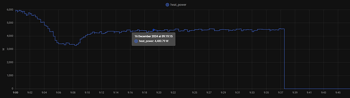

Interestingly the heat_power template sensor you provided in an earlier post shows a higher heat output vs the CurrentYieldPower sensor. I would have thought the Vaillant’s output would have been inflated rather than the other way round.
That’s because Yield in Vaillant speak is just energy extracted from the environment, heat = yield + electrical.
So would you say heat_power is more accurate?
They are just different metrics. I have no clue why Vaillant has this fixation on showing the energy extracted from the environment. Heat power is what’s actually relevant, because this is what actually goes into your house.
