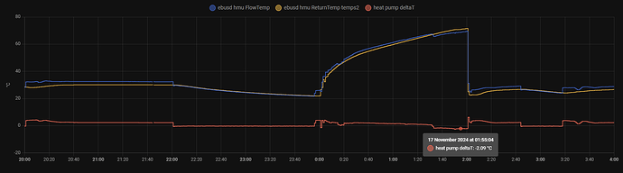

Continuing from my post above, I have been monitoring the weirdness of the Vaillant flow and return temperature sensors. The summary is that:
  • I mainly see a discrepancy of about -0.3 degrees when the compressor is off (flow is less than return by 0.3, when we know that it should be the same)
  • There are times (as I showed last time) when this can jump to about -0.9. I have not seen a pattern as to when this happens yet (by looking for correlations with other things like outside temperature, flow rate, time of day, etc.). It generally seems to revert to -0.3 for the next cycle.
  • I once saw some very strange behaviour in the legionella cycle (see below). In this case flow and return temperature readings flipped during heating but everything seemed to revert to normal after. This showed that it appears to be the flow temperature that is behaving strangely
    I guess this shows that it is the flow temperature sensor that is faulty, but the failure mode seems quite strange. Maybe there is some problem with the way it is physically attached and it sometimes gets poor contact and then fixes itself as things heat up and cool down and move around a bit?
Very weird. Note that during the Legionella cycle the backup heater is also engaged so the flow / return measurements might sometimes behave as if the compressor is off (if only the backup heater is on).
Interesting about the backup heater. I hadn’t thought about that. However, I guess seeing a delta T of more than -2 should definitely not happen.
It should not. But it gets very hot inside the compartment where the temperature sensors are located and if they are not properly insulated there will be quite some offsets I’m afraid.
