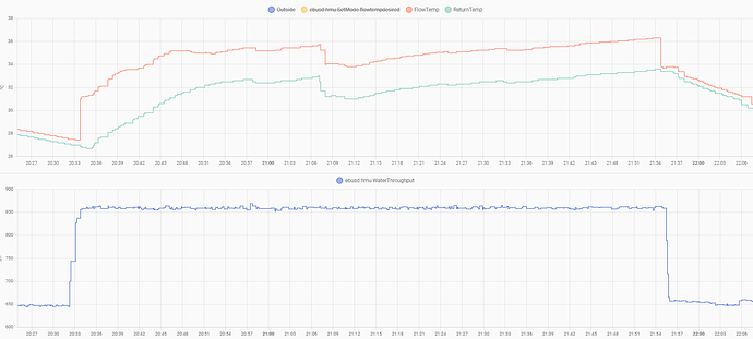

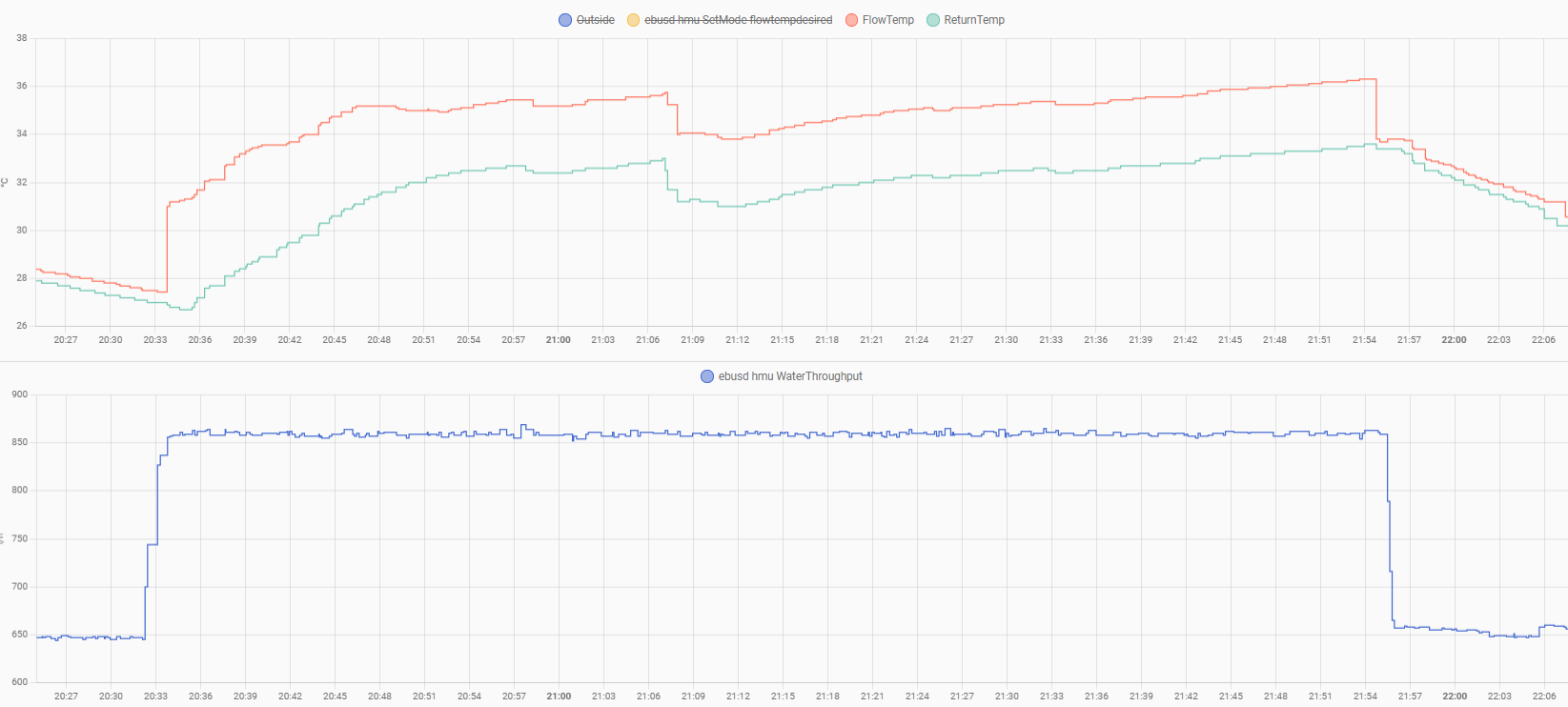

Following up on calculating heat power using flow rate and delta T (and putting aside the complexity of defrost for the moment). I was wondering what people thought about trying to account for the residual heat supplied as the water cools between cycles. I notice that it is common to zero this period, but although the compressor is not running, the water is still being circulated and some heat is being supplied as the water cools.

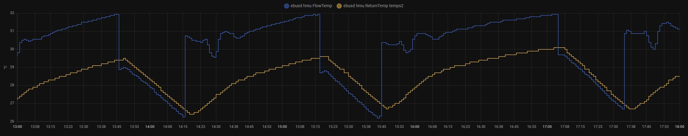

I am not 100% happy with this, but I did abs(delta T) as the Vaillant-measured Flow Temp drops below the return (presumably because when the compressor is not running it ends up cooling the water). My feeling is that there may be a more accurate way of doing this by considering the mass of water in the system and the temperature drops over time, but I am not sure.
I am not sure whether this will make a material difference, but I am curious :face_with_monocle:!
With circulation still running, my flow stays above my return. I somewhat think that they should be exactly equal, but they are 0.5 deg C apart.

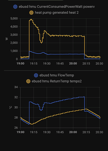

Welcome to the club, guys :sweat_smile: - that’s a common hardware issue with Vaillant and here’s how I fixed it (see also the previous posts in that thread).
Thanks. I saw the discussion on the Vaillant thread just after I posted! I will look into this. My calculations based on this negative delta T are clearly not going to be right.

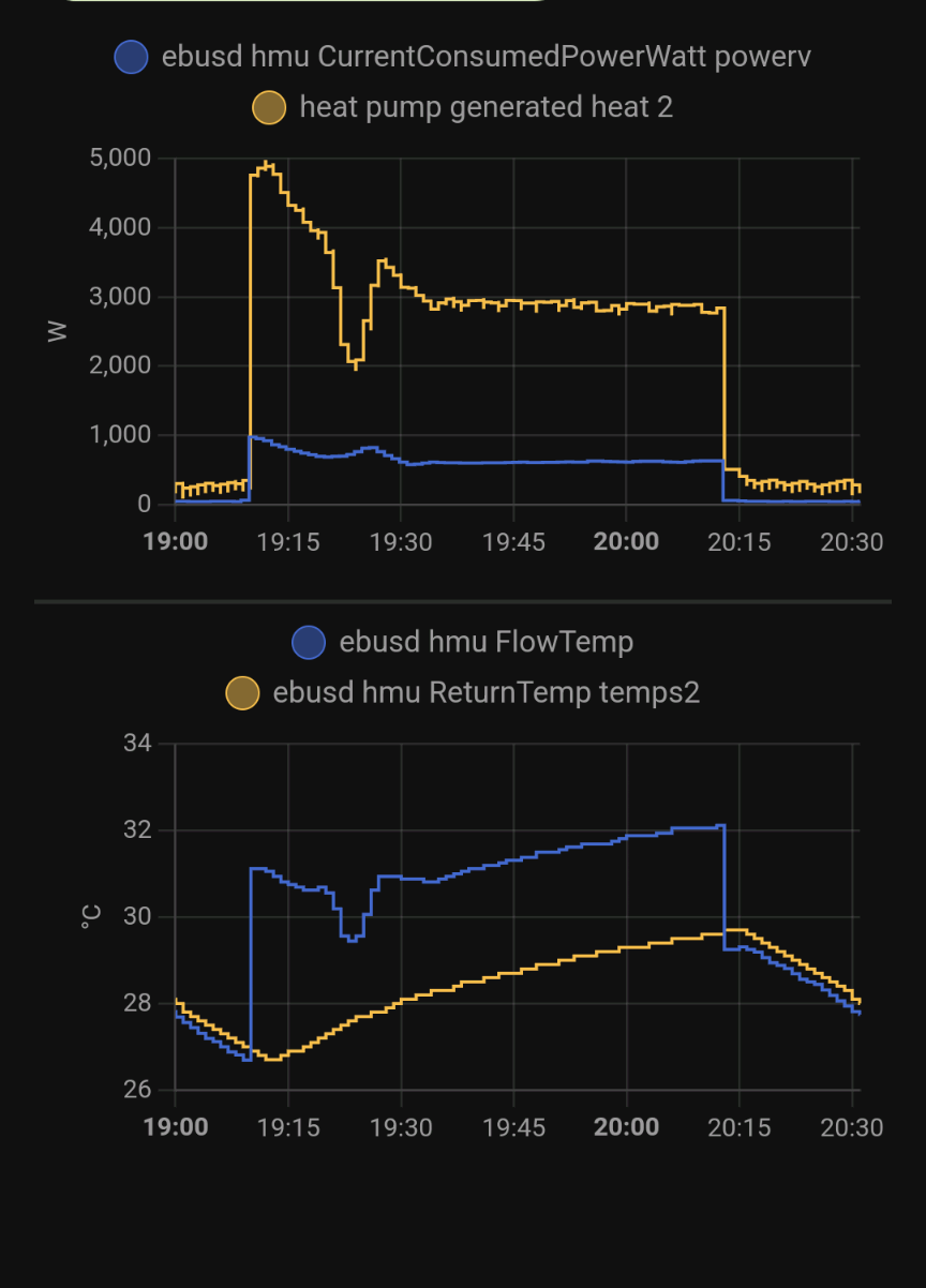

However, by my way of thinking, there is heat gain between cycles. Another way of thinking about it is that if there are 150 litres of water in the radiators and the heat drops by 3 degrees, that is about 0.5 kWh of heat released into the house during the time the compressor is switched off. Does that seem right or am I missing something?
Between cycles the heat goes from the water into the house, that’s true. But your heat meter does not register this as it can only see heat added or lost between its two temperature sensors. Unless your outdoor unit is connected by terribly insulated pipes, flow and return temperatures are going to be equal between cycles.
Yes, I realise that it could be difficult to measure this heat that is being transferred to the house, but I am wondering whether it could actually be worth accounting for in order to get accurate COP measurements.
By my rough calculations and referring to the chart I posted above, it seems there was about 3 kWh transferred during the heating cycle and 0.5 kWh transferred when the compressor is off, as the water is cooling. This seems big, so my first guess is that I am calculating wrong or not thinking about it correctly!
That heat was all measured. The heat meter measures heat going from the heat pump into the water. The heat being released between the cycles is heat going from the water into the house that was previously put into the water when the compressor is on.

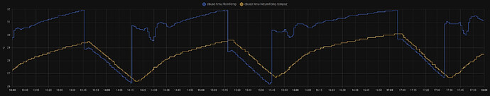

The easy fix is to have a Home Assistant template that triggers when the compressor was off for a couple of minutes but there ist still flow to compute the delta, storing it in an input number. Then you have a template sensor that gives you a corrected flow temperature based on the measured minus the delta. This gives you an approximately correct temperature with the offset being updated after every cycle (the offset drifts a bit with outdoor temperature, this is why you can’t just set it once).
That’s a nice solution to dynamically calibrate, based on knowledge that the offset is truly close to zero when the compressor is off. I am a bit more comfortable with software than hardware!

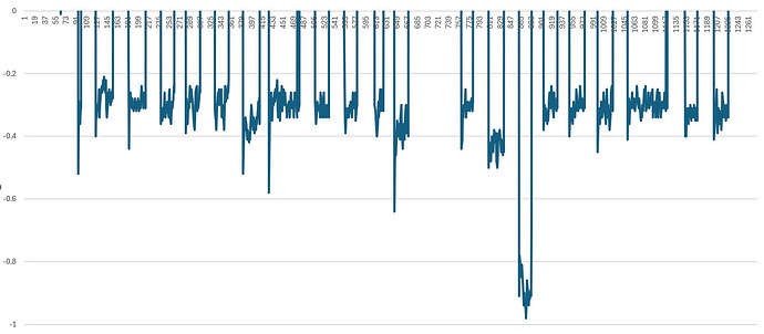

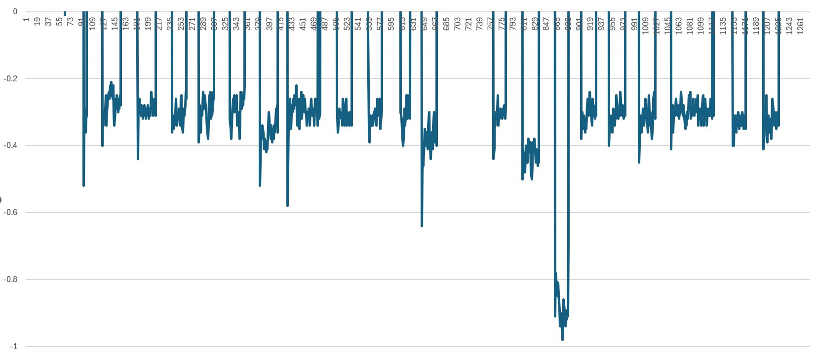

However, I just looked at three successive cycles when the outside temperature was stable at 11.5 celcius and I am now worried that there is something else going on causing instability :frowning: The deltas in the compressor-off phase are 0.4K, 0.94K and 0.32K. They seem to be consistent for each cycle, but that seems to be a bit change from one cycle to the next.
Can you post some graphs or do you have a publically accessible emincms instance?
Edit: Nevermind, I was too quick
That looks indeed weird and not how I know it from my system.
Was rhere any direct sunshine? Is this behavior replicated over longer periods?
There was no sun (I don’t think the sun has been out here in the last two weeks!!). I will monitor and see whether this was a blip and whether it is normally more stable. I was doing some reconfiguration, and so don’t currently have a lot of history.
EDIT: actually, using the limited history I have, I can see that the 0.94K was an outlier. No idea why, but other periods average around the -0.3K level.

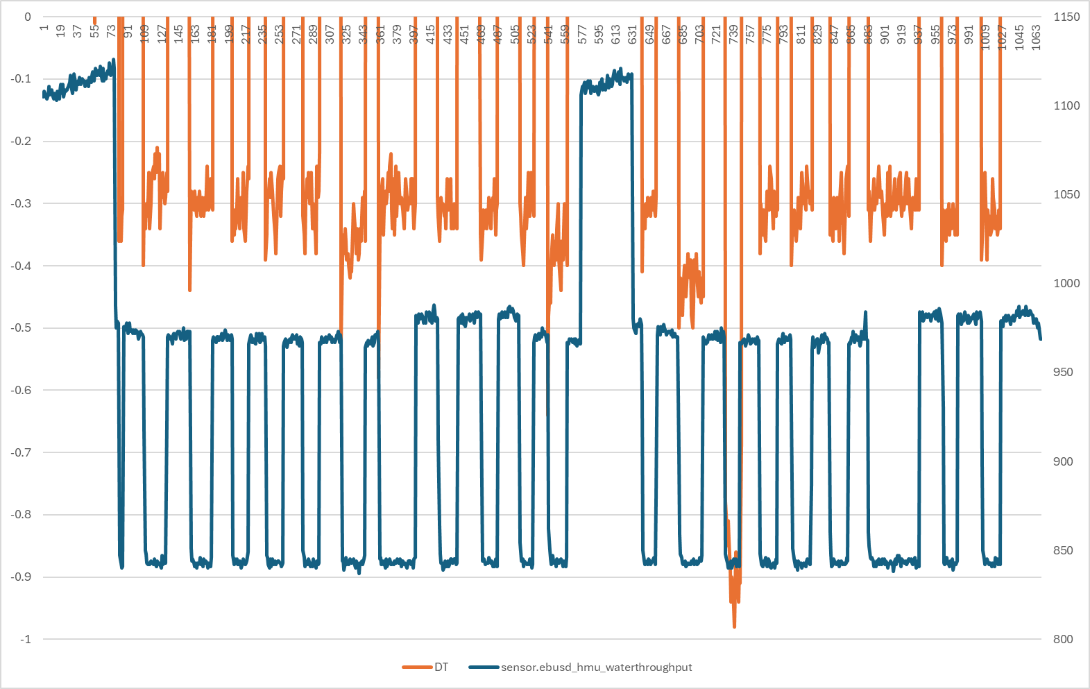

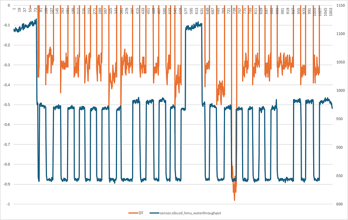

Can you plot the flow rate as well?
Here is the DT (left y-axis cropped so that I am just showing the negative values when the compressor is not running) and the flow-rate (right axis).
This is really weird and I have no idea what caused it. I guess the only thing to do is keep looking at it and see whether it happens again and if there are any discernable patterns.
