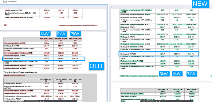

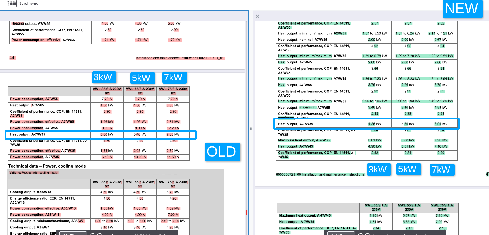

I’ve managed to get hold of the datasheets for the new V2 Vaillant Arothem+ I’ve been interested to see how the V2 compares to the existing Arotherm (V1).
As far as I can tell, the changes are very minimal. I think they’ve just tweaked the compressor current input and fitted a larger circ pump.
The main differance is the colour and the new R290 zero clearence feature which runs the fan 24/7 (if enabled).
The changes in heat output and rated COP could be due to changes in certification methods? I think the compressor current input is the most directly comparable metric to focus on. The output capacity chart for the V2 is not yet avilable, so we can only compare the EN test outputs COPs which are far from real world e.g Air -7C, Water 35C

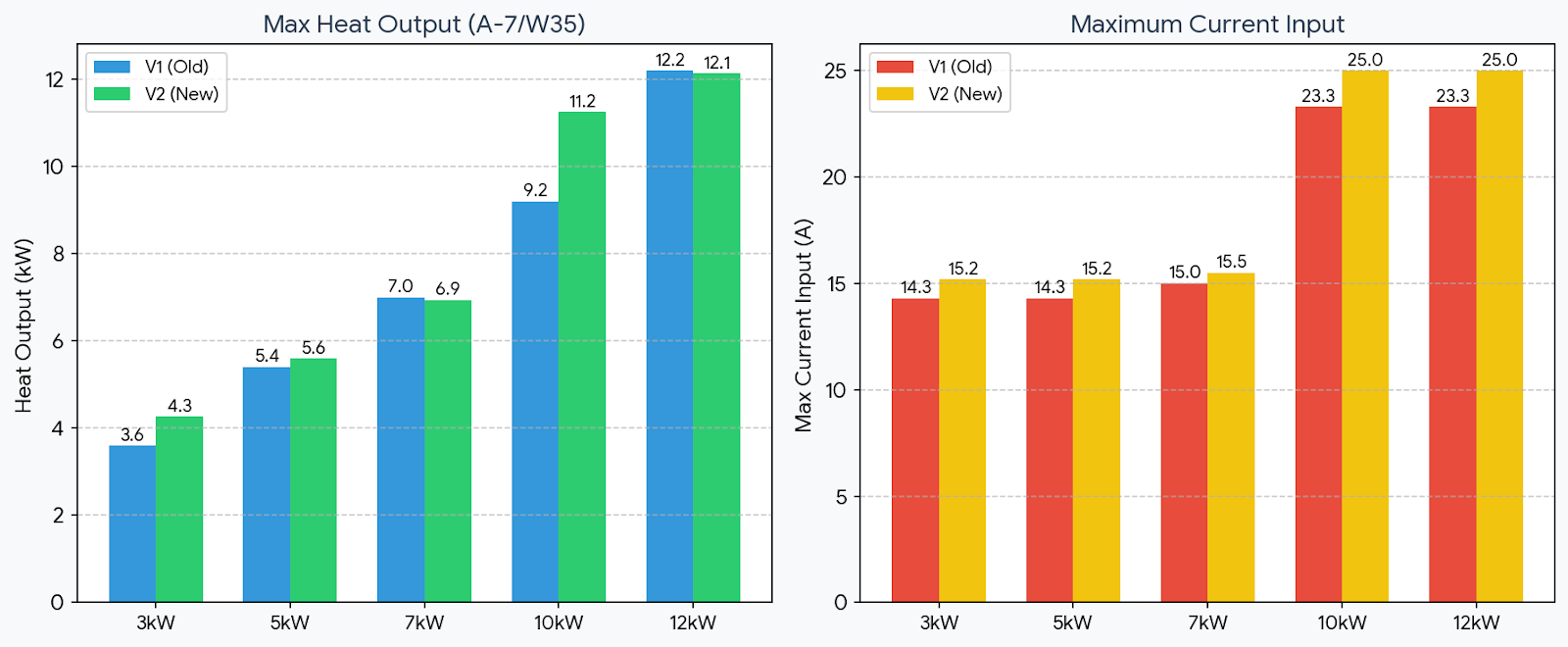

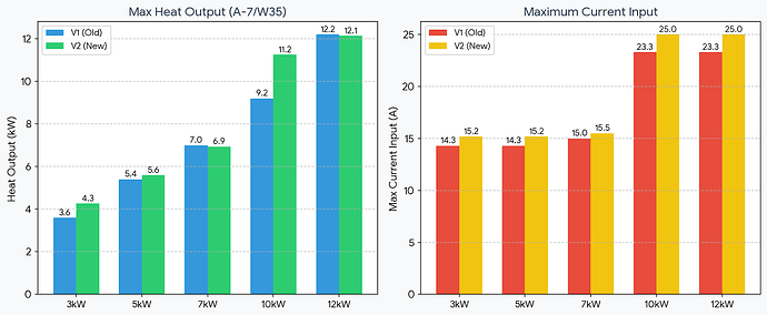

3kW Model
It’s well known that the 3kW model is identical to the 5kW model with a software de-rating on the compressor:

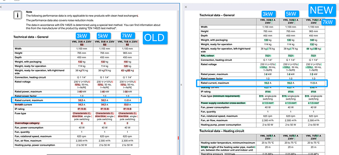

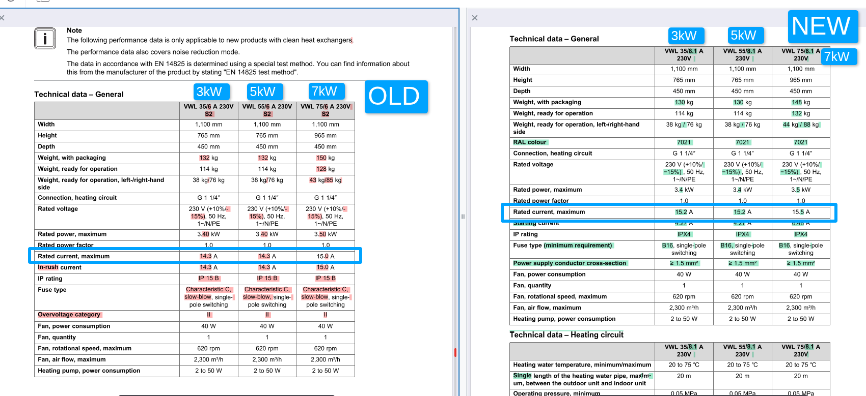

  • Max Heat Output: V1: 3.60 kW ➔ V2: 4.26 kW (+18.3%)
  • Max Current Input: V1: 14.3 A ➔ V2: 15.2 A (+6.3%)
  • Remaining Feed Pressure: V1: 56 kPa ➔ V2: 60 kPa (+6.7%)
  • Weight: No Change
  • R290 Charge: No Change
5kW Model
  • Max Heat Output: V1: 5.40 kW ➔ V2: 5.59 kW (+3.5%)
  • Weight: No Change
7kW Model
  • Max Heat Output: V1: 7.00 kW ➔ V2: 6.94 kW (-0.9%)
  • Max Current Input: V1: 15.0 A ➔ V2: 15.5 A (+3.3%)
  • Remaining Feed Pressure: V1: 44 kPa ➔ V2: 45 kPa (+2.2%)
  • Weight: V1: 128 kg ➔ V2: 132 kg (+3.0%)
10kW Model
  • Max Heat Output: V1: 9.20 kW ➔ V2: 11.25 kW (+22.3%)
  • Max Current Input: V1: 23.3 A ➔ V2: 25.0 A (+7.3%)
  • Remaining Feed Pressure: V1: 55 kPa ➔ V2: 55 kPa (0%)
  • Weight & R290: V1: 194 kg ➔ V2: 196 kg (+1.0%)
12kW Model
  • Max Heat Output: V1: 12.20 kW ➔ V2: 12.14 kW (-0.5%)
New 10kw may have less software output limiting.
