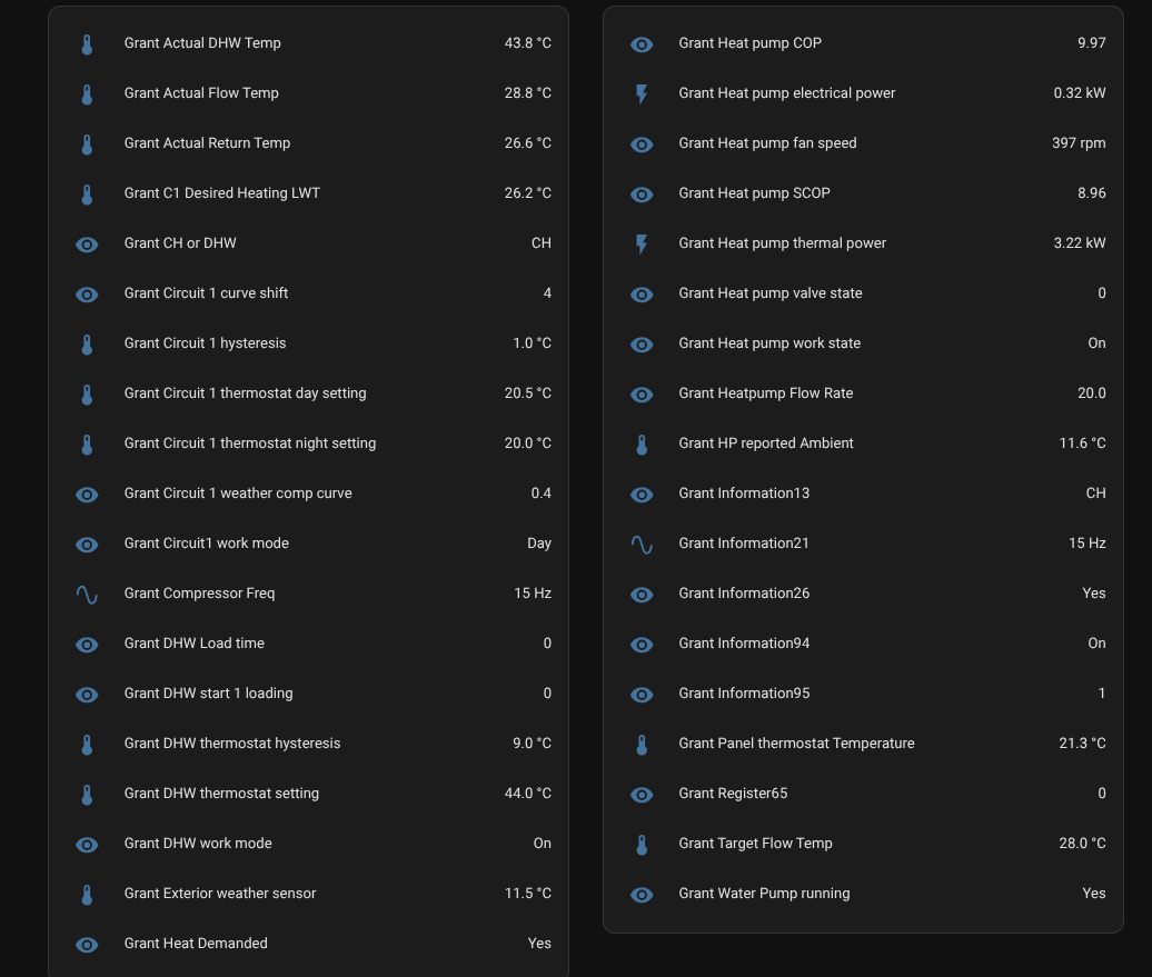

Reading onboard data from Grant Aerona HP290 + Control

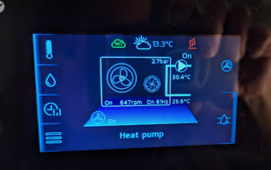

The Grant Aerona HP290 heat pump uses a Plum ecoMAX360i touch screen controller. It’s a good controller and works well.
The Grant HP290 must be the easiest heat pump to integrate with, no special cables or hardware is required, just local HTTP requests :smiley:
Grant use TP-Link hardware (EcoNet300) running custom firmware to post data to EcoNet24.com. EcoNet service allows every setting to be adjusted remotely and lots metrics from onboard sensors to be monitored with basic graphing. The Econet300 TP-link hardware has a local HTTP API which can be used to read data locally. Local control is also possible.

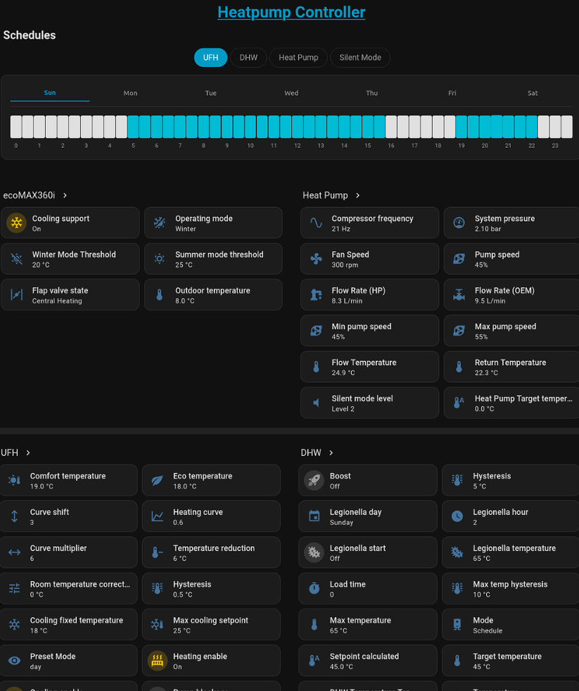

Currently, I’m aware of three Home Assistant integrations / methods which are able to do this, once the data is in Home Assistant it’s easy to use Emoncms History Integration to get the data into Emoncms for more advanced graphing:
1. EcoNET-300 HACS
Easy to setup, install via HACS. Supports many different Plum controllers. Only a limited number of metrics are supported on the Grant HP290.
2. Econet MQTT Publisher
by @MrW
Run using a docker container, doesn’t require Home Assistant. Publishes data to MQTT. Supports most more metrics from Grant HP290
Forum thread:

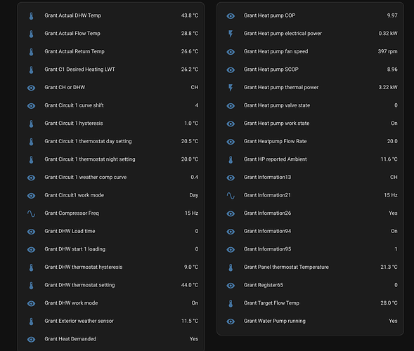

3. Home Assistant REST
by @GSV3MiaC
REST API calls from HomeAssistant, requires manual setup. Most complete set of metrics, this is what I’m currently using. See forum post.
# For Econet Grant Heatpump
- authentication: basic
  username: "admin"
  password: "admin"
  scan_interval: 30
  resource: http://192.168.86.31/econet/editParams
  sensor:
    - name: "Heat pump SCOP"
      unique_id: 'f541d4d5-b12a-4c2b-9566-d284d75d5c7e'
      value_template: "{{ value_json['informationParams']['222'][1][0]
      [0] }}"
      state_class: measurement
    - name: "Circuit 1 thermostat day setting"
      unique_id: '38edd4cd-32d9-45c3-bc97-af814b29fbc5'
      value_template: "{{ value_json['data']['238']['value'] }}"
      unit_of_measurement: "°C"
      device_class: temperature
    - name: "Circuit 1 thermostat night setting"
      unique_id: 'da60f424-fc3c-49d4-9320-3eb5076c2b81'
      value_template: "{{ value_json['data']['239']['value'] }}"
    - name: "Circuit 1 hysteresis"
      unique_id: 'circuit1 hysteresis'
      value_template: "{{ value_json['data']['240']['value'] }}"
    - name: "Circuit 1 weather comp curve"
      unique_id: 'c1 weather curve'
      value_template: "{{ value_json['data']['273']['value'] }}"
    - name: "Circuit 1 curve shift"
      unique_id: 'circuit1 curve shift'
      value_template: "{{ value_json['data']['275']['value'] }}"
    - name: "DHW thermostat setting"
      unique_id: '458520e1-7dd6-42a6-83d0-40aa736ffc60'
      value_template: "{{ value_json['data']['103']['value'] }}"
    - name: "DHW thermostat hysteresis"
      unique_id: 'dhw hysteresis'
      value_template: "{{ value_json['data']['104']['value'] }}"

    - name: "Target Flow Temp"
      unique_id: 'targetflowtemp'
      value_template: "{{ value_json['informationParams']['12'][1][0][0]}}"
# Circuit 1 calculated flow temp
    - name: "C1 Desired Heating LWT"
      unique_id: 'c1flow'
      value_template: "{{ value_json['informationParams']['93'][1][0][0]}}"
# Water pump is info 11
    - name: "Water Pump running"
      unique_id: 'pump_running'
      value_template: "{% set s = value_json['informationParams']['11'][1][0][0] %} {% if s == '2' %} {{'No'}} {% elif s=='0' %} {{'Yes'}} {% else %} {{s}} {% endif %}"
# Heating demanded?
    - name: "Heat Demanded"
      unique_id: 'heatdemanded'
      value_template: "{%set s= value_json['informationParams']['26'][1][0][0] %} {% if s == '1' %} {{'No'}} {% elif s == '0' %} {{'Yes'}} {% else %} {{s}} {% endif %}"
    - name: "Information26"
      unique_id: 'information26'
#      value_template: "{{ value_json['informationParams']['26'][1][0][0]}}"
# duplicate of 094 - CH valve state?
    - name: "CH or DHW"
      unique_id: 'chordhw'
      value_template: "{%set s= value_json['informationParams']['13'][1][0][0] %} {% if s == '1' %} {{'CH'}} {% elif s== '0' %} {{'HW'}} {% else %} {{s}} {% endif %}"
    - name: "Information13"
      unique_id: 'information13'
# the following is also apparently under parameter 24,72 and 81 !!
    - name: "Actual Flow Temp"
      unique_id: 'actualflowtemp'
      value_template: "{{ value_json['informationParams']['14'][1][0][0]}}"
# the following is also apparently under parameter 25, and 91 !!
    - name: "Actual Return Temp"
      unique_id: 'actualreturntemp'
      value_template: "{{ value_json['informationParams']['15'][1][0][0]}}"
#      water pump runtime hrs, since last power cycle
#    - name: "Information201202"
#      unique_id: 'information201202'
#      value_template: "{{ value_json['informationParams']['201'][1][0][0]}}"
#    - name: "Information2032042"
#      unique_id: 'information203204'
#      value_template: "{{ value_json['informationParams']['203'][1][0][0]}}"
#    - name: "Heating Energy"
#      unique_id: 'information203'
#      value_template: "{{ value_json['informationParams']['203'][1][0][0] | float / 1000}}"
#      unit_of_measurement: "kWh"
#      device_class: energy
#      state_class: measurement
#    - name: "DHW Heating Energy"
#      unique_id: 'information204'
#      value_template: "{{ value_json['informationParams']['204'][1][0][0] | float / 1000}}"
# compressor Hz?
    - name: "Compressor Freq"
      unique_id: 'compressor freq'
      value_template: "{{ value_json['informationParams']['21'][1][0][0]}}"
      unit_of_measurement: "Hz"
      device_class: frequency
    - name: "Information21"
      unique_id: 'information21'
    - name: "Actual DHW Temp"
      unique_id: 'actualdhwtemp'
      value_template: "{{ value_json['informationParams']['61'][1][0][0]}}"
# CH Valve State?
    - name: "Information94"
      unique_id: 'information94'
      value_template: "{{ value_json['informationParams']['94'][1][0][0]}}"
    - name: "Information95"
      unique_id: 'information95'
      value_template: "{{ value_json['informationParams']['95'][1][0][0]}}"
    - name: "HP reported Ambient"
      unique_id: 'hpambienttemp'
      value_template: "{{ value_json['informationParams']['23'][1][0][0]}}"
    - name: "DHW Load time"
      unique_id: 'dhw load time'
      value_template: "{{ value_json['data']['113']['value'] }}"
    - name: "DHW start 1 loading"
      unique_id: 'dhw start load'
      value_template: "{{ value_json['data']['115']['value'] }}"
    - name: "DHW work mode"
      unique_id: 'dhw work mode'
      value_template: "{% set s= value_json['data']['119']['value'] %} {% if s==2 %} {{'Scheduled'}} {% elif s==1 %}  {{'On'}} {% elif s==0 %} {{'Off'}} {% else %} {{s}} {% endif %}"
    - name: "Circuit1 work mode"
      unique_id: 'c1 work mode'
      value_template: "{% set s= value_json['data']['236']['value'] %}  {% if s==3 %} {{'Scheduled'}} {% elif s==1 %} {{'Day'}} {% elif s==2 %} {{'Night'}} {% elif s==0 %} {{'Off'}} {% else %} {{s}} {% endif %}"

:police_car_light: Onboard metrics are very interesting, the sensors are not very accurate. COP and heat delivered figures should be ignored. The Grant COP figures are often double the actual COP :face_with_peeking_eye:
HA REST is working really well for me. Any speculation on Register65 and the information ones? some like 13 and 21 look like duplicates of CH or DHW and Compressor Freq.
Register 65 is always 0 for me.
Information 13 is either CH or DHW
Information 21 is duplicate of compressor freq
Information 26 is always Yes for me.
Information 94 is “On” during CH and “Off” during DHW
Information 95 is always 1 for me.

I’ve been working on integrating some sensors, numbers and selects for ecomax360i controller to the econet300 hacs integration: https://github.com/LeeNuss/ecoNET-300-Home-Assistant-Integration/tree/feature/sensors-inputs-ecomax360i
Controls are still bit clunky and needs thorougher testing, but the basics work. Happy to extend the available entities if anyone wants to use the integration
Ah cool, nice work. What’s the easiest way to test this via HACS?
you should be able to install it via hacs by adding https://github.com/LeeNuss/ecoNET-300-Home-Assistant-Integration as custom repo, make sure to remove jontofront’s original integration. Then download tag 1.2.0-a-ecomax360-1 (click “Need a different version”), restart & add device as usual with econet300 integration. hope that works, I currently can’t verify installing it via the hacs
Ok great, are you going to try and get jontofront’ to merge these changes into his main repo?
yeah that’s definitely the plan, but it might take a while to get that merged. The different api endpoint and his recent changes means there’s a decent amount of refactoring to do. I’ll keep working on supporting more functionality of the controller so it’s at least usable from my fork until merged.

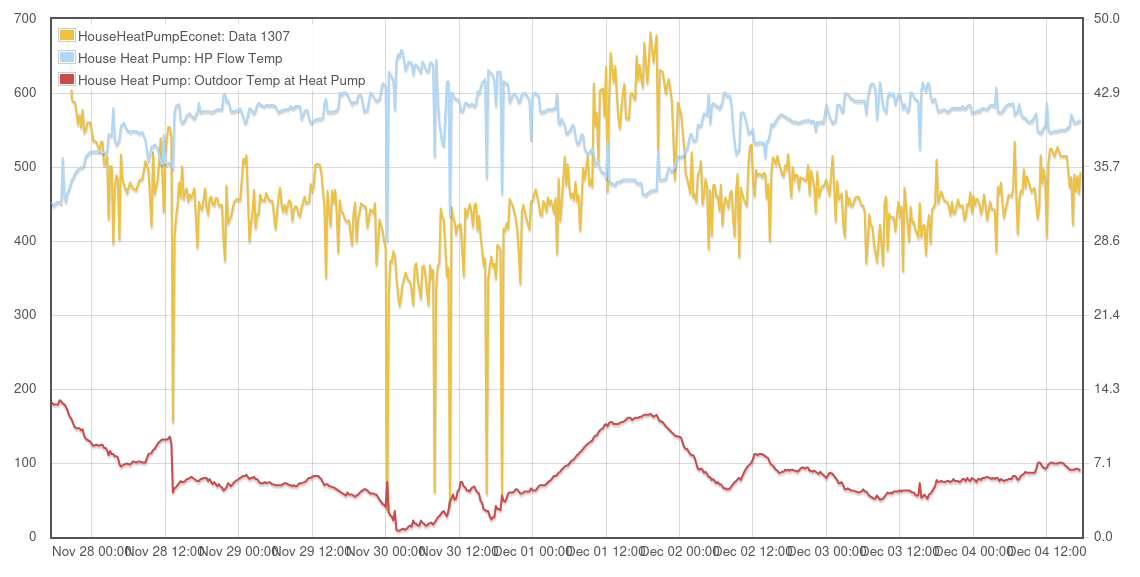

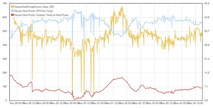

I’ve finally gotten a bit of time to improve my emonhub interfacer. I’m working through some of the presently unidentified values in the REST endpoint and have identified a couple more.
1307 from the “data” data structure looks potentially interesting, for my install it ranges between 50 and 680, is roughly proportional to OAT and so roughly indirectly proportional to flow temp. Just wondered if anyone had any idea what it could be?

the 1307 parameter is labelled as AXEN_REGISTER_1238, so unfortunately not particularly revealing what this represents
