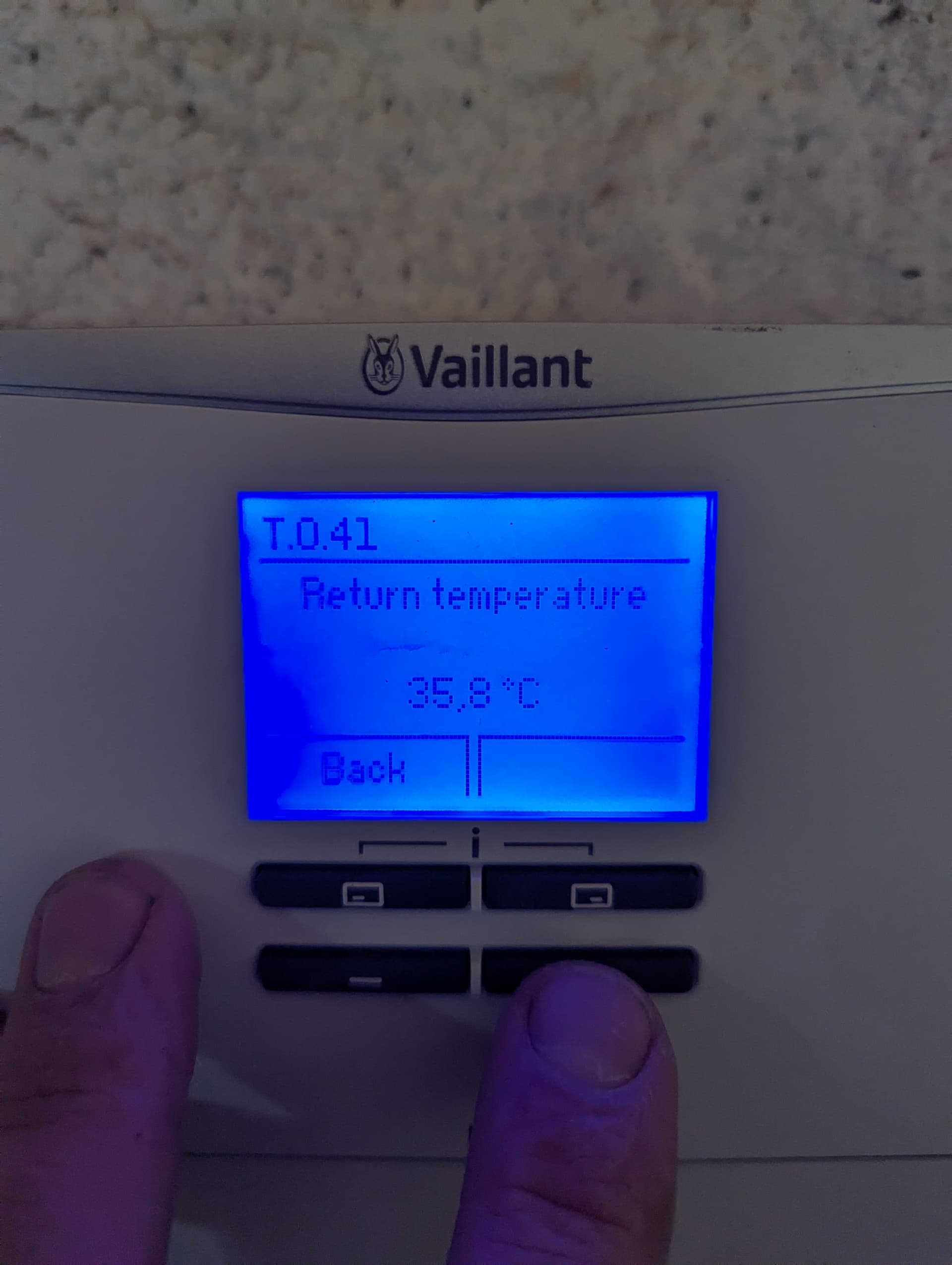

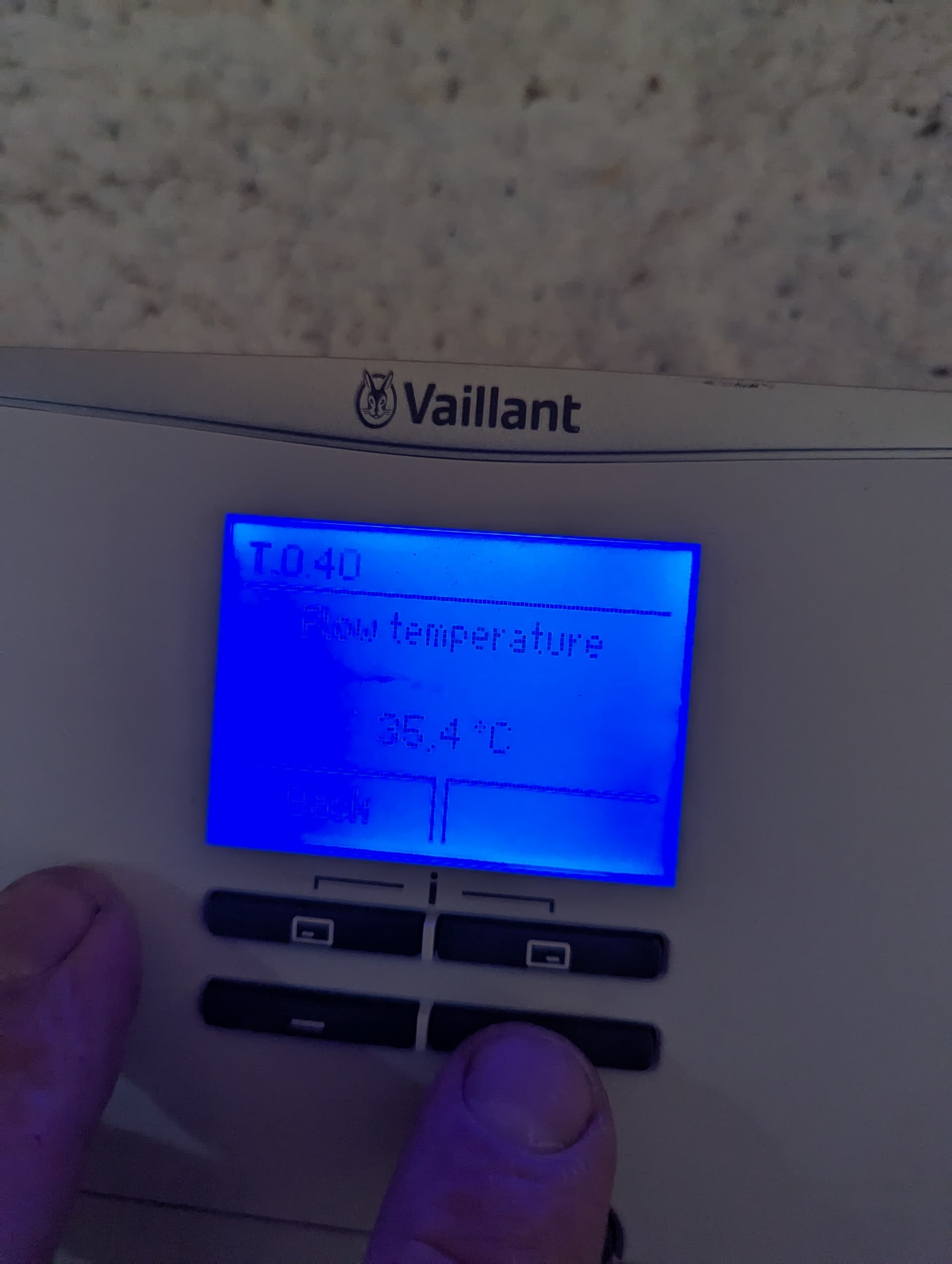

Odly before my PCB was replaced I had sensible COP and temps read the same. Now return is reading above flow. This was on idle pump between cycles. Also my COP is impossibly low for the power used / property heat loss.
I’m not sure if return temp is used for anything (don’t think so) but will ask them to look at it all the same.

Strange that the same sensors now have a disparity… maybe the engineer(s) who replaced the PCB disrupted/dislodged something inside the unit?

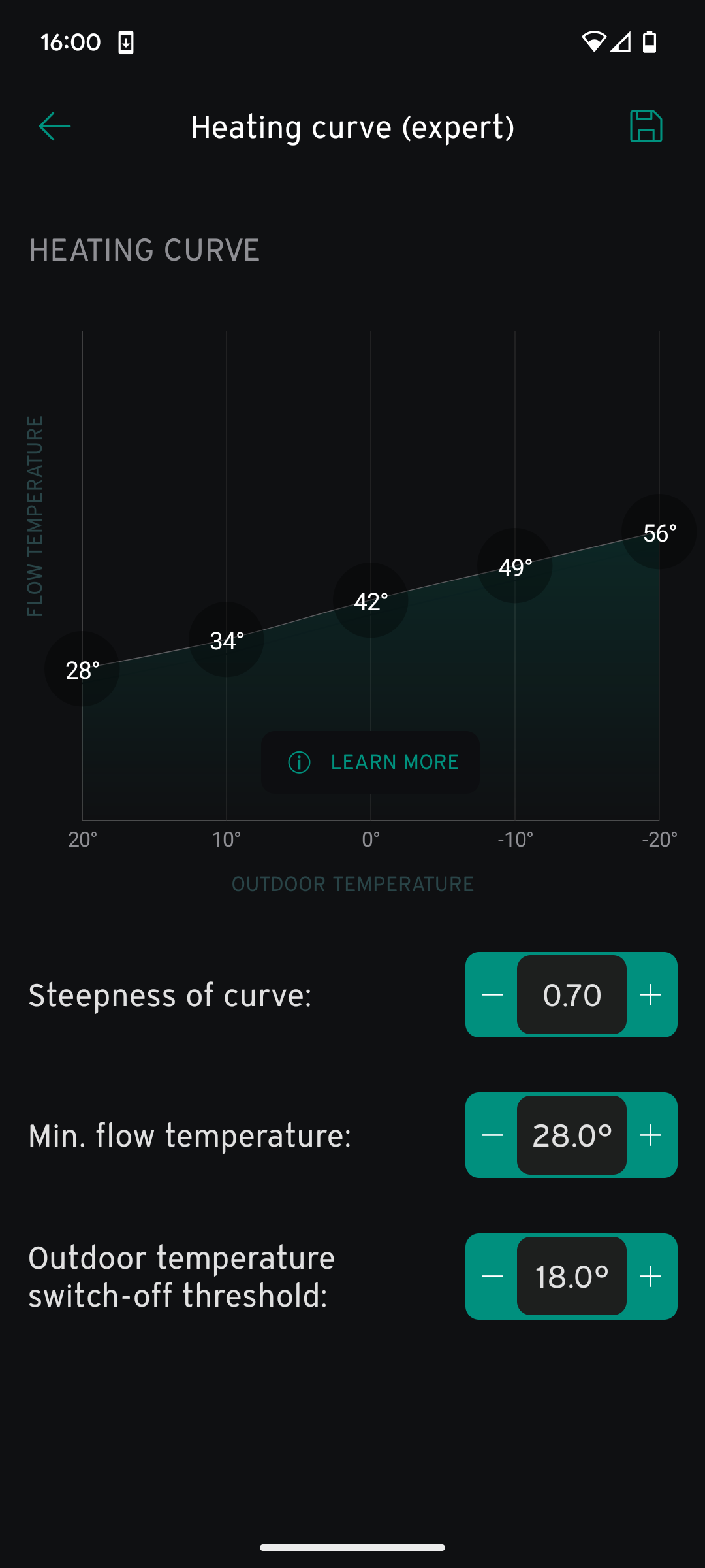

Due to cycling, the house is under heated at mild temperatures ~11C when no solar gain is present. I wish there was an option that changed the algorithm to stop it turning off due to energy integral if internal temperature < desired temperature. We are only talking .3 C under desired but it makes a difference to feel in the house. I did bump up desires temp the other day and that helped a bit but not perfect. I’m runnin active weather comp.

This is not due to cycling but an improperly set weather compensation curve. Try increasing the minimum flow temperature by a degree. This will not impact anything when the weather is colder but just operation when the flow temperature would be below the min temperature.
You think?
My min flow temp is 28C already. I guess I can take it up a bit and see. I can see how it would put a bit more heat into the house as it’ll heat more when on, and come back on faster.
It’s a shame you can adjust the curve with a bit more refined detail.
Hm OK, so at 10°C out you’re already at 34°C flow, so this might now help without affecting the general heating performance of the system. You’d only see a difference now if min was set above 34°C which seems excessive.
