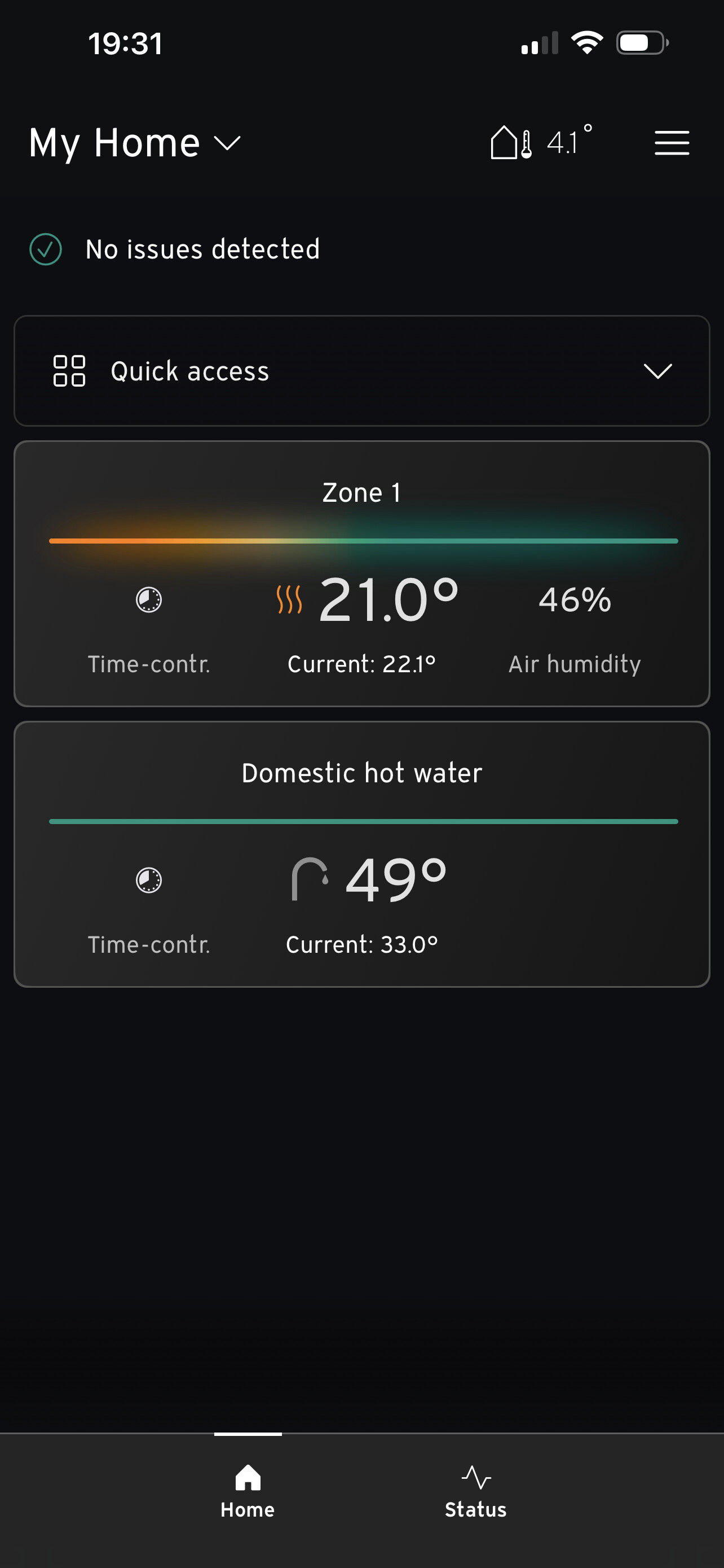

My myvaillantapp, has done something weird today. It’s showing my data from before my internal PCB was changed and the serial number changed. It’s also showing incorrect current power use figures. Logging out and in hasn’t fixed it, very weird.
I always get nervous when stuff like this happens, that I am going to get electrical issue again with it and the machine stop working.
The vaillantconnet box has a blue light, I hard reset this but it went solid blue again, but the data shown in app is incorrect. Really vaillant software in unacceptably shit for the cost. I’ve unplugged it for now, thankfully the heatpump is working fine.

My myVaillant app has now stopped showing the middle lower tab, Energy.
I would suggest it’s a backhaul issue. Fingers crossed.
Daz
Hi.
Just to follow up, the app has now returned to normal. Energy data is all correct. So I presume a backhaul issue. @JamesH I hope your issue has resolved.
Daz :+1:t2:
Thanks. I just went and plugged it back in and it’s working now. Anxiety over.
