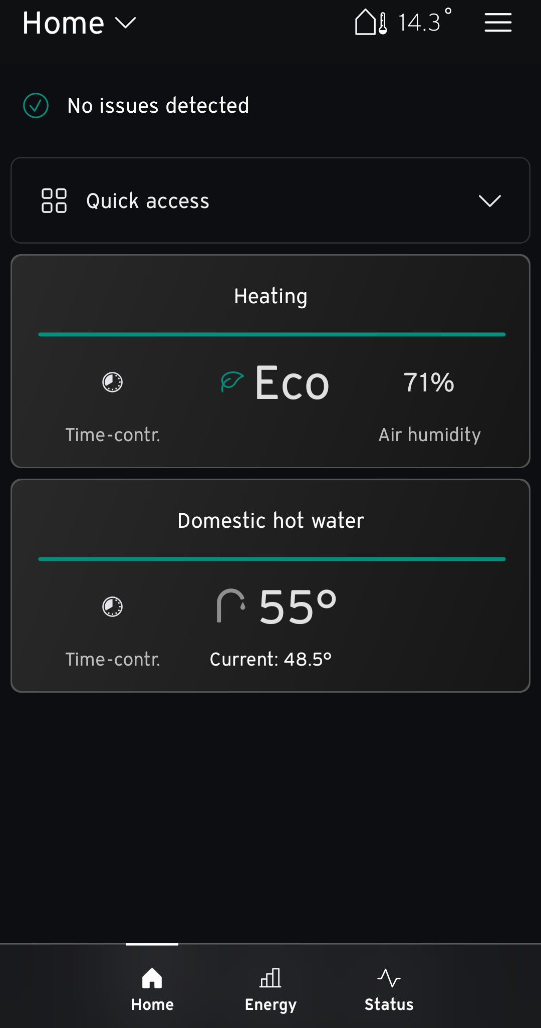

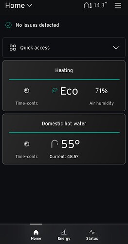

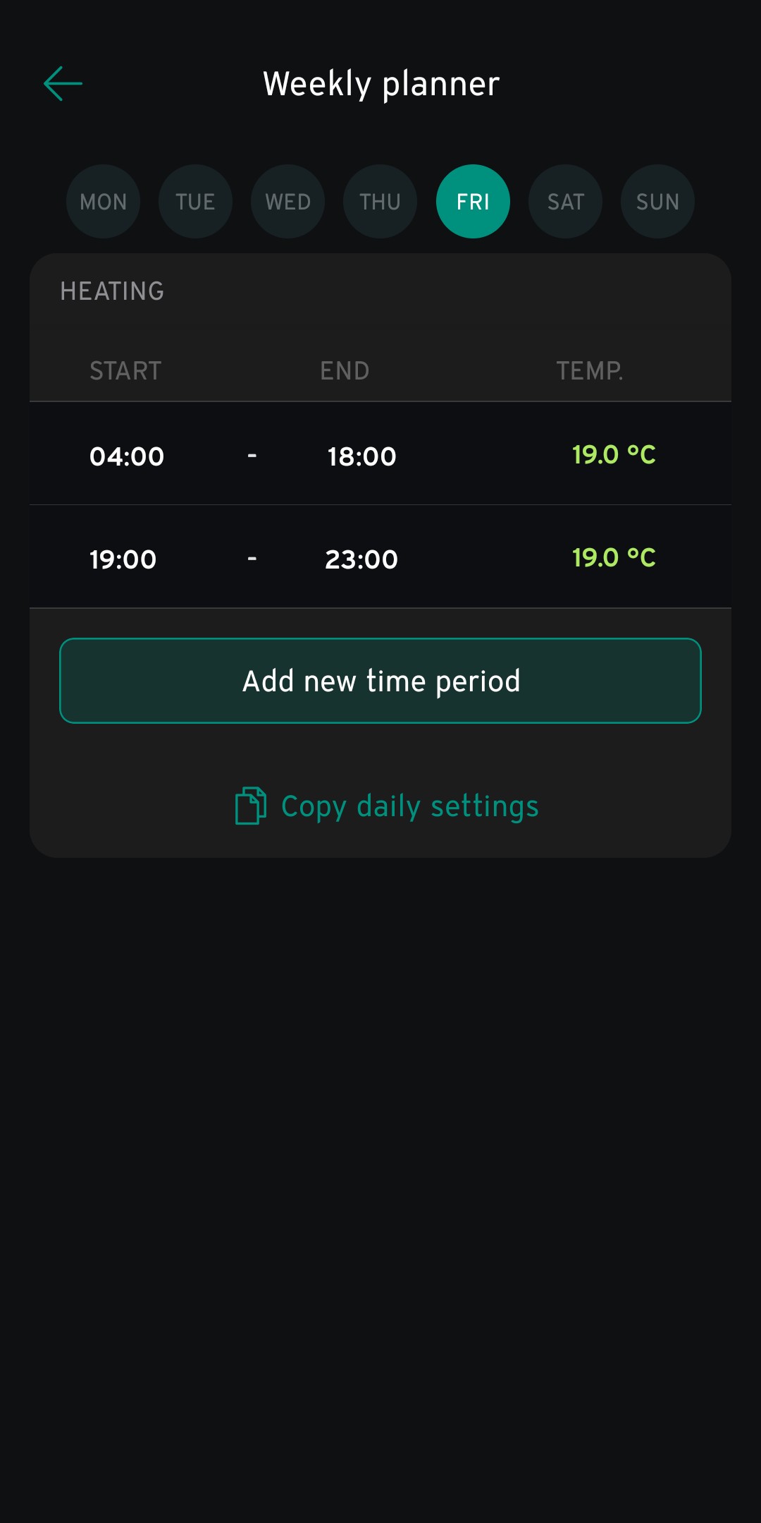

Hi folks,
Any ideas why my Arotherm/Sensocomfort is refusing to come out of “Eco” this morning? I’d like the house to be 19°, not 18°.
It’s almost like it’s stuck at the setback temperature; if I manually set a higher temperature, say 21°, the app shows “heating” for a few seconds then reverts to “Eco”.
I’d turned on “absent mode” for a couple of days until yesterday. I’m guessing that’s caused this problem somehow.

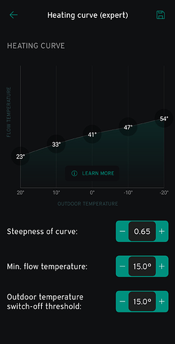

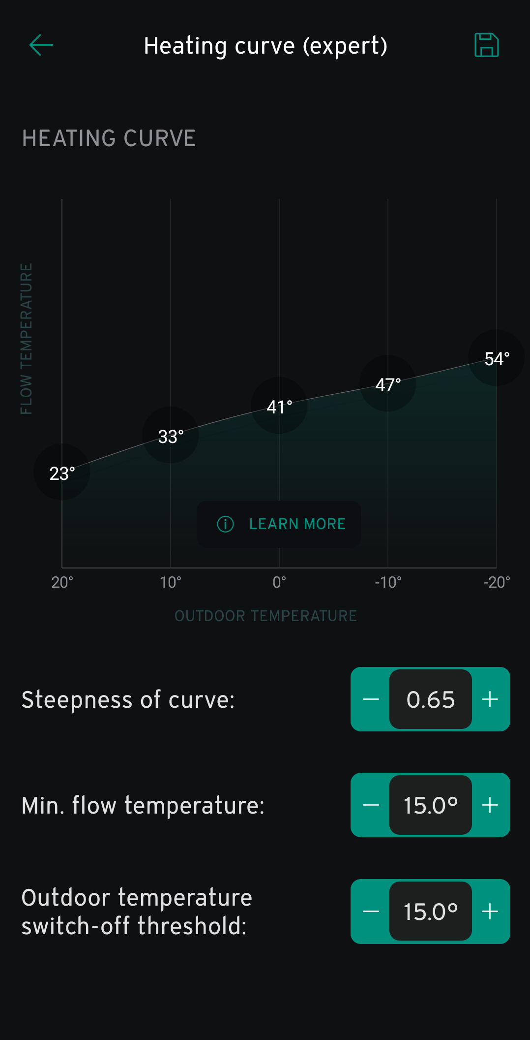

Your OT switch off is 15C.
The system will not restart until it the outside reaches 13.9C . There is 1C hysteresis.
