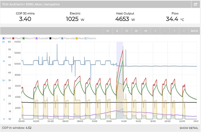

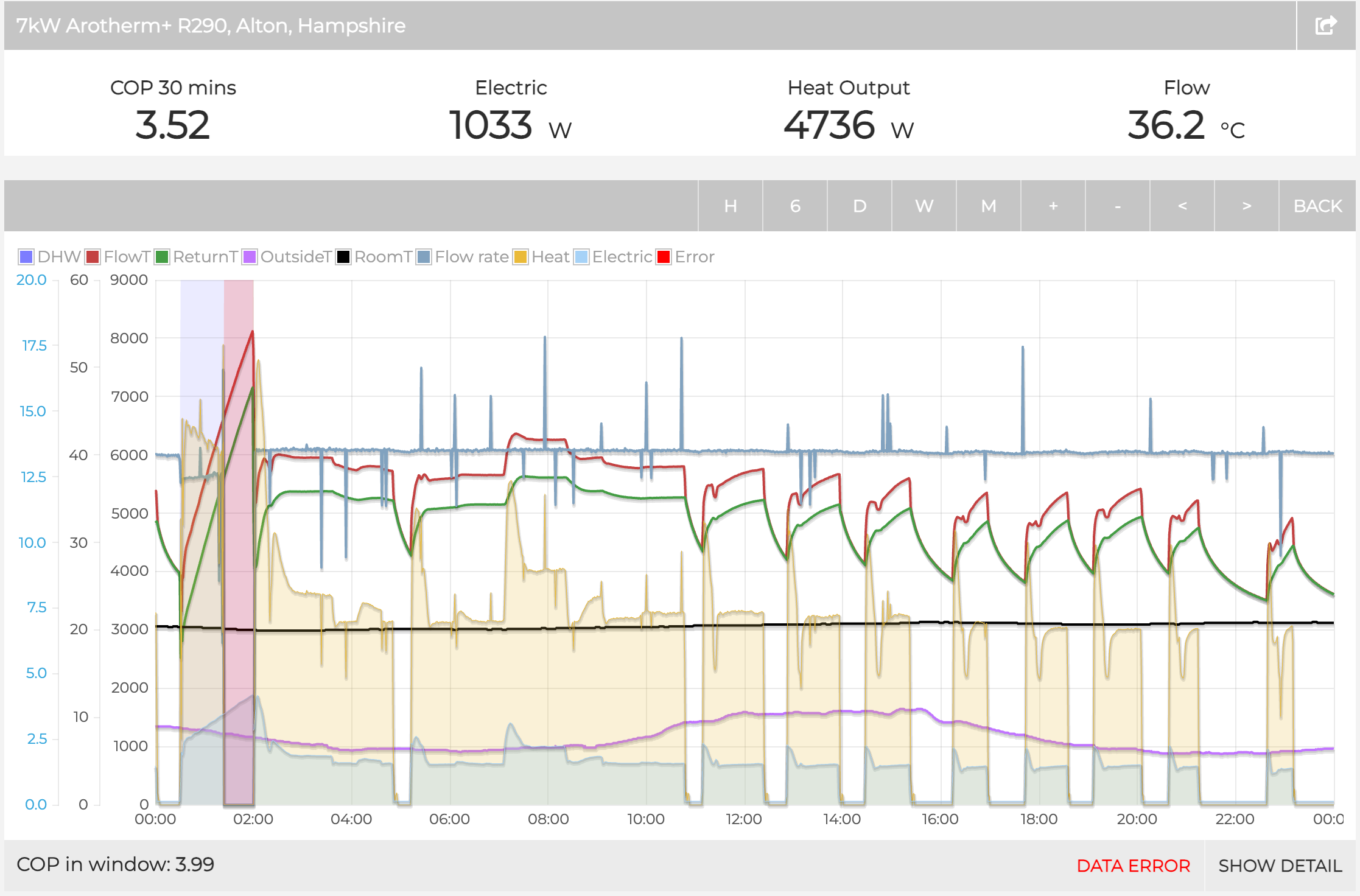

My installer came back to fix the pH balance on the water, and I noticed the flow rate changed from a sawtooth to a flat flow rate. Looking at other HPs they have a sawtooth as well. I use Havenwise to optimise the heat pump, but given the timing, I don’t think that has changed. The house is nice and warm, but is it something I should be worried about? The second picture is yesterday, where I have an air in the system problem. There are also these spike up and down on the flow.

In both active and inactive, the flow rate should drop in the off cycles. ie, i lower % than when heating within a cycle.
Havenwise has no control of flow rate or pump speed.

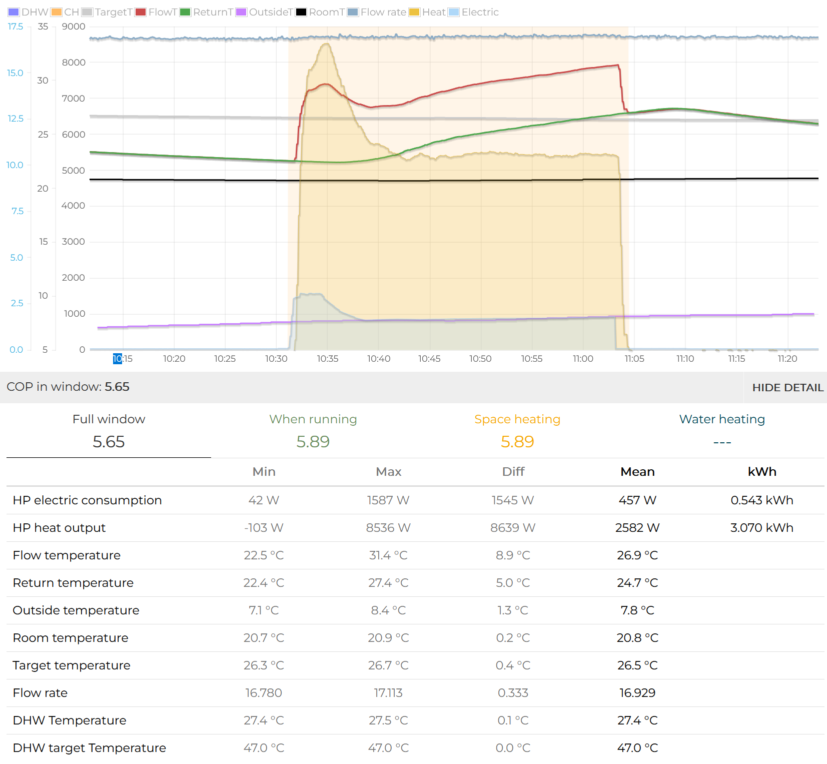

this is my yesterday with Havenwise
Unless you have turned your flow rate to the absolute minimum via reducing the max. rem head setting to squeeze the last percent of performance out of your oversized heat pump as I described here. In this case, flow rate stays flat all the time. This is with Max. rem. head set to 350 mbar for me, which is barely above the stalling limit.

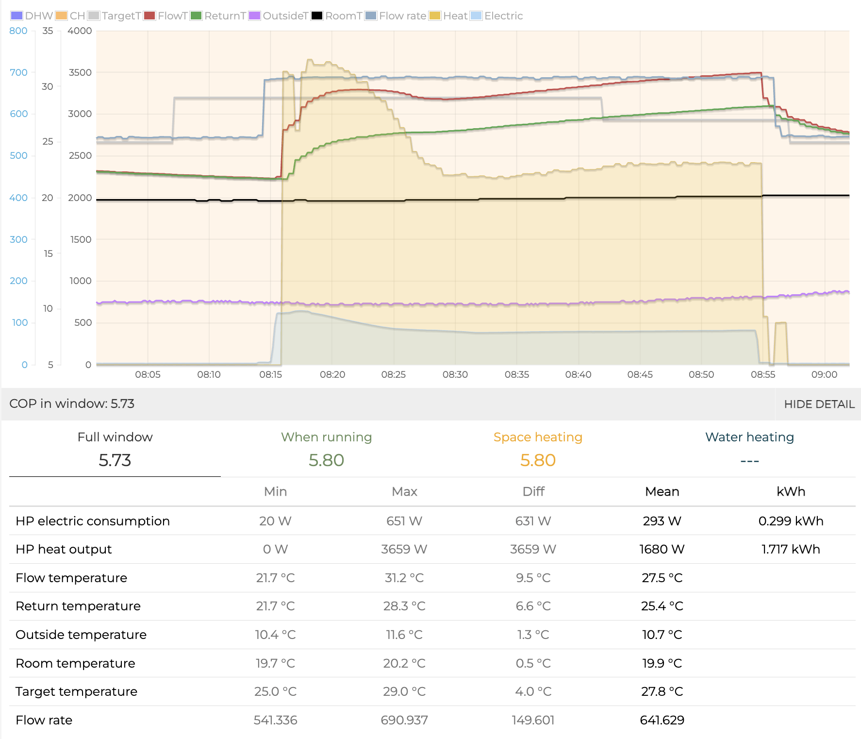

The heating pump on my 5kW is set to auto, so it defaults to 860 L/h
My heat pump spends a lot of the shoulder months at minimum output (2.2kW), so is always around DT2.2 ish when running 860 L/h.
But my heat loss is only around 3.6kW at -3C, so really I don’t need 860 L/h.
It would be more like 618 L/h
618 L/h (0.171 L/s x 4.2 x DT5) = 3.591 kW
So I’ve initially set my heating pump to 60% which gave me 686 L/h
Now I know that the vaillant doesn’t seem to care most of the time, it just gets on with the heating cycle, even at DT2.
But i’m thinking it’s surely better to run at a wider DT where possible?
In this example, DT is around 3, so perhaps better?
I might go and drop the pump a little more to get closer to 618 (the minimum is 50%).
And because it’s rarely -3C outside, I bet 50% could work well too.
I suppose the bigger question……. is this more efficient? running a wider DT at minimum outputs?
anyone done any trials?
I think this is exactly what I investigated in my post here, just from a different viewpoint. And yes, this can definitely be better, depending on pump power requirements and actual heat loss. Your approach of adapting flow rate to the actual heating load is definitely optimal - basically if you enter different load wattages into the spreadsheet in the linked post, you’ll get your optimal flow rate for all scenarios.
I am running my oversized 10 kW pump at minimum flow rate (1000 //h) for precisely that reason: I save 50W in pump power and didn’t even have to raise flow temperature because the required increase was so small it’s negligible.

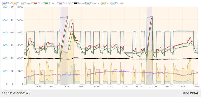

Hi, this is interesting and I’ve been looking into the hard ‘ramping on’ of the HP when it cycles back on, as to me it seems to promote overshooting and thus starting the count up of the energy integral. If it was smarter and ramped on slower then the cycles would be lengthened, or even stopped. Did you get an understanding if there is a way to prevent it going hard to meet the desired flow temp?
No way around it, this is just a quirk of how the Vaillant systems behave.
