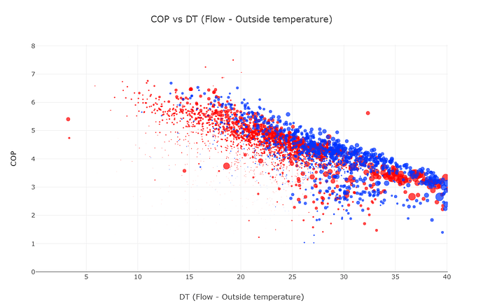

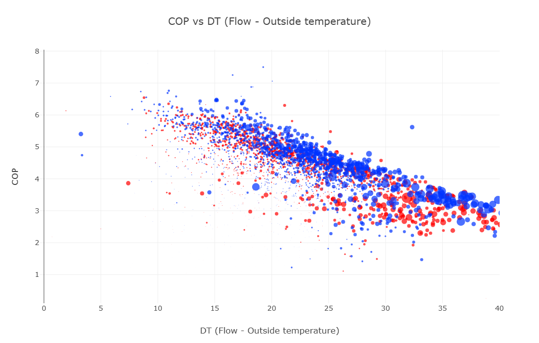

Using the excellent “Compare” tool over at heatpumpmonitor.org, let’s have a look at how my heat pump performed. First, a comparison between the heating period Feb 7 2024 - Apr 30 2024 (Red) and Sep. 1st 2024 - Jan 4 2025 (blue) to see whether anything else changed over the summer. It doesn’t look like it:

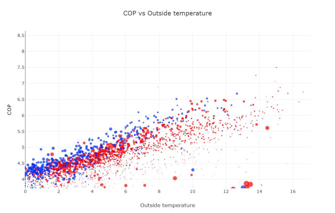

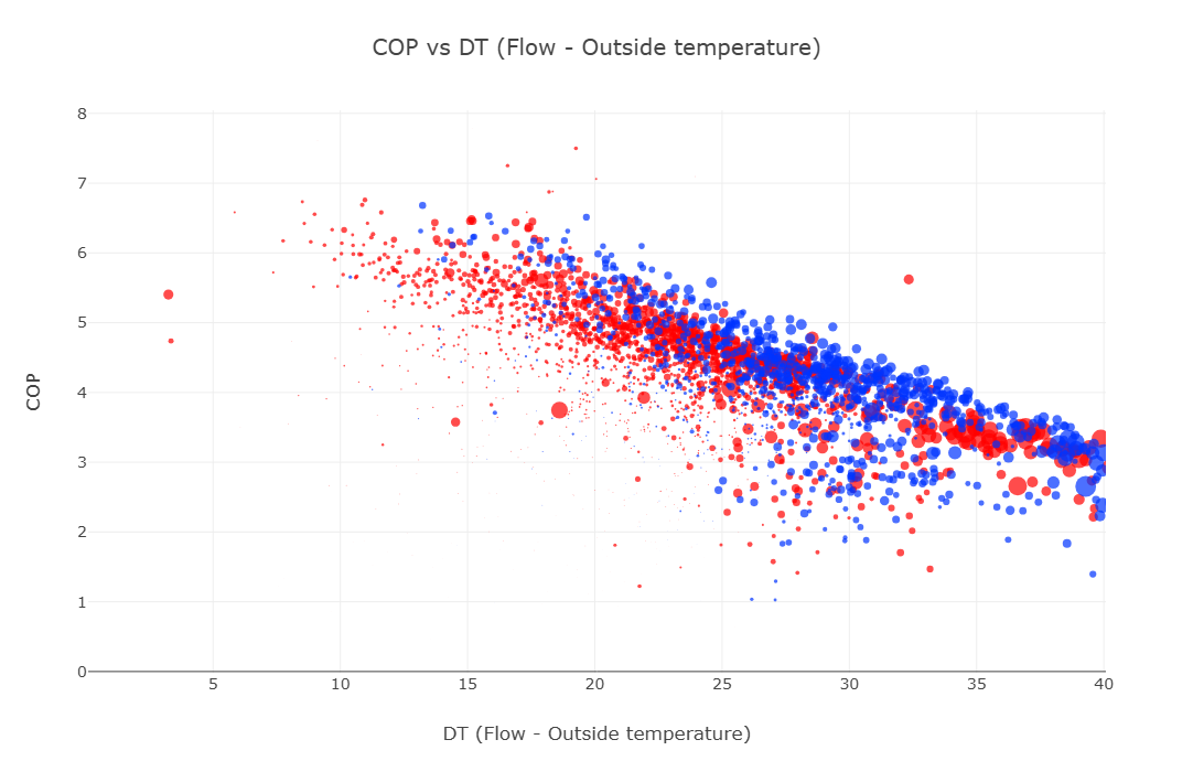

Now, let’s compare Sep 1 - Jan 4 2025 to Jan 5 - Feb 26 - because I switched my flow rate to the lower target on Jan 5th.
There is a small but clearly discernible COP improvement visible. We can also see this in COP vs. outdoor temperature:
I’ll rerunthis at the end of the season when I have even more data, but I think it’s already quite visible. Not a huge effect by any means but still better than nothing.
