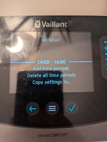

DHW.

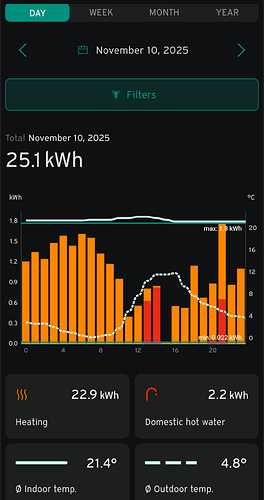

Does a defrost show as DHW? I’m confused as my DHW is time constraint 1400-1600. However when looking at the app this morning I see it generated ‘dhw’ late last night - I doubt it did as the DHW tank temp is not high enough to reflect this.
Edit: it did add heat to the DHW tank as it’s 31.5C. I forgot my wife had a bath at around 8pm. It didn’t do a full cycle though as target is 53C and it’s at 31C and mains water is 12C here. But there should be no mechanism open by which it could have called for DHW at this time of day - is anyone aware of a setting which might have allowed it?
Anyone seen this?
Defrosts don’t show up at all in the Vaillant App, so that can’t be it. Are you sure your schedule is correctly set up for all days, maybe some extra time window slipped in for that day?
No. No extra window on the app or the sensocomfort.

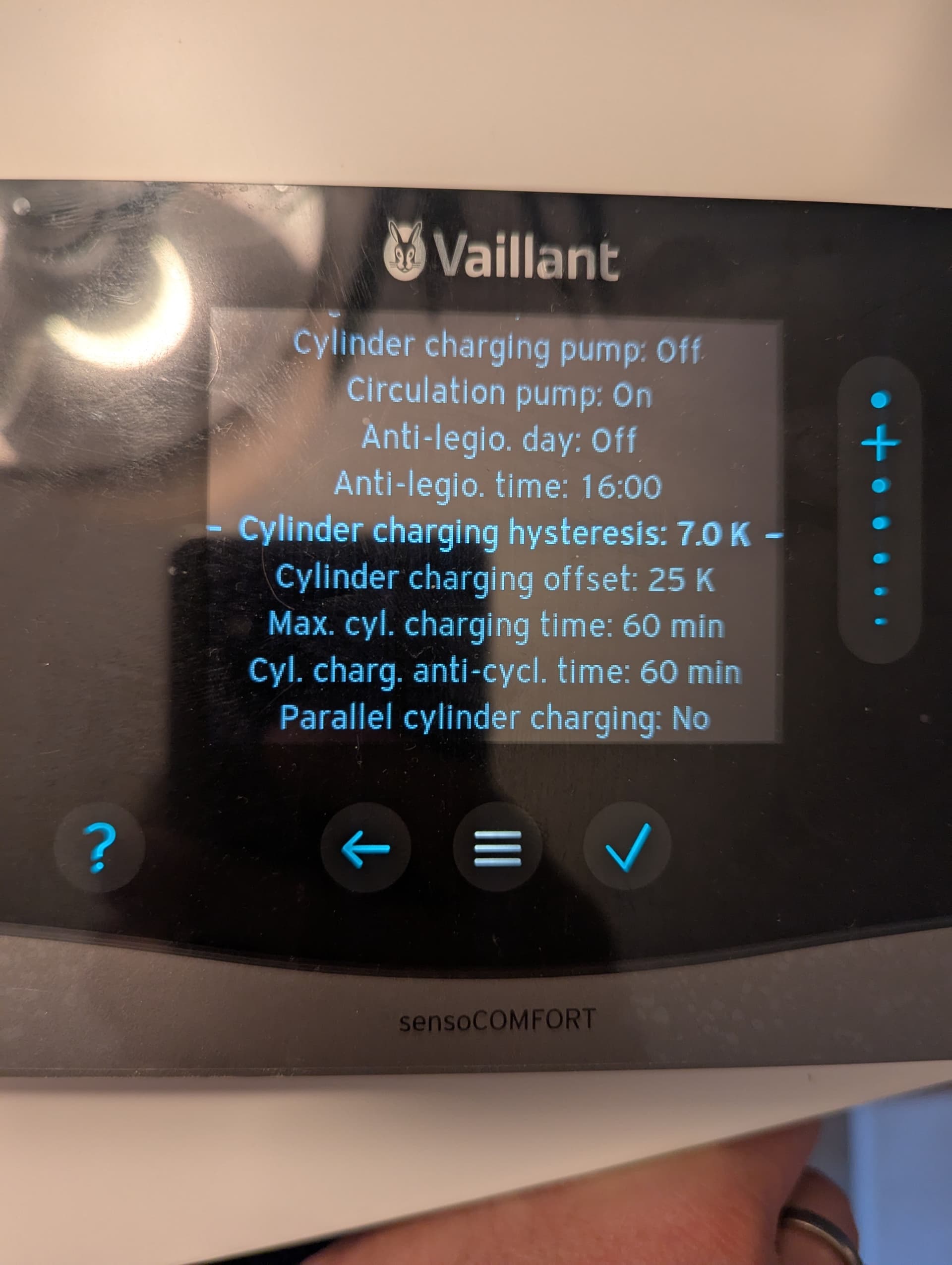

Anti Lego is off.
I can’t understand it.
There is a DHW frost protection mechanism; if the DHW tank temp drops below a certain value, the ASHP will reheat briefly to bump it up to a ‘safe’ temp, regardless of DHW schedule/settings.
I’ve had this happen after kids having a bath along with it being cold outside.
Thanks, this must be it then. Though it seems the limit is a bit high, especially given the tank is highly insulated and internal.
Do you remember where you saw the documentation on it, to understand what the rules are?
This document says something about 12C. Our mains water can arrive at less than that in winter, I guess evening baths might turn this protection on a lot. Which isn’t ideal with high electricity prices then. I need to see if I can turn it off or reduce the number lower.
