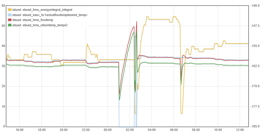

So experimented with the HC last night, lowered to 0.7 (from 0.75) but instead of having a setback to 17.5 degrees from 2130 until 0700, I just left it on constant 18 degrees and see what happened.
Living room (where the OEM thermometer is) was 17.9 at 2200 hrs but by time we woke up this morning it was 17.5. However upstairs was 19.1 degrees when we woke up so a degree and half difference which is indicating that my HC can be lowered but got to get my radiators balanced first. I know there will be a bit of that heat rises but I’m sure I can get closer between upstairs and downstairs and even lower my HC to 0.65 or 0.6 once done.
Defrosts overnight was 7 defrosts since midnight up until now with overnight temp of 3.0 degrees here.

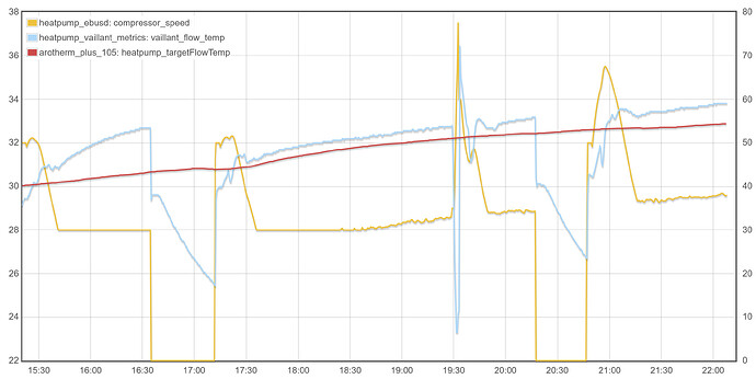

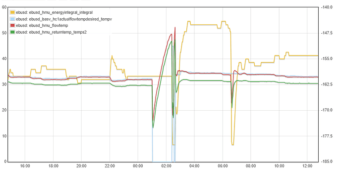

I am finally seeing some temperatures where my 10 kW unit has a chance to run continuously (currently pushing -10°C)…but it’s not. Here’s what’s happening (left y = temperature, right y = compressor rps, all values off ebus, so the heap pump is using exactly these values for its computations):
The first visible cycle (until 16:30) is rather typical for me: Flow temperature keeps creeping further and further away from the target even though compressor speed is at its minimum (30 rps), EnergyIntegral (not shown) increases and the compressor is stopped once it reaches 0°min. I’m using a comp. start. heat value of -100°min if that matters.

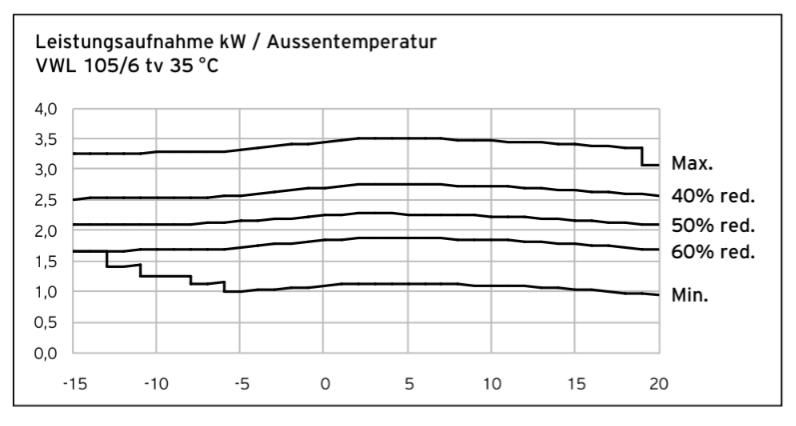

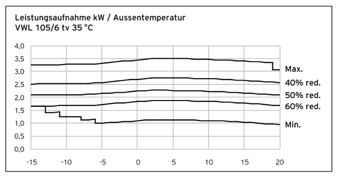

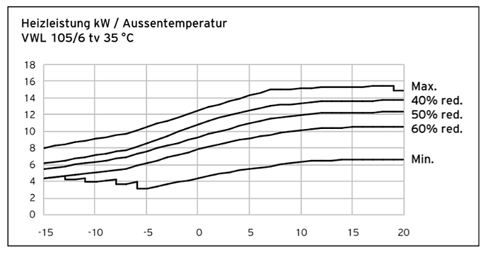

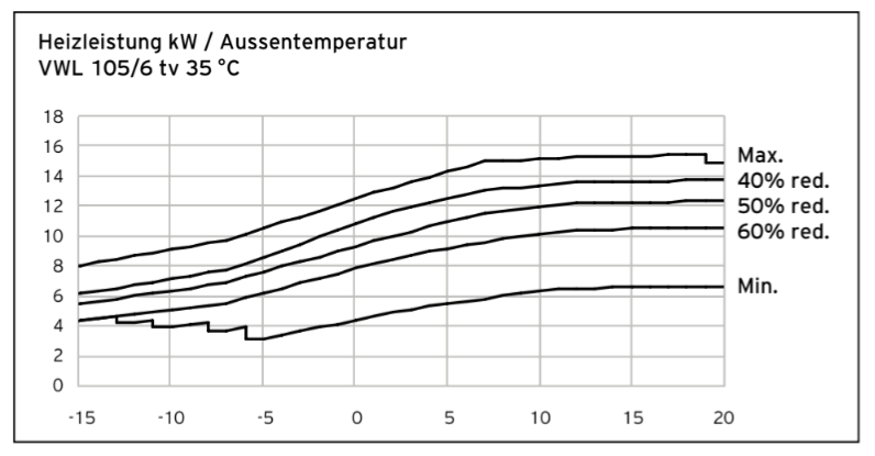

Starting at around 18:30, the compressor starts working above its minimum speed and the flow temperature more closely adheres the target - but with an offset. Consequently, the EnergyIntegral still slowly builds up and I’m still seeing cycling. Granted, a 3-hour cycle length is OK but I still don’t understand what’s going on. Why is my compressor currently at 39 rps, with flow temperature roughly 1°C above target? I understand that the underlying algorithm still needs to decrease the integral term and thus has to overshoot the target for some time, but why doesn’t the compressor speed decrease once I’m getting close to 0°min? Is there some physical limitation that requires higher minimum rps at lower temperatures?
Can someone with a more appropriately sized pump please post an EnergyIntegral curve for a long steady-state run so I can compare?
Edit: It seems this is normal - minimum power draw & heat output starts to increase for minimum speed below certain temperatures. I’m not complaining about a COP of 3 at -10°C, but it would have been nice to at least once see this baby run steady for a night :sweat_smile:.

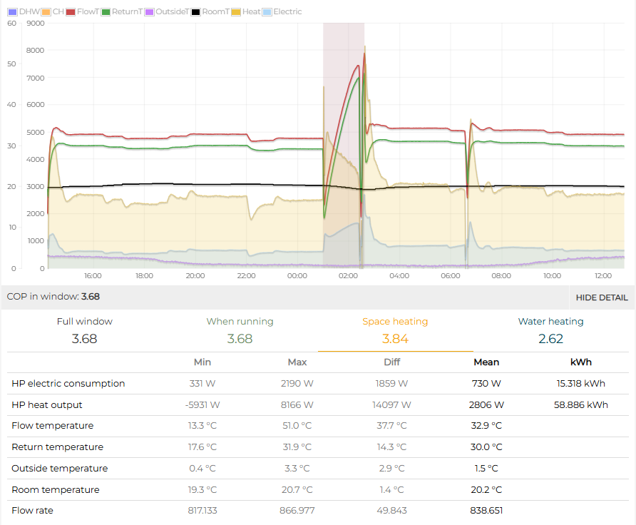

This is yesterday for me Andre on my 5kW unit at heat curve 0.5, active room temp mod, target 20C indoors (apart from small 19.5C setback 22:00 to 01:00)
Avg outside temp of 1.4C
This is the matching period on emoncms
https://emoncms.org/energystatsuk?mode=power&start=1739715120&end=1739796480
Apart from the hot water run, constant running.
