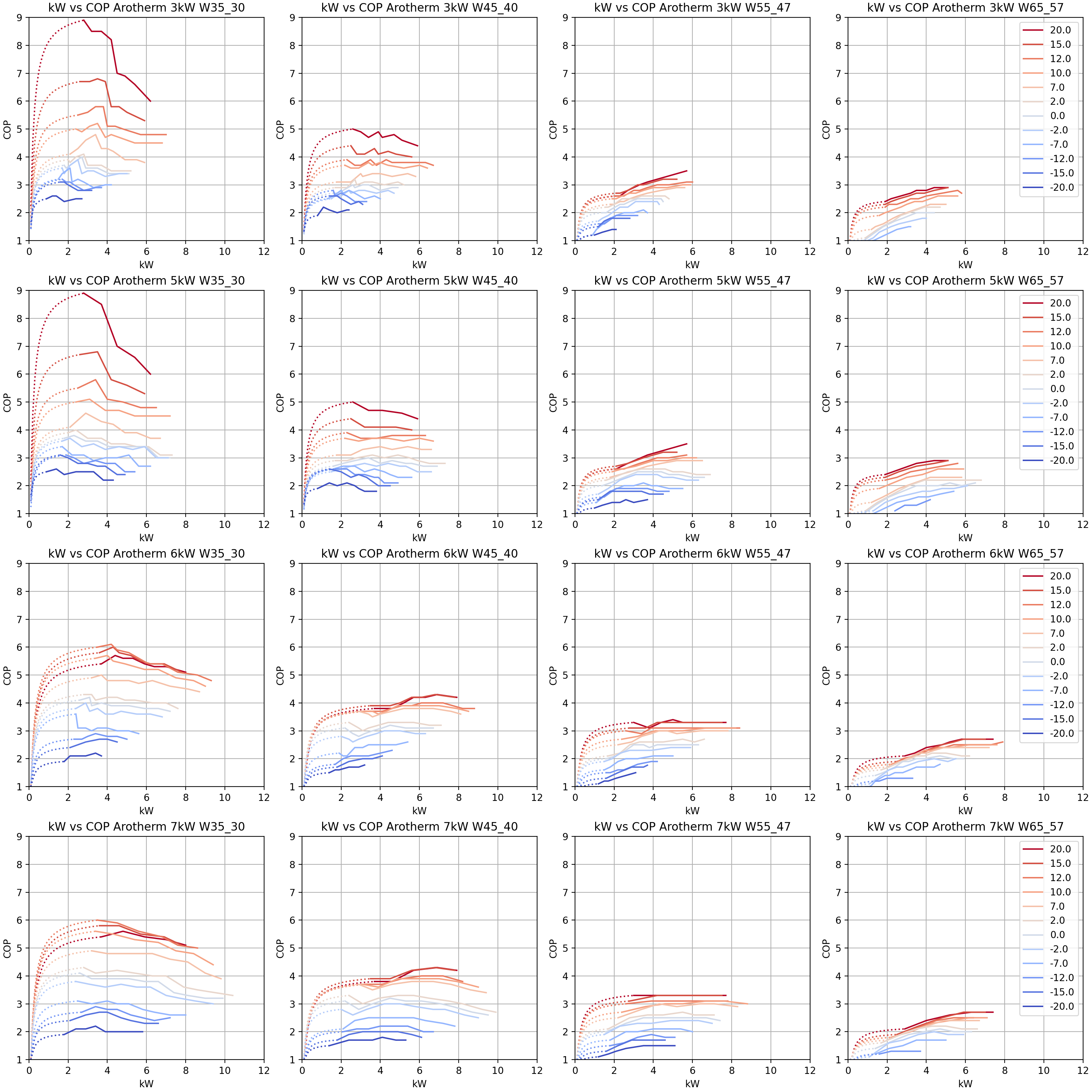

For starters, anyone looking for in depth performance information, this technical document from the Czech Vaillant site is gold.
I’ve converted these tables into a set of kW vs COP graphs:
