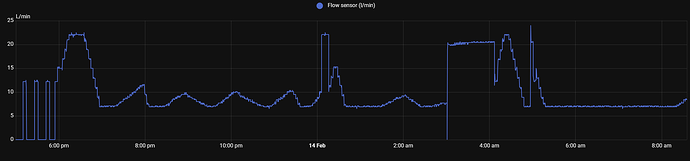

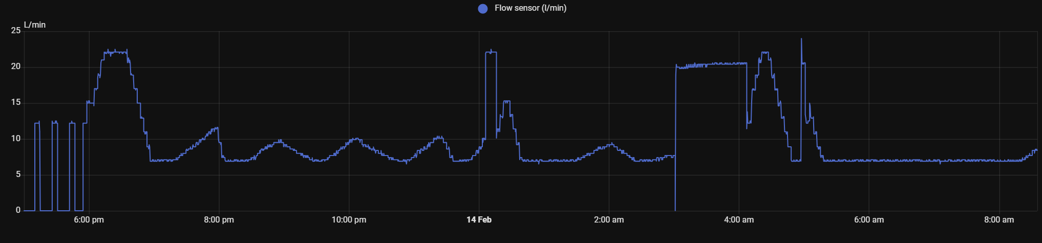

I have a new question. I haven’t really paid much attention to flow rate but reading various posts here I’m thinking I should. So 8kw altherma 3. Had a whole of host of issues and system was recently reconfigured removing the buffer and converting that to a volumiser. I notice that my flow rate is consistently between 6.9 and 7.1. Now it appears from posts here that that may be causing inefficiency ie not getting as much heat optimally as I could. So typically what would other altherma users be seeing as their flow rate and can it be adjusted , is there a setting or is it purely determined by the heat pump?
very normal, see our last ~12 hrs, 24l/min on initial heat up and DHW…for a system with no buffer tank ie just a volumizer and one pump in the Monoblock
