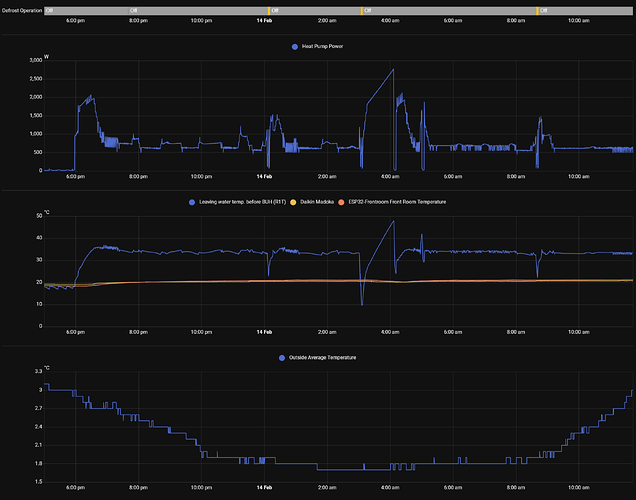

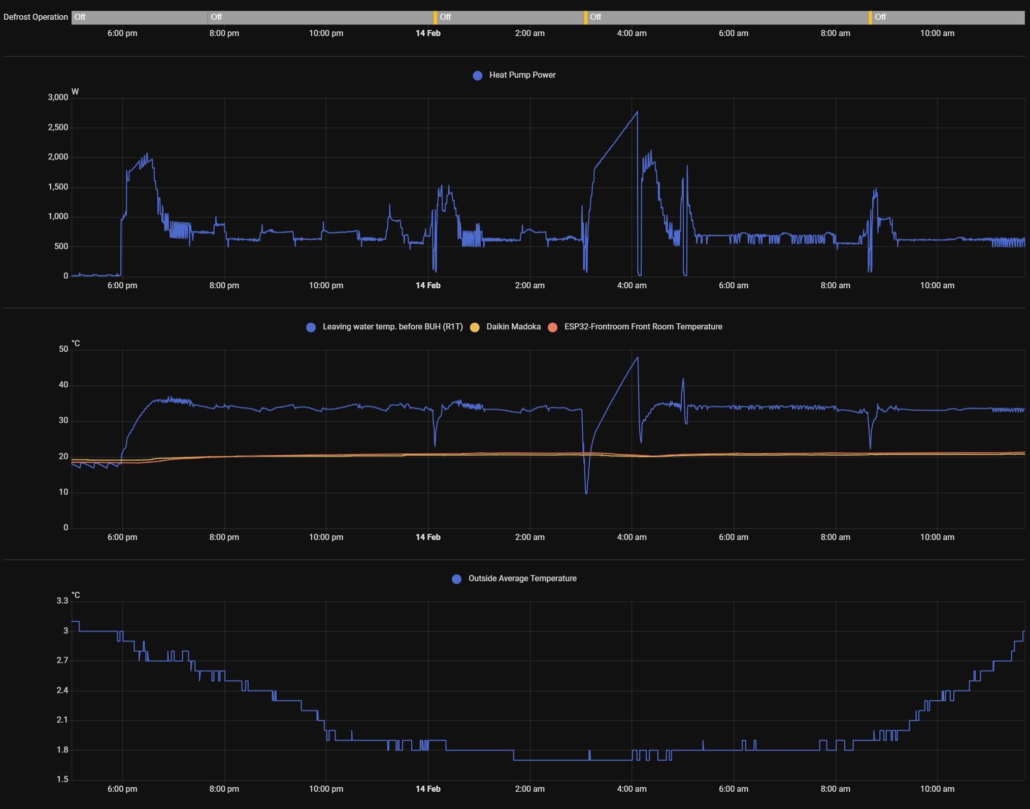

Here is our 8kW unit overnight, 3 defrost and a DHW cycle
Defrost, Power, LWT, Room Temp and Outside Temp
Hope this helps?

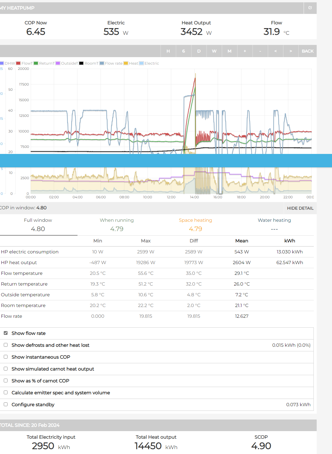

Also check out this 8kW system as a benchmark @KnightPhoenix
https://emoncms.org/app/view?name=MyHeatpump&readkey=bfd97700dd78658dedd70ff6670b453c

This is mine with a lower dT, the flow rate is completely out of control as is the heat output. Add in Madoka control and modulation and it is just an unstable mess.
