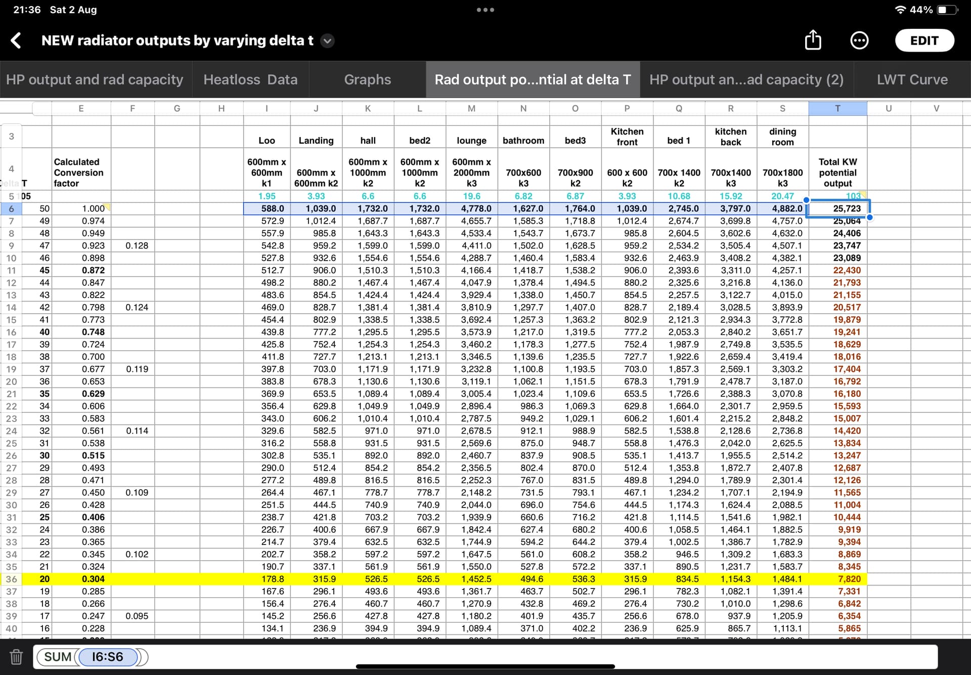

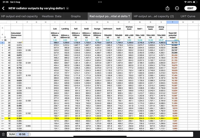

@matt-drummer , Matt what do you need beside the radiator sizing. I’ll pull it together and post it tomorrow.
Hi Terry,
Just total radiator output will do, but if you are not sure just put up the Octopus radiator schedule.
Do you have data to look at?
The total at 50c is 25.7kw
