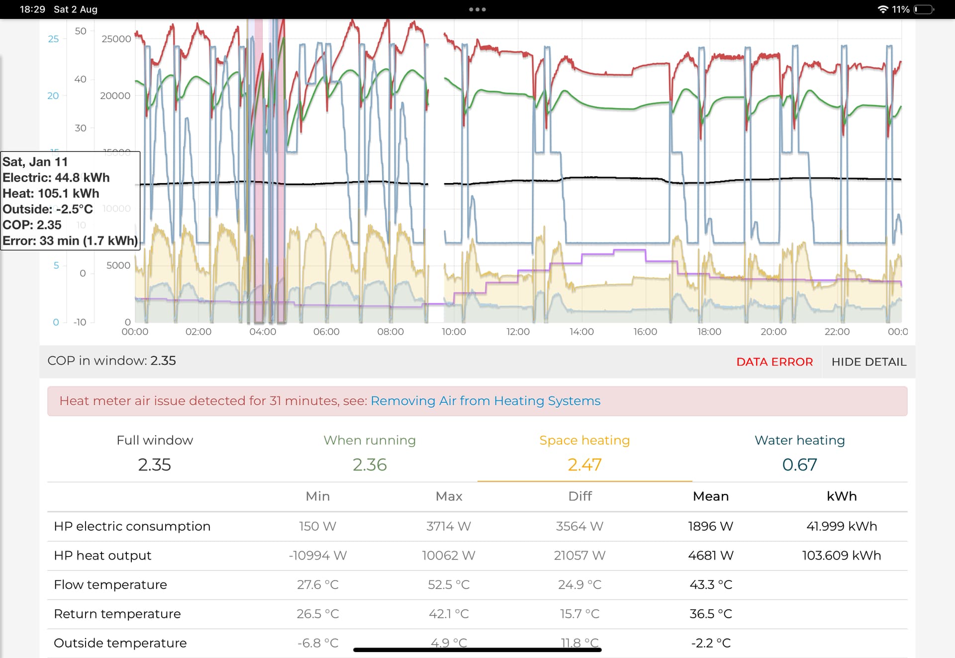

I have a Daikin 8kw unit installed jan this year, straight after installation before I adjusted the pump to the house for the first couple of days we had some really cold snaps ,
When temp was between -6.8 to 4.9 On first day and -5.2 to 1.6 on second day
I had max input of 3993w and a heat output of 10095w
Flow rate for heating always sets down to 6.9 to 7.1 after the initial high flow
Octopus had the weather curve set to 50 degrees at -2.5 if I remember
correctly
Have you check if quiet mode is on or if any max power setting have been set ?

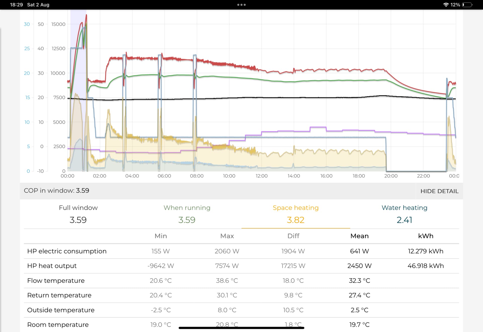

After adjusting by weather curve to 37 @ -7
On a cold day -2.5 to 8 degrees I had a max input of 2060w with a heat output of 7574w
@markr , Mark, just so I understand, I’m assuming the figures you are quoting are daily usage and daily heat output, would that be correct? Also were you running 24/7?
No max power in at any point in the day and max heat out
Theses were vey cold days and the weather curve was set way to high witch does effect the heat output dramatically
Yes in winter I rain 24/7 on full weather curve no Input from room stat
See attached a couple of screenshots of my data

I have my system set to heat to 48 degrees at the moment with quite mode on and heating at midnight I have a max electric input of 2kw and a max heat output of 7kw
@markr , mark could you send me a link to your Heatpump on open energy monitor, so I can have a look. I can’t tell what the lines refer to from the screenshots. But this looks interesting. Thanks
