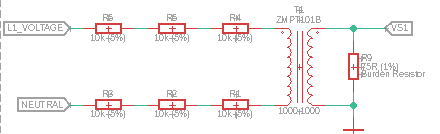

I see in the parts list that it calls for one of these:
1 x ZMPT101B AC Transformer Module 250VAC, 5-30VDC. For most use cases, one voltage meter is enough even if there are more phases.
If it is what I think it is and it has an op-amp and adjustment potentiometer, and it looks as if it is, forget it. From the circuit diagram I have seen for one of these (not necessarily the one you might have bought), and from reports, you will never be able to calibrate it to read real power correctly, because the op.amp and filter circuit introduces a huge phase shift - about 20° for me or about 15° for you, meaning that a purely resistive load will show a power factor of 0.966. You will get far more accurate readings of real power (which is what you are billed for) using a plain 120 to 9V a.c. transformer, and a pair of resistors to drop the voltage to about 1 V rms (at 120 V line-neutral).
Alternatively, you could desolder most of the components on that module and use the ZMPT101B transformer on its own. It is actually a current transformer, and with the multiplier resistors we use in the emonVs in the primary side and a 150 Ω burden (R9 etc) on the secondary, you should get about 0.6 V rms, and that will be plenty for the ADC in the ESP32 (and like the c.t, you calibrate it in software).

If I gut the ZMPT module and just use the transformer what resistor array do I need to use on the input and output of the transformer. Is there a link to an existing schematic that would show how I need to arrange the circuitry.

You can only just see it in the photo in the Github link you posted, there’s just a single resistor in the primary circuit. By everyone’s reckoning, this is a dangerous thing to do as you’re relying on a single component that for my money might be rated for your 120 V, almost certainly isn’t good for my 254 V maximum. everyone else uses multiple resistors in series, so that even if one fails to a low value or a short circuit, there’s no immediate danger. We use a ZMPT101B in the emonVs (for use with the emonTx3 and emonPi2) and this is the circuit we use:
It’s designed for any voltage up to 254 V (our statutory maximum), and gives an output good for a 0.333 V rms (1 V peak-peak) input, and as it runs at a much higher current than the module, it gives a much lower phase error.
ZMPT101B-Phase
For you, it would run at approx. 2 mA, so you’d need a 150 Ω resistor for R9 in order to get 150 mV rms (a little under 0.5 V peak - peak). You can adjust the burden resistor value within limits (< 200 Ω) to suit the ADC ranges available to you. I wouldn’t worry about not using the full range of the ADC input - this is far more important for current because the current range is 0 - maximum, whereas the voltage is essentially constant, varying only ±10% from the design value. (You probably have better resolution on the voltage at half the full range than you have with the current on normal loads.)
If you make this up on stripboard or similar, make sure you have adequate clearance between all tracks - there might be 350 V peak between two tracks if you have an open-circuit resistor and it’s connected between two legs or if it is connected line-neutral and the neutral falls off.

I completed the modification that eliminated the op amp and capicitor on the voltage modules and replaced them with the series of three 10k resistors on each input.
I am reading .283 and .288 volts AC on the output of each of the two circuits with a 119.8 volt AC input. This is using the suggested 150 ohm burden resistor.
I am hoping the near 3 tenths of a volt will be a sufficient baseline signal to show the two split-phase voltage levels.
