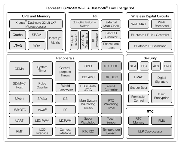

Turns out the correct pin assignments are crucial! Evidently the WiFi section of the ESP uses one of the two ‘ADC peripherals’ to operate; not sure what a peripheral is. I switched over to the other side of the ESP and used a new set of voltage pins and the Voltage values no longer disappear.
I wanted to ask you if you have any exposure to Emon running on these little microcontrollers? I am getting around 4 seconds of execution time for each Emon instance. That is an incredibly long amount of time for code execution. If that is normal then it is what it is. I believe you can shorten/lengthen the number of cycles it looks at the inputs but that can possibly sacrifice accuracy I would think.
You only need to look at the second page of the data sheet:

The data sheet (again :grinning: ) says
What I don’t know is what 3rd party libraries in the ESP might be doing in between emonLib and the ADC itself, so the sample rate you get will most likely be significantly less than this. This is certainly the case with the Arduino libraries as used in emonLib, as you can see from the numbers above. There is a faster way - the way we do it in emonLibCM and emonLibDB, where the ADC free runs and dumps the values into a memory location, then generates an interrupt to signal the main software loop to take the value and process it. Before you ask about converting either to run in the ESP32, it appears to be possible from what I read here esp32_technical_reference_manual_en.pdf, but I’m not going there.
Most people who use the ESP8266 and the ESP32 have a separate ADC and use the ESP to do the maths and send the results out - usually by Wi-Fi.
