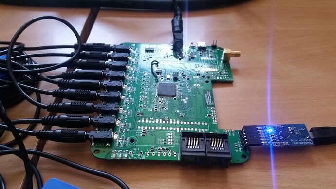

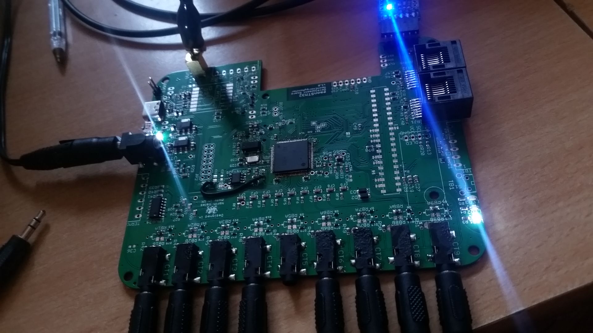

Hello,
New revision here. v1.0
The range on the amps readings buffer with 9 CTs connected is 6.

Nice! So 6 ADC units represents 117mA?
What happens if you put max deflection through Chs 1 through 4 and 6 through 9. Does Ch5 stay at 116mA?
We have different reference and burden values now so 6 units would be 2.048V / 4096 * 6 = 3.5mV…
3.5mV / 6R8 = 0.51mA
I swapped the burdens for 150R to amplify the signal and did the test you’ve recommended and it’s interesting.

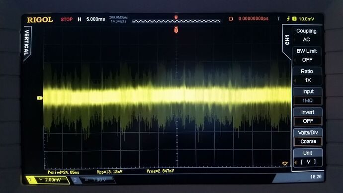

There’s a small effect on the remaining channel.

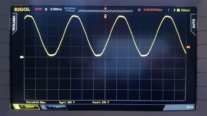

This a trace of the signal:

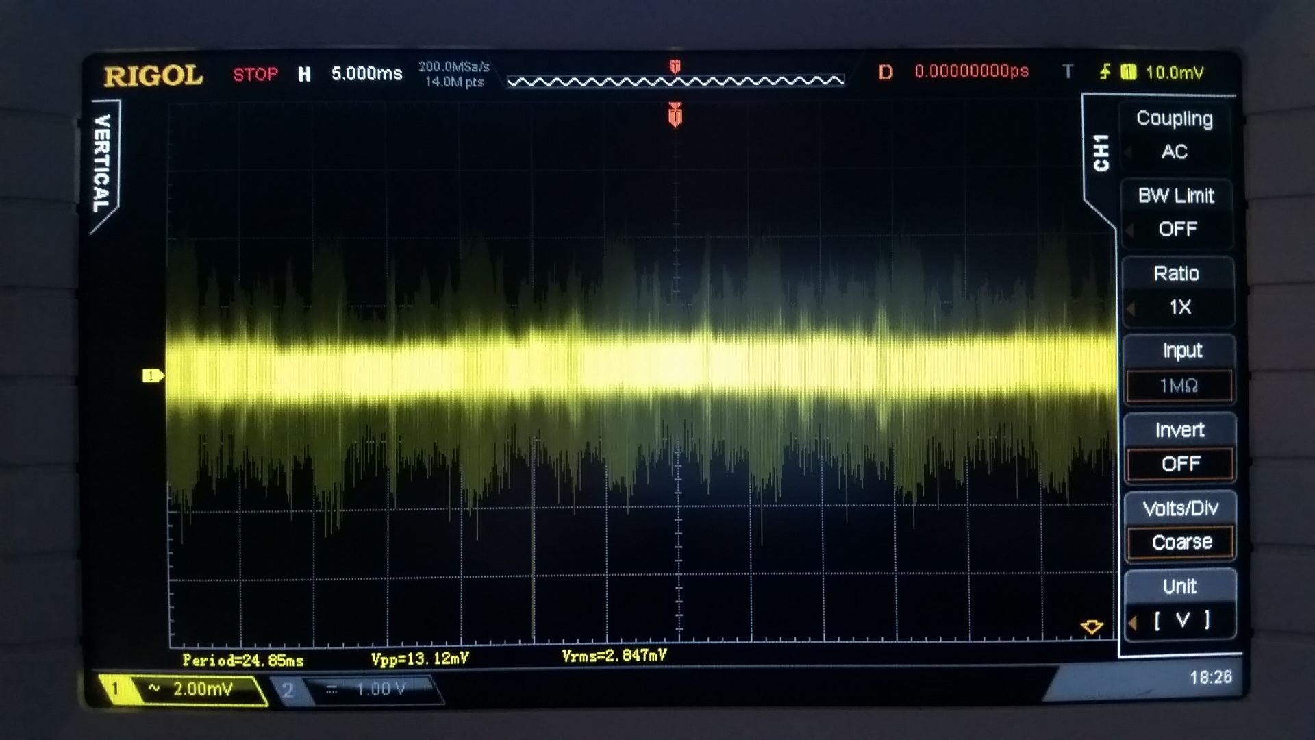

and this is one on the remaining channel:
I see a slight wobble and a ton of noise. The load is a fan heater on half-power. I have those nicer loads to test with so I’ll have to bring them in to the lab some time.
On the plus side, the signal is represented by a notional current reading of 193.072, against the wobbled channel at 0.138, so there’s a ratio there of near 1400 anyway. Considering how noisy the signal is, not bad. Also, the background noise doesn’t look too bad with this scaling. Also, comparing 0.138 against the 0.101 below says something.

I figured out a way to print out the single channel buffer values.
The range on ch5 with all other channels with a 1.6V peak-peak signal on them is 22.
A fair bit up from 6.
no ct with ct no ct + load on with ct + load on
3 6 22 22

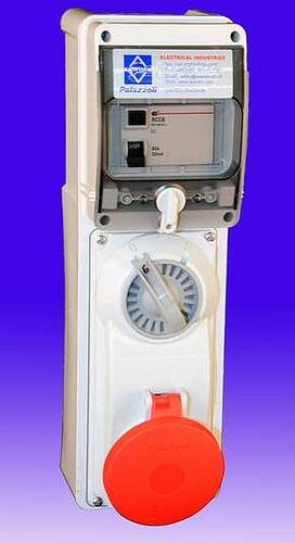

For my connections I have a 3pole linked MCB in the fuse box, the lowest current I could get was 6amp, then a 4pole isolator, which is then wired to the PCB with 100ma fuses.
Sorry for the 90 degree rotation I can’t make it the right way up!
IMG_7126
I’d much prefer to to have low voltages coming out of the fuse box.

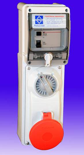

At work I have a combination 3 phase outlet for connecting to kit I’m testing.

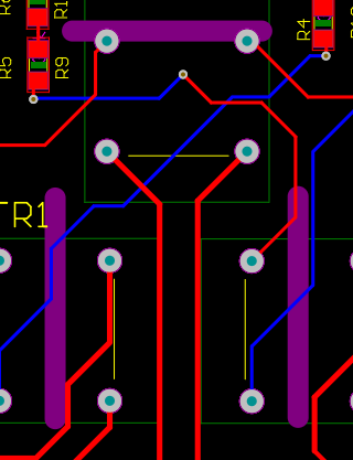

You might want to review that layout to make sure you’ve got a clear continuous 8mm isolation strip on the PCB between the primary side and the secondary side. You may already have it, and it’s just unclear from the photos, but with that offset and rotated transformer, it looks like it could be tricky to achieve.
I think there’s something like that despite the zig-zagging isolation line… needs checking. Where does the 8mm come from?
Safety standards like IEC-60950 (now replaced by IEC 62368-1) and IEC 61010 require reinforced insulation between primary circuits and SELV (low voltage safe) secondary circuits. To accomplish this they call out specific creepage and clearance requirements between the two areas. In addition any component that straddles the reinforced insulation boundary must meet the particular safety specs. The PCB creepage and clearance distances are determined by the working voltage of the circuit and also the over-voltage category which is related to where in the electrical supply it is situated. The over-voltage category determines what surge voltage the reinforced barrier must be able to withstand. For most circuits with a working voltage of less than 300V the creepage distance is between 6.4 and 8mm. Additionally, as the transformer straddles the safety barrier it must also meet reinforced insulation requirements and should have a UL, TUV or similar safety approval to be used in a product.
Daniel, I took a look at your v0.3 eagle files, looks like you have a mil slot defined, but it didn’t come through well when I opened the files in Eagle V9.6.2 and some tracks were crossing the mil slot. Maybe it’s a version thing.
I imported the PCB into Altium and got this:
Capture
I haven’t looked at your previous versions yet.
I notice the two bottom two transformers were 90 degrees to the top one, is there a reason? space in the case? It makes the isolation a bit more complicated.
