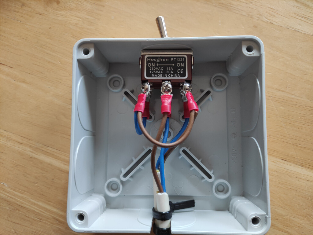

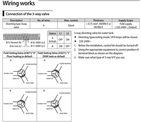

Back on topic, I decided to go with a manual switch rather than the automated solution @Michal_S has implemented. Referring to the Samsung manual:
I needed to ensure than B17/B18 were OFF/ON for heating and ON/OFF for DHW operation.
To protect against AF/AS cycles, I needed to ensure B18 was always powered (from either B17 or B18), but that B17 at the valve was not, so implemented this via a DPDT switch. I cut into the B17 and B18 wires linking the Samsung controller to the Joule circuit board that controls the valves, and connected to my DPDT switch:
I’m still in the process of testing, but so far so good. Under normal operation, space heating and DHW work as normal (as expected).
In Test mode, with the switch in the normal position I can hear the relay activate and the DHW valve move when turned on and off. If I move the switch to the ā€˜protected’ space heating only position, and again try to activate the DHW valve, I hear the relay click but as expected the valve doesn’t move (or at least I cannot heat it move). Result.
I now await some colder weather to fully test, but I’m confident I have a working solution. We will just flick the switch whenever we are expecting colder weather overnight.
My thanks to @Michal_S for sharing their relay solution.
Edit: I used Wago wire connectors that are excellent quality and really easy to use making the connections very simple.

The switch has two positions - one allows the system to operate normally and the other effectively locks the 3-way valve in the heating position by ensuring B18 is always powered and B17 is off.
I know when I’m likely to be affected by either AF or AS cycles, so can now manually ā€˜switch’ to protect against these, by locking the 3-way valve in the heating position.
In winter, AF occurs mostly overnight when we either turn the heating off or the heating cycles off due to set back on the room thermostat for more than one hour, and the OAT drops below 5C. In the ā€˜locked’ position, heating is unaffected and can continue to operate normally, but we would need to switch back to the normal operation position to allow the 3-way valve to open for reheating of the DHW tank.
In summer AS occurs when we do not regularly reheat the DHW at the same time every day, or do not reheat on one day and more than 24h passes.
We normally reheat our DHW daily (most days), so as long as the switch is switched back to allow the 3-way valve to operate normally before we turn on the DHW, this works fine for us.
So for us everything is done manually. We do not have any automation and do not try to detect and then prevent or mitigate AF/AS cycles, but rather use the switch to ā€˜lock’ the 3-way valve in the heating position if we know or think an AF/AS cycle is likely.
We have a 50L buffer tank on the primary return which will always contain warm water and will certainly be sufficient to prevent any freezing without taking heat from the DHW tank, and in summer for anti-seizure it makes no difference where the water comes from as long as the pumps regularly run.

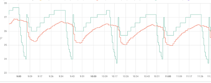

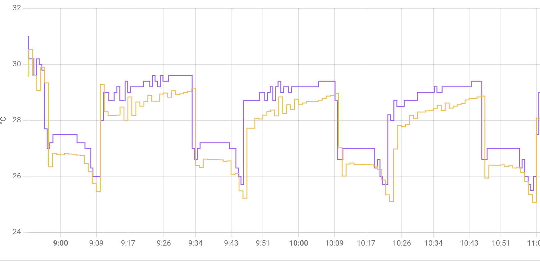

Looks like you had a couple of instances of #1061 working last night but I think you need to increase the value a little. Looks like you have it set at around 2 but most of the time LWT is immediately dropping more than 2 degrees below target so cycles on again. For reference, I have mine set to 3.5 and over the same time period, I have fewer and longer cycles.
Can I ask how you’re changing the target water temp? Presumably you have WL on, are you making changes to the target temp by the -5 to +5 adjustment setting on the home screen?
Yours
Mine

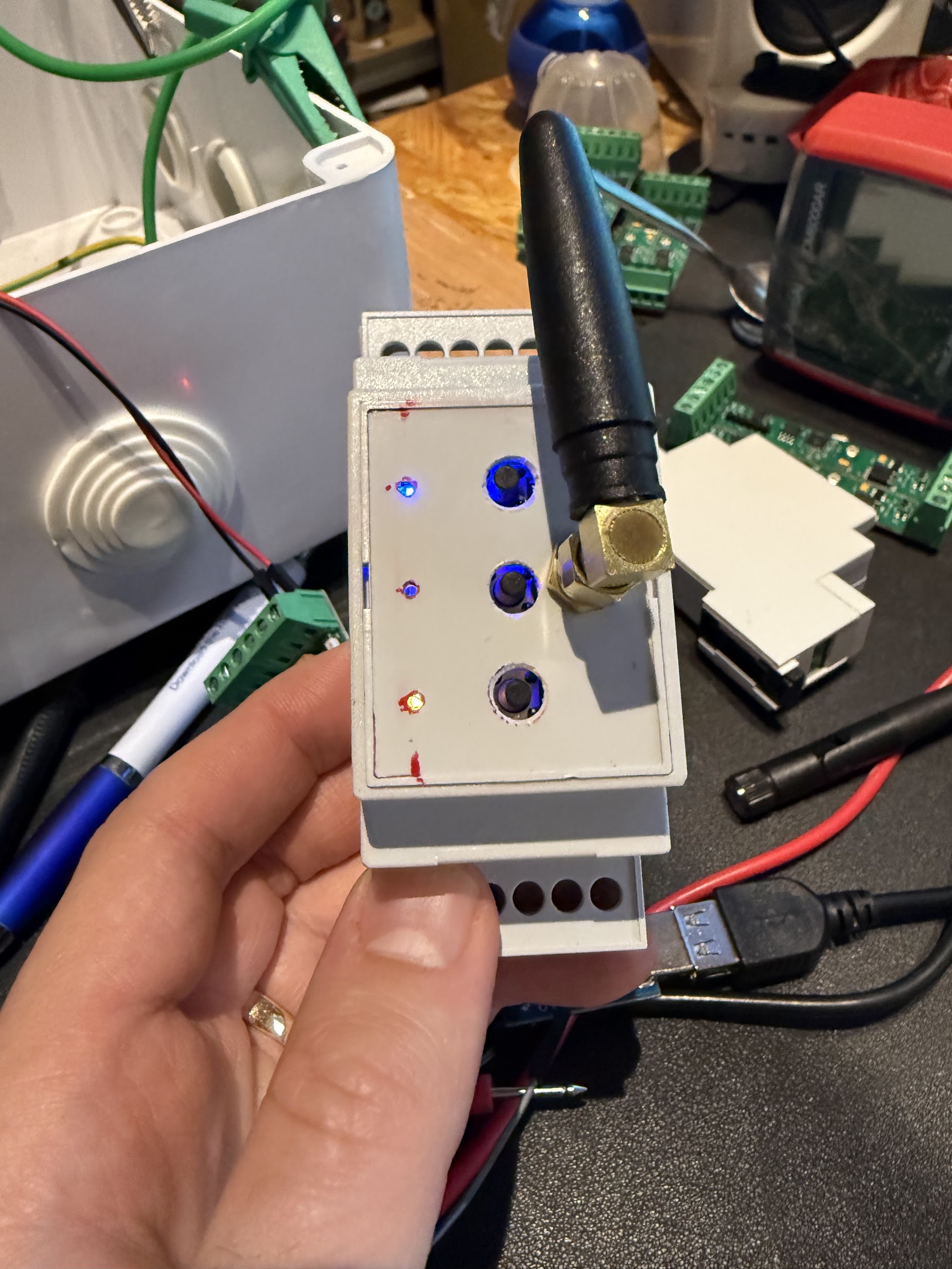

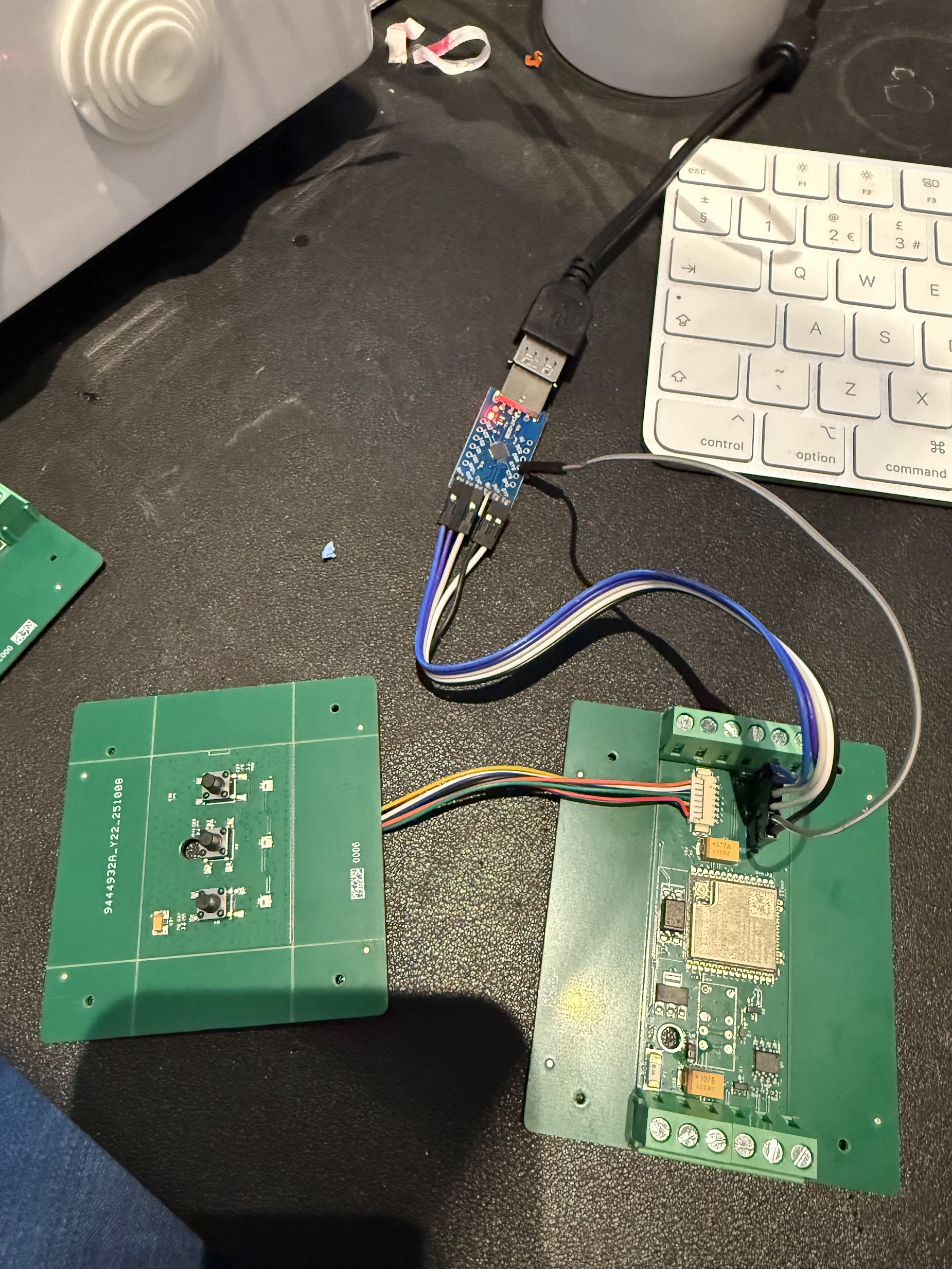

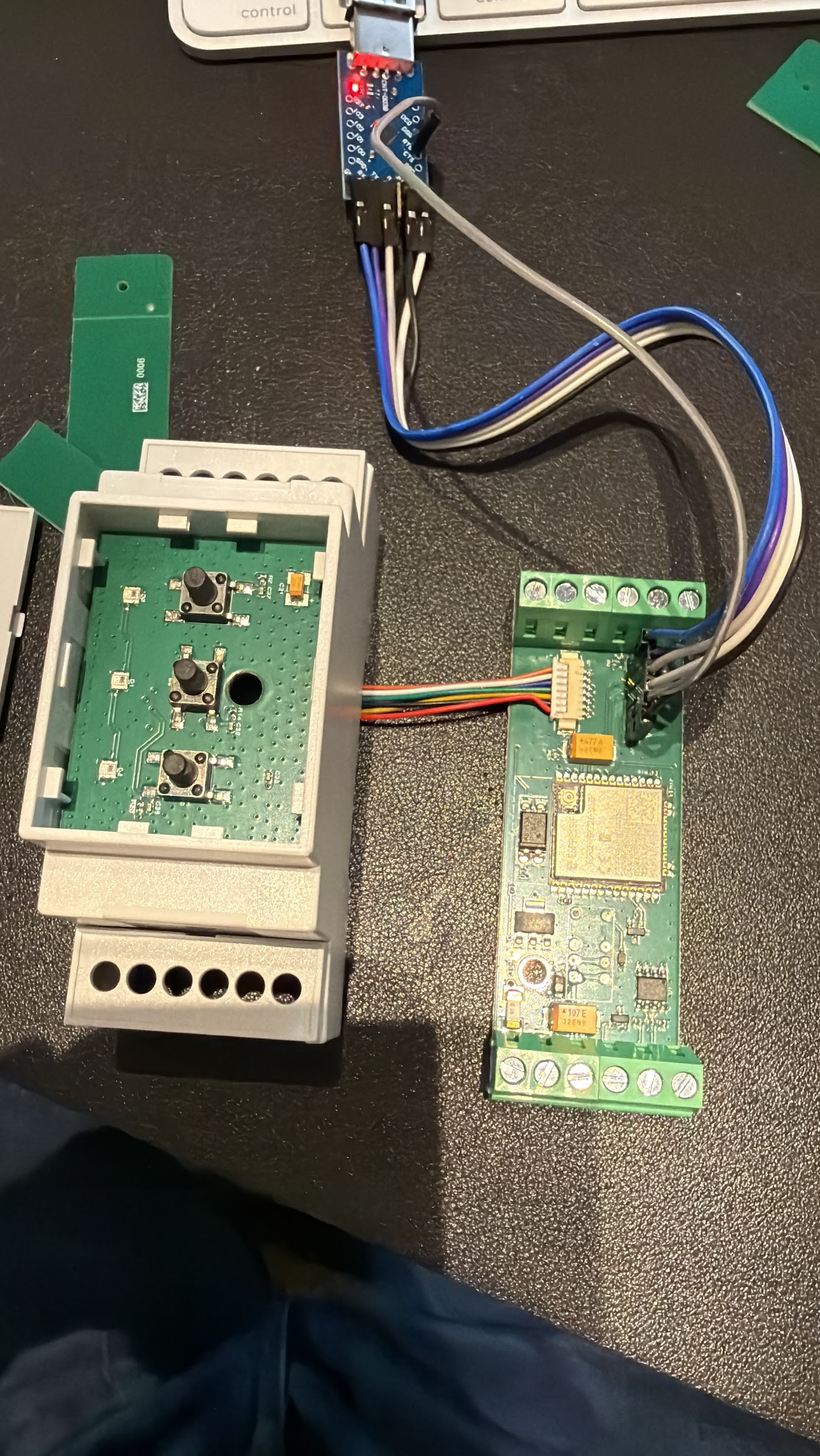

Ive gone a bit nuts on this and built a custom PCB with custom fireware for running the heat pump. My only homely (I am exploring making it a commerical product)
Care to explain how it works? I’d be interested.

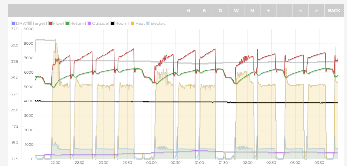

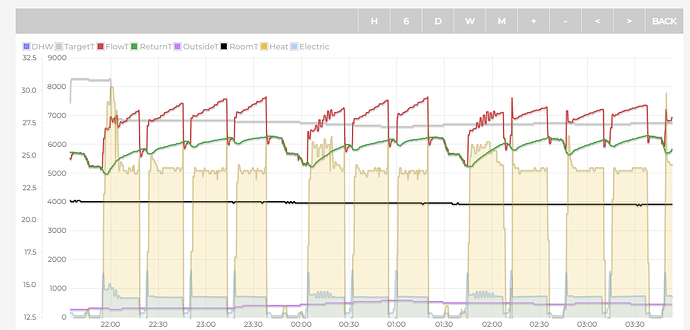

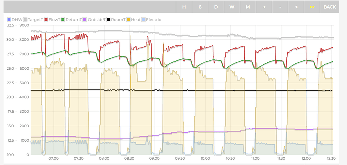

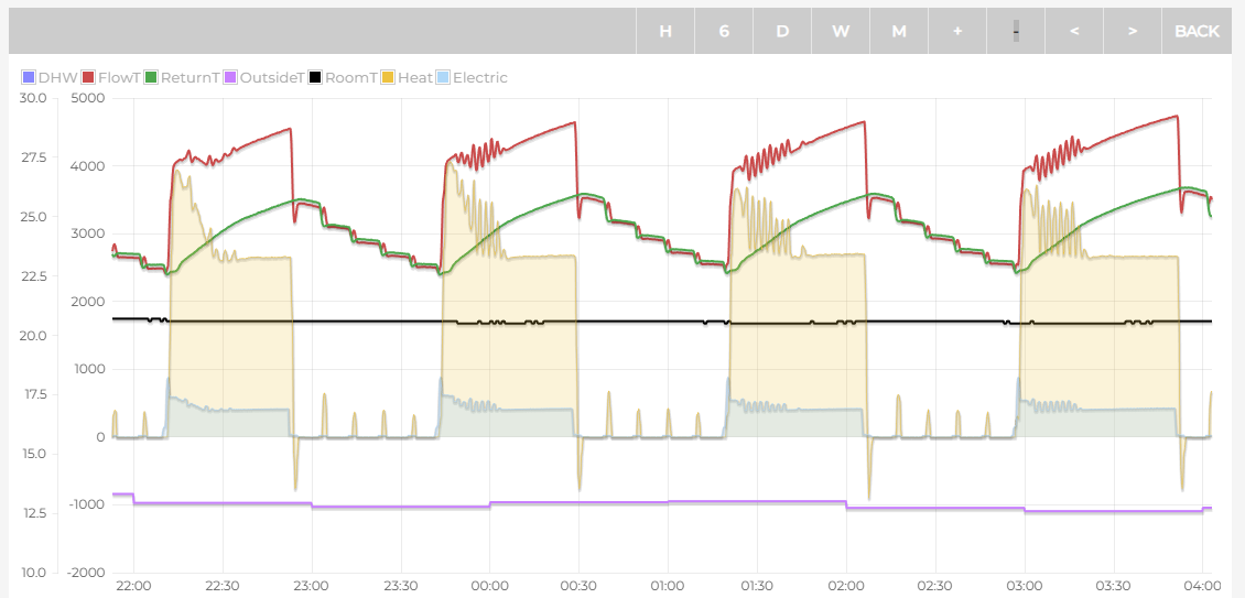

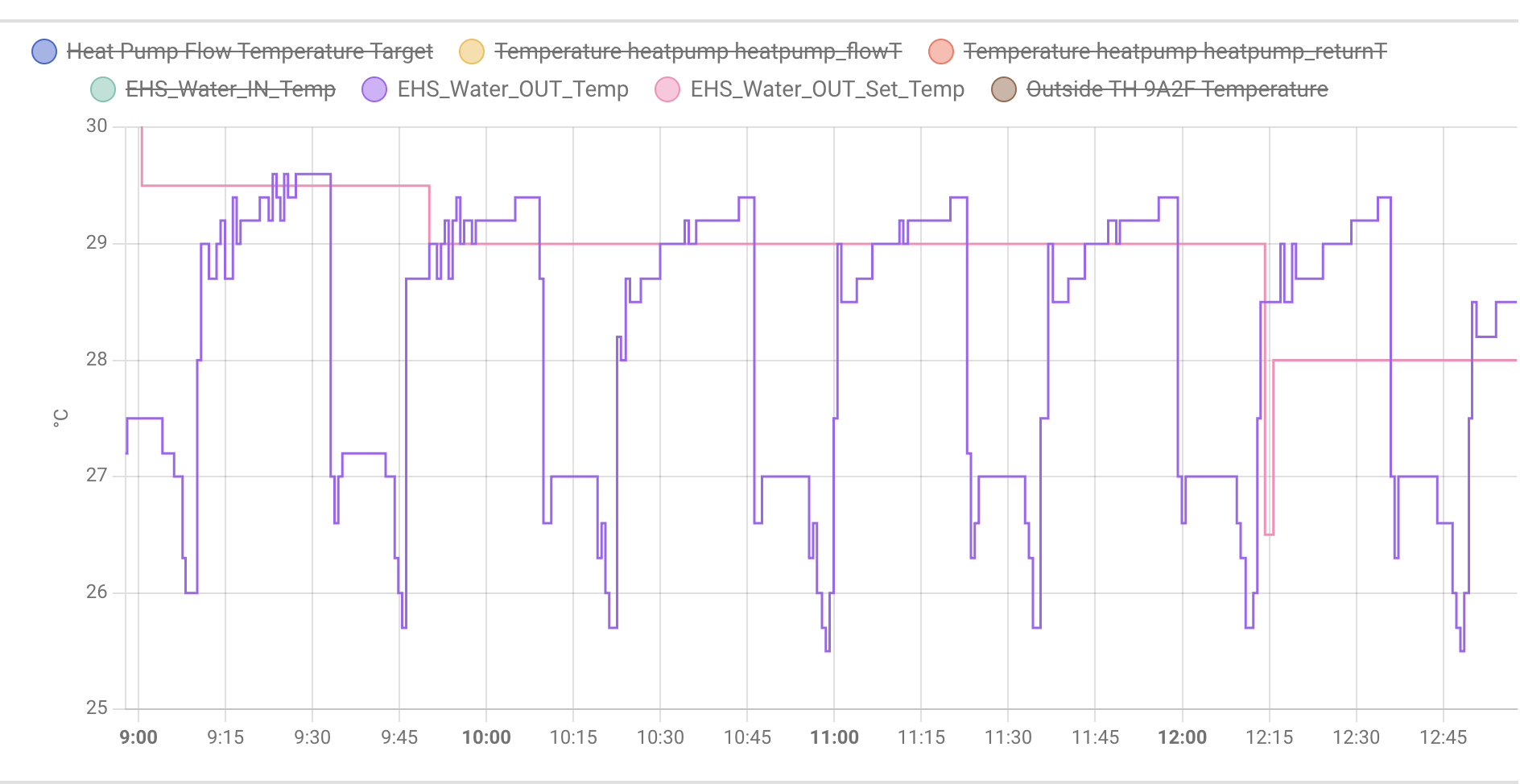

What is also interesting about yours is that it seems yours seems to be cycling before it even reaches target temperature. Any idea what is going on here?
Couple of things
  1. Since this morning I have turns off my weather comp stuff to set it to fix flow rate to remove a varable.
  2. Samsung temp sensors and emon never match
Flow
Yellow Emon
Purple Samsing (higher line generally for Colour blind)
Return
Red EMON
Green Samsung (higher and not smooth)
I will set the target temp on emon to the set out temp but its going to be 2c off.
Seems the unit will do 22-24 minutes above the target temp, no mater what I set the target temp to
Its been off 12m on 23m all morning. House temp is rock solid -+ 0.07c
My controller connects via modbus. I keep getting distracted from building it and optimising my own house. It works like Homely does but I wanted it actually optimised and more customizable. I will be prob looking for testers soon but at this rate might be next heating season :smiley:

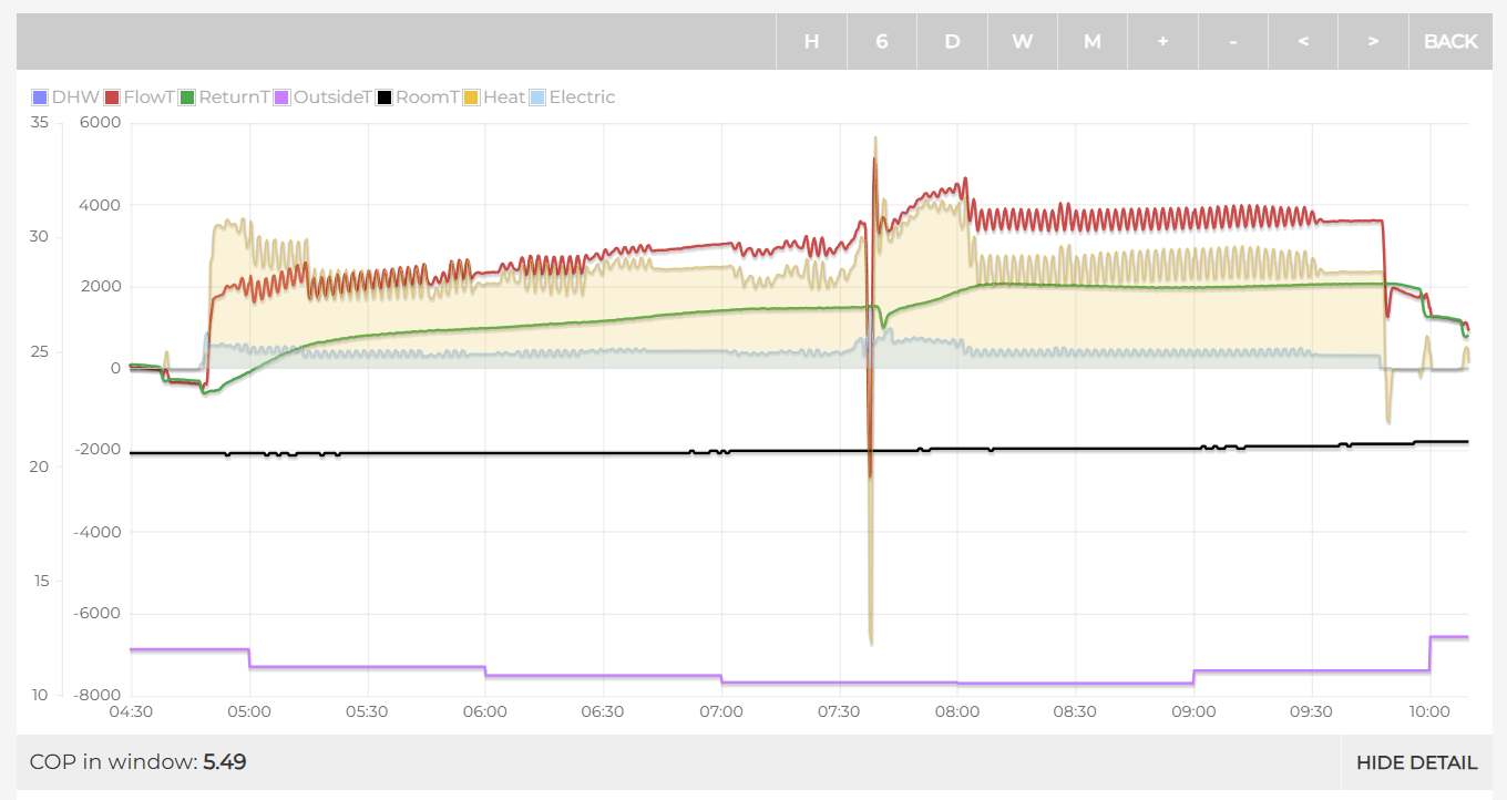

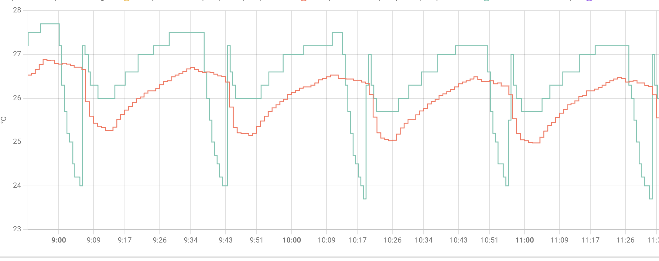

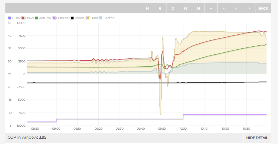

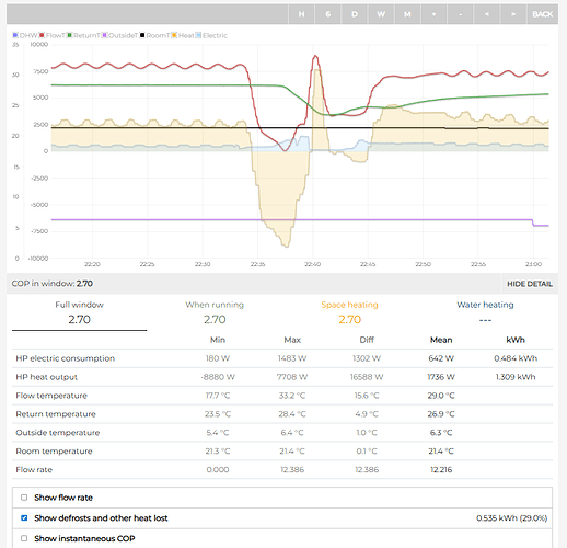

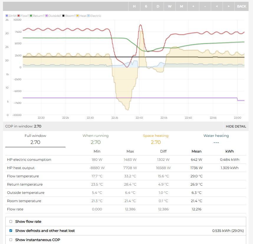

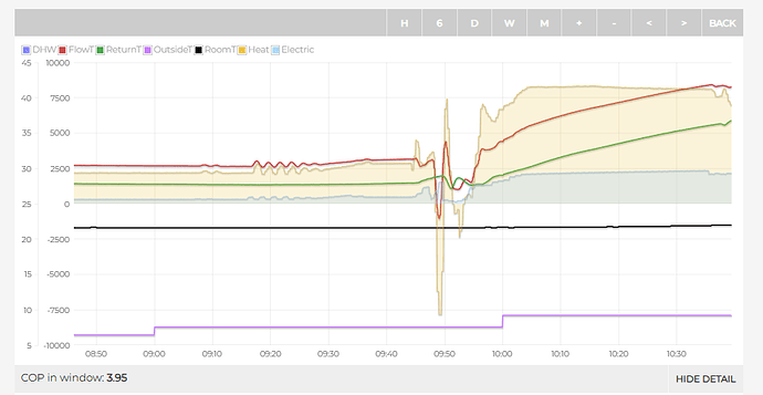

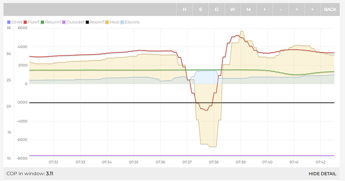

Has anyone noticed that raising the target LWT suddenly can cause a full on defrost cycle to happen even though it isn’t frosted up at all??
I’ve been manually lowering the target by a degree for a night time setback and raising it again by a degree. This morning I decided to raise it by 2 degrees and it caused the unit to run a defrost cycle. It was 10 degrees outside. This isn’t the first time I’ve seen it do this.
My worry is that when I use the smart grid feature to raise and lower the target temp (which I’m going to set up in the next week when my relays are delivered) that it’s going to do this every morning as the the minimum you can raise the target LWT by with the smart grid feature is 2 degrees.
The defrost only last 2 mins, instead of the usual 6. But was still taking over 6kW of heat out of the property for a while.
No, I’ve never seen that. How did you adjust the LWT? Did you use the +/-5C manual adjustment on the home screen to increase the LWT?
I’ve manually increased LWT by +5C before when Octopus were offering free or negatively priced electricity. I think I would have noticed a defrost cycle (or at least LWT not increasing as expected), although I don’t have monitoring.
Remember thats just power not energy, Looking at your graph while annoying its was 0.094 kWh.
Saying that ive not seen the my unit do this before.
Yeah, exactly. It’s very bizarre. I found another example from a couple of weeks ago when I changed to Heat and set the flow temp to 42. At was at 32 at the time, so 10 degree increase in LWT target.
True, it looks like a true defrost is more like 0.5kWh.
Confirming my manual switch solution worked last night. OAT was forecast to fall to 4C overnight, and we turned the heating off when we went to bed, and activated the switch to keep B18 powered and maintain the 3-way valve in the space heating position.
Come morning, the DHW tank temp was intact and hadn’t fallen excessively overnight, so problem solved for me.
