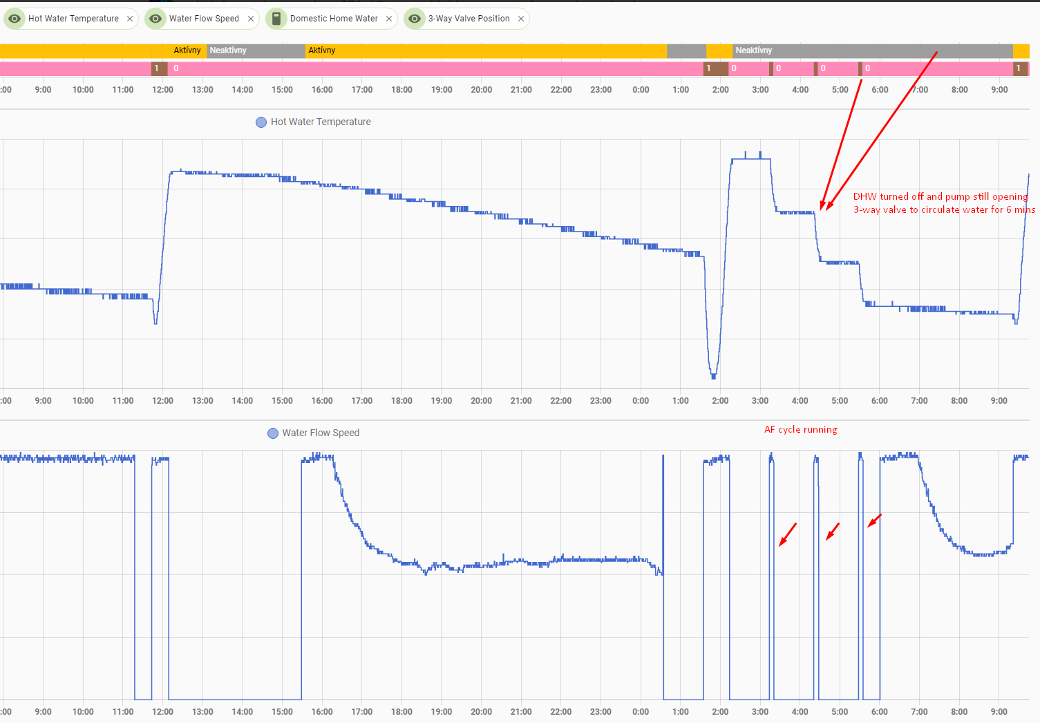

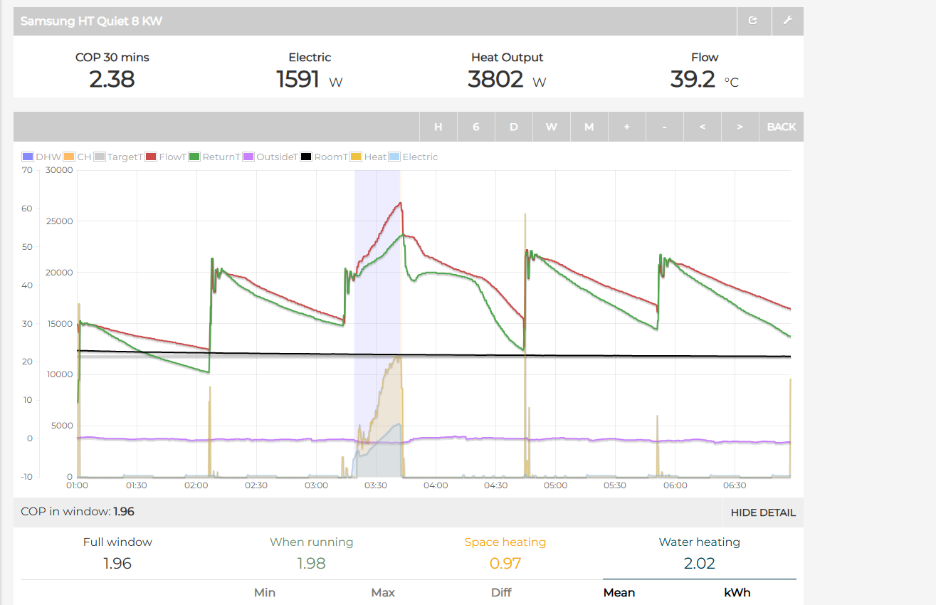

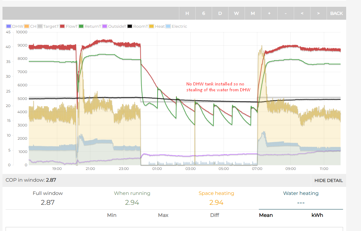

Hi Sarah, here some proofs for the guys. Can’t believe they are not aware of it…. You can easily see that when pump is running AF or AS cycles it opens always DHW circuit even if the pump is actually at CH circuit but not heating. You can see each AF run takes 2C from the tank. 5 cycles during the night steals 10C from hot water tank!
This was when I didn’t have DHW connected. You can see no problem for AF/AS cycles. It simply run the water in a circuit for 3 minutes or so and then finished. No issues, no freezing, no stealing.

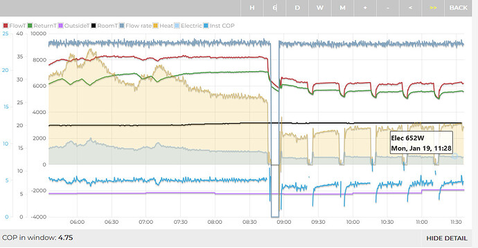

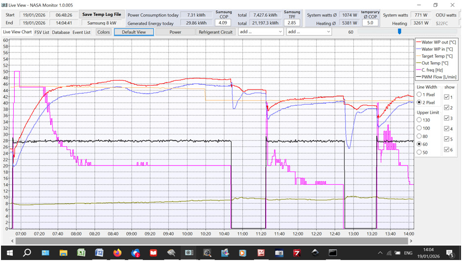

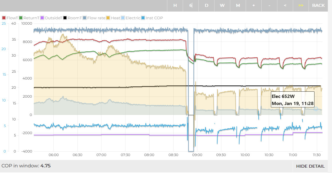

On the subject of minimum compressor inverter frequency, have a glance at the traces from my 8kW HTQ today.
Story so far. I run a 5degC setback overnight so the HP has to work hard to re-warm the house. To minimise the time it takes for this, I have a high WL setting (hotter radiators = quicker warm-up), which with #2091 set to 3 was causing a lot of cycling during re-warming because LWT was hitting WL target repeatedly. Once the living room was up to target, the roomstat took over control, but the high LWT when there was a demand was still giving a poor instantaneous CoP. So yesterday I decided to I change #2091 to 1 (so the HP would keep running at minimum inverter frequency even if WL target was satified), and to drop the WL target once the room was warm, in the hope of improving the CoP. Here is what I saw:
  1. (06:50) HP starts per roomstat programme, LWT (red) quickly rises towards WL target (yellow), inverter drops to 20Hz (magenta line), regarded as “normal minimum” for the HTQ range, and stays there (per #2091=1 rules, even though LWT gradually rises to >2degC above target).
  2. (10:20) Seeing that the roomstat was within 0.1degC of setpoint I reset the WL target down a few degC (you can see the yellow line respond).
  3. (10:50) Room reaches roomstat target and switches off the HP.
  4. (11:25) Room has cooled by hysteresis setting (1.5degC) and restarts the HP. Because the WL target is now lower, the inverter drops to 14Hz. This is something I’ve noticed before at milder OATs (today is ~9degC per brown line).
  5. (12:50) room temp back up to target, so stat switches HP off again.
  6. (13:25) back on again due to roomstat demand, and inverter returns to 14Hz.
The energy figures appear along the top and you can see that the instantaneous values at end of trace (top right) were 0.77kW consumed, 3.26kW generated. (The figures 1.07kW in/5.38kW out/5.0 CoP just to the left are the time averaged values over the prior half hour or so.)
So my preliminary conclusion is that, at mild OATs at least, it may be possible to force your HP’s output well below the “~50% turndown” capability that Samsung normally state.
Any comments so far?
