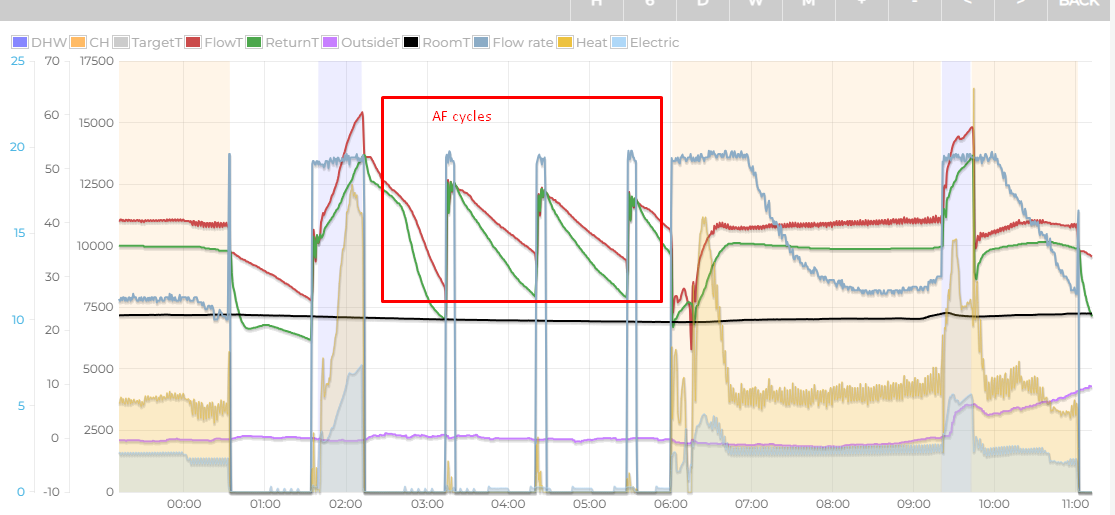

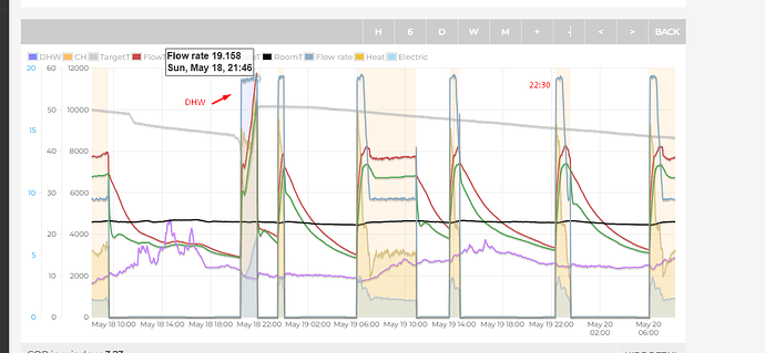

I agree. I will monitor these reaction times and let you know if it works as intended. From my charts that AF cycle lasts 8 minutes! Just enough to steal few degrees from water tank per cycle. Now imagine there are 3 or 4 cycles overnight…. Here you can see 3 but only because there was DHW reheat at 2:00. Otherwise I would expect 4-5 AF cycles. And it was only around 0C outside. And you can see all the reheat done at night was wasted on these AF cycles and at 9:00 the DHW must have been reheat again.

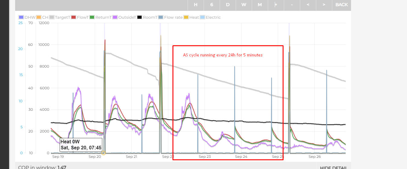

  1. If DHW is disabled, does a pump anti-seize (AS) cycle still run. My system seems to associate the AS cycle with the DHW. For example, even with heating running during the last 24h, the AS cycle will still run (assuming heating if off at the time) if the DHW has not run in the last 24h. The logic seems to associate the AS feature with DHW usage, not when the pump last operated, and we do not know what logic Samsung has used to implement these features.
  2. If DHW is disabled, will the anti-freeze (AF) still run, and if it does, will the 3-way valve remain in the position of the heating circuit.

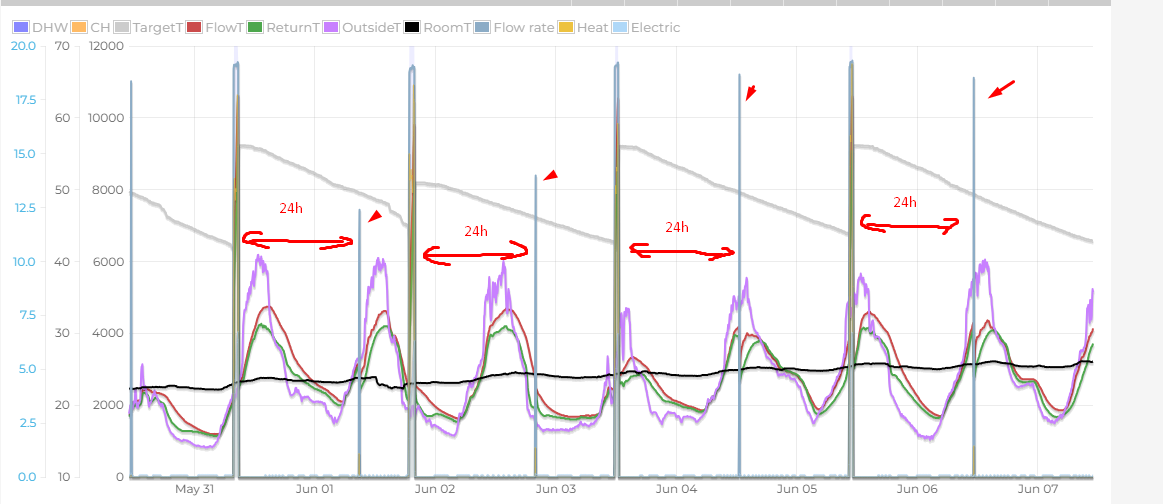

I though AS is related to heat pump on it’s own that simply it will start the pump for 5 minutes just to circulate a little bit of water so e.g. pump is not stuck in case the water pump is not active for 24h. This is usually issue with rotary pumps that when they are not use for couple of days it tends to stuck. I have such pump on mine coffee machine and last time when I was on vacation for 6 days it got stuck. So I don’t know why AS should be related only to DHW. Look at this chart from September when I was not at home so there was no DHW or space heating request. You can see it starts every 24h for 5 minutes. Of course during this action switching 3 way valve to DHW position. But why it is switching to DHW ?? I don’t have any explanation for this. AF I would understand but AS ?
To be honest I don’t know if deactivation of DHW would stop AS cycles if pump is not operated for more than 24h. Makes no sense to me.
  1. Yes, AF still run of course the only difference is it is not switching 3-way valve to DHW position since there is no tank connected :slight_smile: I know this because I had it like that and my “issues started“ only when I’ve connected DHW tack. Until then all was fine.

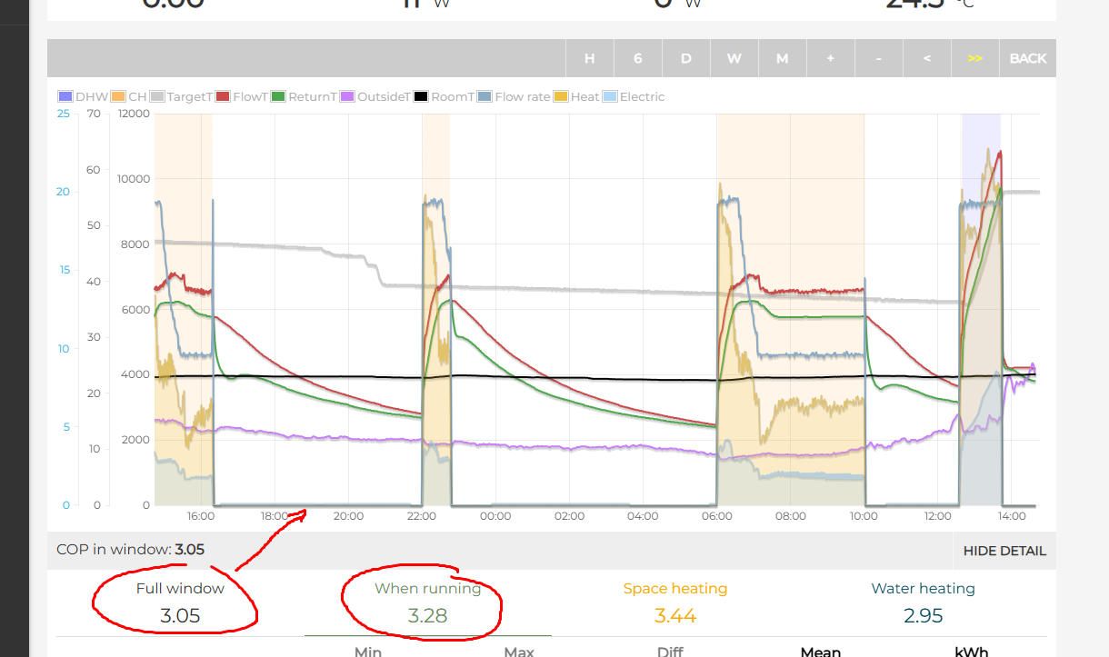

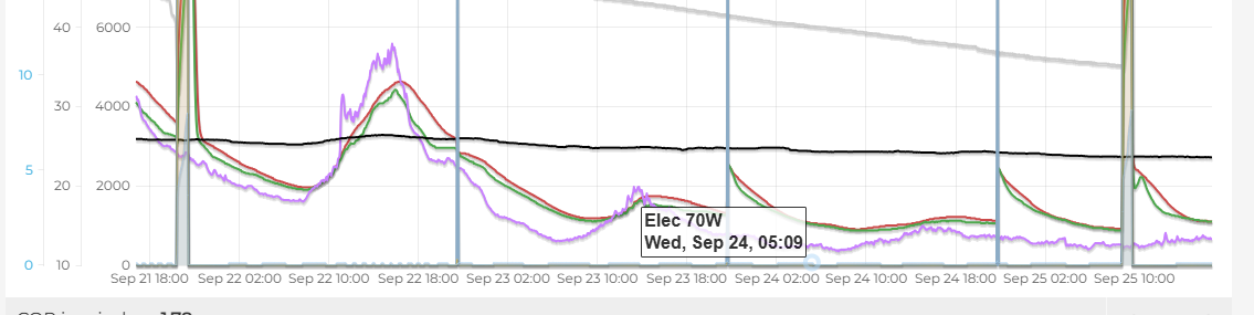

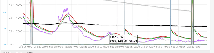

And another thing which driving me nuts with this pump is this 70W pump consumption in case it’s idle for few hours…. pump simply start to consume 70W for something, With Sarah we investigated it is heating some internal compressor stuff or something but why it has to do this in summer lol when there is 20-30C outside. Look at the bottom of the chart at that constant consumption of 70W. Sometimes it drops to 11W when it’s really idle but most of the time is taking 70W and doing nothing. So if the pump is not running the whole day it takes about 2kWh of electricity.
And look here how it crimple COP. From 3.28 to 3.05 average COP fro the last day… Only because of this stupid 70W consumption.

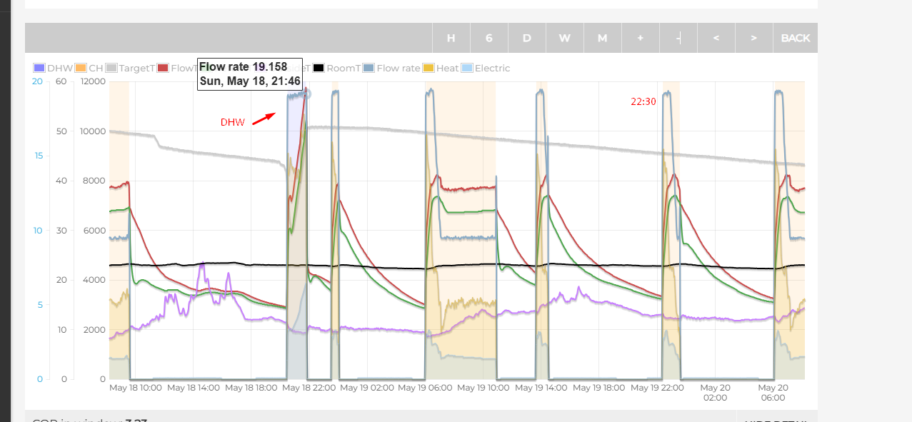

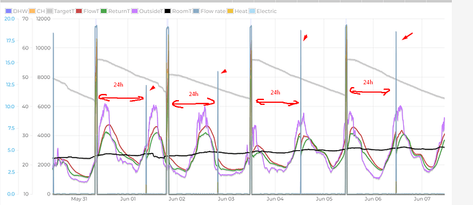

Indeed, that would make sense but that is not how the logic works on my Gen 6 unit. The pump runs AS for 5 mins exactly 24h after the last DHW cycle ended. It does not matter if the heating (and pumps) were running an hour ago, an AS cycle will run if it’s exactly 24h after the last DHW cycle ended.
The system seems to have no knowledge when the pumps last ran - the AS feature seems to only look at when the DHW cycle last ran and ended (at least on my Gen 6). Hence my question, as it’s directly linked to the DHW cycle, will the AS cycle still operate if DHW is disabled.
It seems to be on a countdown timer of 24h that starts whenever a DHW cycle finishes, and nothing can reset that timer other than another DWH cycle ending.

On my Gen 6 unit I do not have DHW enabled, just CH. The AS cycle behaves exactly as expected, if the pump has not run for 24hrs, then it runs for 5 mins-ish.

Look at this. Exactly 24h after DHW cycle finishes.
But there was no space heating between. But if you look here you can see there is no AS cycle running after last DHW cycle. According your opinion it should start AS at ~21:45 the next day but there is nothing and space heating started on 22:30. So in my opinion it is always 24h after the last pump run no matter it is DHW or space heating. I would not seek some sophisticated logic with these Samsung heatpumps :slight_smile:

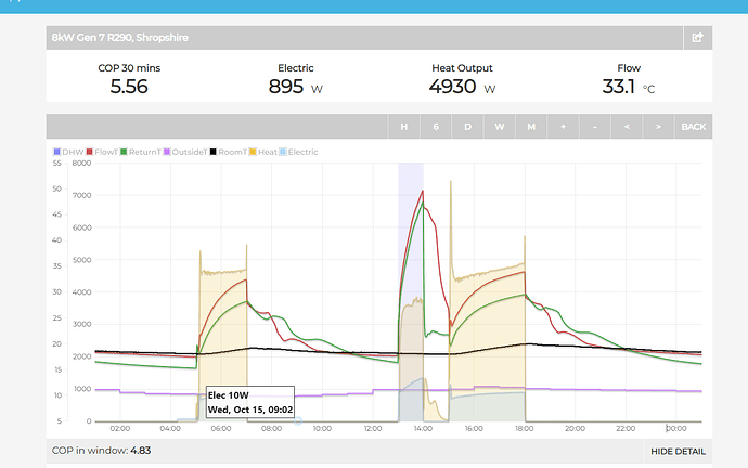

Look at this Gen7 pump, this is completely different story. Look at that smooth modulation. There are no phantom electricity consumption when pump is not running. Also COP from different world when we compare mine.
This first gen HT quiet with R32 is really bad. And I had to buy it. What a luck…

Can you check the flow rate of the circuit during the 70W consumption period, as it sounds like a pump is running, not really a heater (more in the 250ish W).
Cheers
You can see on his charts above that there is no flow during these times.
You’re right! but could there be additional pumps that are taken into account in the global consumption?
Definitely not the water pump since flow is 0 at that time. I have just one pump. With Sarah we have observed some internal compressor temperatures were raising slowly so it must be some small heating element. Maybe it heats oil or something I don’t know. What I know that after a good DHW heating where everything is hot it is not doing this for few hours and then it starts…
