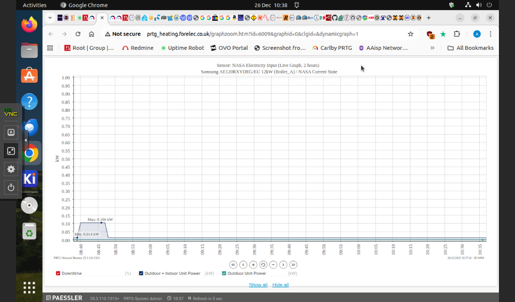

0x8413. This is definitely Outdoor + Indoor Unit power in Watts. If the primary pump is wired to the Indoor Unit it includes pump power as well. This is a graph of a pump anti-seize cycle …..
The standby power is 14w, compared with my MID meter that registers 10w, and this increases to 100w when the primary pump is running. The accuracy at this low standby level will not be particularly good, so I don’t think the difference between 14w and 10w is significant. Anyway, I was quite impressed by how low it is.
0x8411. This is definitely the Outdoor Unit power in Watts. The standby power is zero, impressive again.
