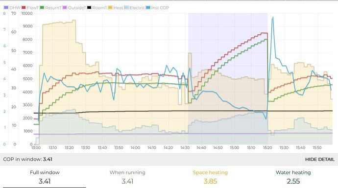

PS Now up to CoP = 3.47 (but still some way from the Samsung-predicted 3.9 for an HTQ at OT 7degC, LWT 45degC)

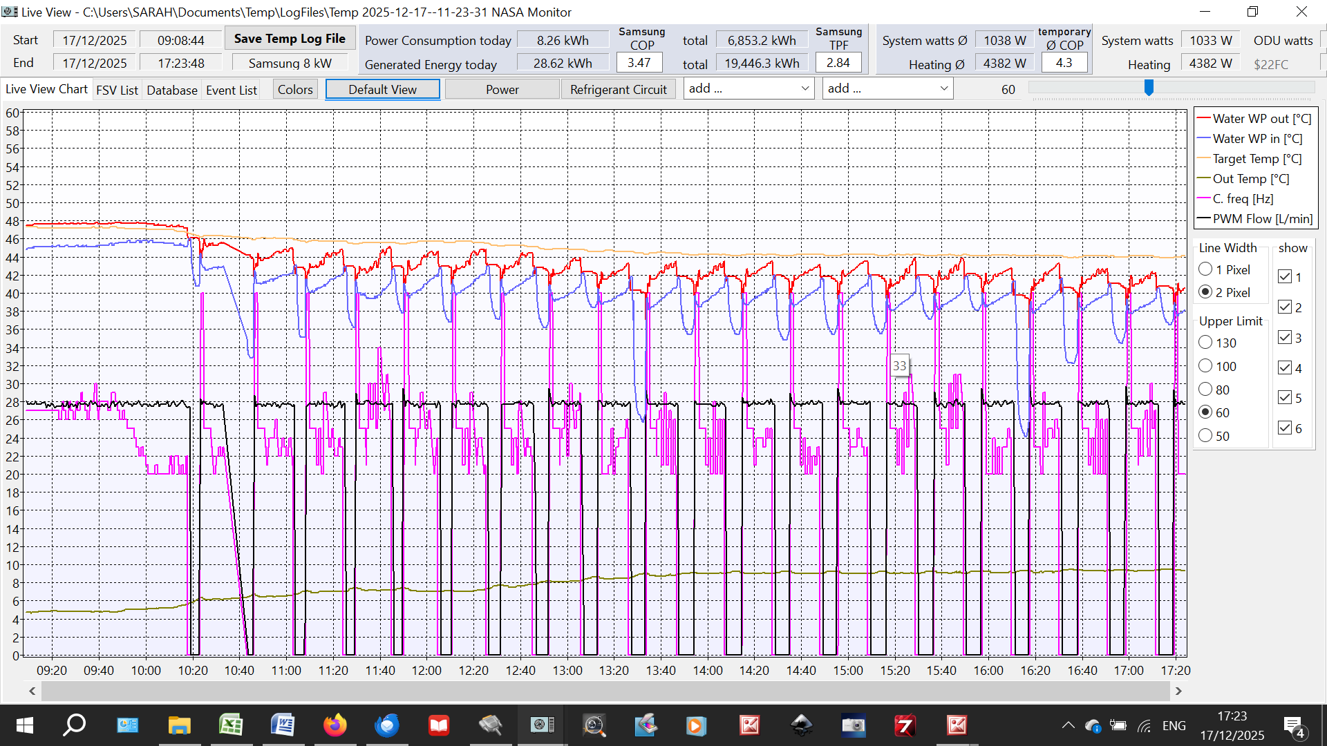

Most wireless roomstats are not well suited to heat pump operation. As you can see from my plots above, I’m getting what would be called short cycling (every 15 minutes) because my roomstat cycle rate is set to 4 per hour, and I don’t think I can set my particular roomstat (a Honeywell T3R) much lower than this (i.e. longer cycle times). The T3R gives a wonderfully constant room temperature, but at the cost of short cycling.
On the other hand, a wired (electro-mechanical) roomstat with a hysteresis of say 1degC wouldn’t switch off the heat pump for an hour or more - it takes a long time for a well-insulated room to cool down by 1degC. But this swing in room temperature isn’t to everyone’s taste.
Nowadays you can buy wired thermostats with adjustable hysteresis, so you can set one that balances your comfort needs with cycle frequency. Maybe your Nest can be taught to emulate a wired controller and give long cycle times with an acceptably low room temperature swing?

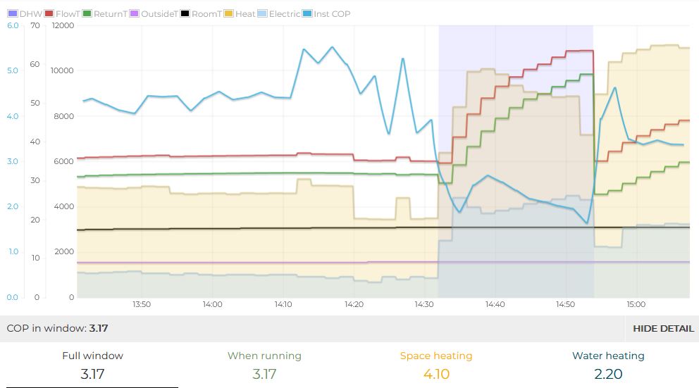

On the cop side, last night with roughly 10 degrees outside and a very low flow temp of 34 degrees circa, 3.2 cop. Unbelievable. Same weather the day before 3.9. I really don’t get it

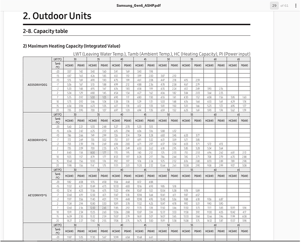

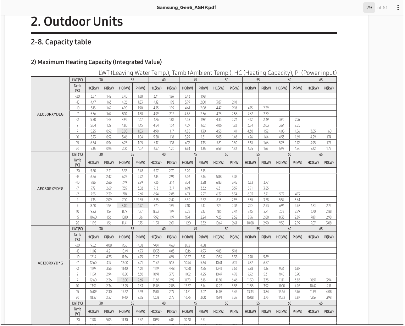

The table you shared is for SCOP values, so seasonally adjusted averages, not at a specific OAT of 2C as is currently the case for you. Of course efficiency will be significantly improved as OAT increases.
I’m looking in the Samsung Technical Data book, at the heating capacity table on page 29.
For your 5kW model, an OAT temp of 2C and flow temp of 40C, it shows a heating capacity output (HC) of 4.54kW for an an input power (HI) of 1.54kW. Dividing one by the other gives an indicative COP of 2.95 under those specific conditions. (Sorry, I don’t have a direct link to the PDF any more)
The performance of my Samsung unit is broadly in line with COPs calculated from this table.
Thanks for providing that @Old_Scientist .
I’m more concerned that today, 1:30 am to 6:30 AM, 10 degrees outside, LWT of circa 34 degrees, COP was on AVG 3.1 Vs 5.something from the table. This is what worries me. What is that I may be doing that wrong.
I believe that the Samsung published performance tables like the one @Old_Scientist included above:
  1. Represent performance at a (synchronous) 50Hz compressor motor inverter frequency. At other compressor speeds the HP to P ratios may differ quite markedly - Samsung will probably have designed for a compressor Best (thermodynamic) Efficiency Point (BEP) at 50Hz. My own data suggest that this falls at lower inverter frequencies, maybe (I suspect) because the circulating seal oil flow doesn’t fall in proportion with the refrigerant, so the compressor has to work harder at lower speeds (per unit of refrigerant shifted) and so consumes more energy. (Data from my own setup suggests that the compressor efficiency at 20Hz may be as much as 20% less than that at 50Hz, though I’ve had to make some big assumptions in this assertion.)
  2. The Samsung tabulated figures are (I am told by Tech Helpline) based on data gathered from their laboratory test rig, and thus represent “ideal” conditions, presumably with calibrated and tested instruments. If your “measured” water deltaT is just 0.5degC in error - one or both of Tw1 or Tw2 are a little bit out - that alone could explain an error of 25% or more in your CoP calculation.
If these potential errors (20% and 25%) are both working against you, you could be actually achieving a CoP of 3.1 x 1.2 x 1.25 = 4.7 which isn’t a country mile from the number in Samsung table.
If you are really worried that your CoP isn’t what it says on the tin, I’d urge you to consider installing a heat meter and a CT - they may cost £500 or more installed unless you do it yourself, but it might put your mind at rest.

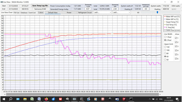

I have the 5kw, by looking at my data, when fullpower, the compressor pushes 47/50Hz, During the last few days, when trying to stay within the LWT of 35 degrees, it was pushing 16/20Hz. What I’m getting is a very low COP of 3.5-ish and I don’t understand why and/or what I should do to work on it. I’ve tried using AI but it drove me crazy with weird stuff and I ended up nowhere.
Things that I’ve seen is that when it starts, max flow rate (22lpm), max frequency (47Hz), Max pump speed 700+RPM and Inv duty 100%
Then it starts slowing down to 9.8lpm, 16Hz, 45% Inv duty.
No Matter what I do with the lockshields, the system comes back to this equilibrium. Even going full open does not change much the results. I dont get it.

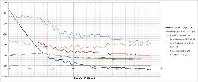

No as well as I’d like. We have three dependent variables (WL target, minimised refrigerant subcool leaving the condenser, and minimised refrigerant superheat leaving the evaporator) but only two independent variables (compressor inverter speed and main EEV %opening), and I don’t know how the controller algorithm deals with this. Out of interest, today’s NASAmonitor nicely shows speed reducing as LWT approaches WL target, but unfortunately it doesn’t pick up EEV position so it’s not easy to see which does what:

Oh, I am confused now. maybe the word “production” is the source of my confusion. My Samsung Gen6 reports heat shifted from the source, not total heat production. If you calculate COP from this (Heat shifted from source/consumption) it will give you the wrong answer. Most of the consumption is used in the compressor and ends up as heat in the working fluid, so the total heat production is (heat shifted + consumption). Therefore, for a Samsung Gen6 at least, COP = (consumption + heat shifted)/consumption. I think @glyn.hudson found this quirk years ago?

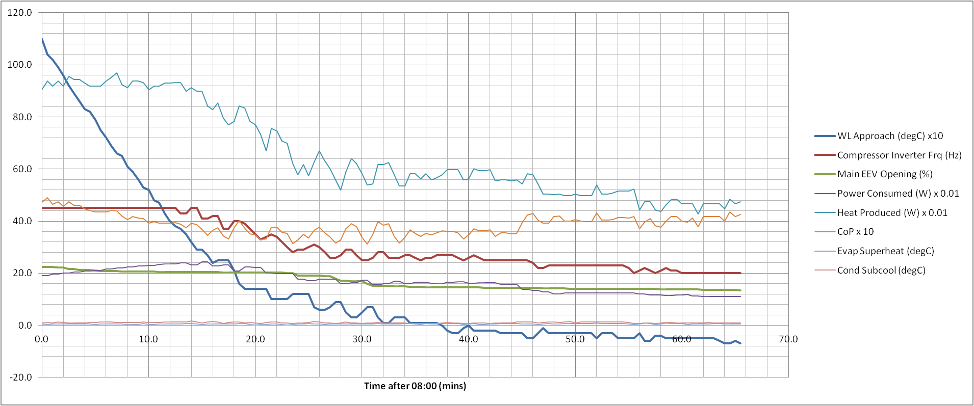

A bit of homework for you, @Old_Scientist.
I used SNET to gather some extra data this morning:
This covers a similar timespan to the NASAmonitor output above, but starting at 08:00. I can see that by that time, two of the three dependent variables had been sorted out, and only WL approach (the dark blue line) needed to be fixed. I’ve shown the two independent variables with thicker lines. But I still can’t really infer much about their control of WL approach. Can you?
If you want the raw data behind this chart, here they are…
07H-59M-27S-EHS MONO LOWTEMP-Trend.xls (246.5 KB)
(Most of the columns are Hidden - just Unhide them if you’d like to see what SNET produces for you if you ask it nicely…)

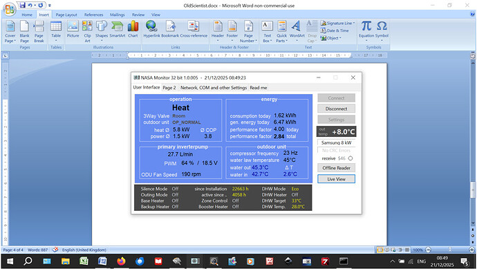

Where are you getting your “heat shifted from source” figure from, @toadhall?
If you are reading NASA registers, presumably 0x4426/7 are based on Q = volumetric water flow x water density x water specific heat x (LWT - RWT). Personally I always make this calculation from its components (rather than reading 0x4426/7) so that I can correctly temperature-compensate density and sp ht (and for all I know, the NASA registers may be based on pure water so may give an error for glycol-based circulating fluid like mine).
As for power consumed, there seems to be some confusion between 0x8411 and 0x8413. Some folk believe that 0x8411 is Outdoor Unit only and 0x8413 is Outdoor + Indoor Units combined (which would be more realistic as the latter would include pump(s) power). If you have your own CT, have you ever compared its output with 0x8411/3?
