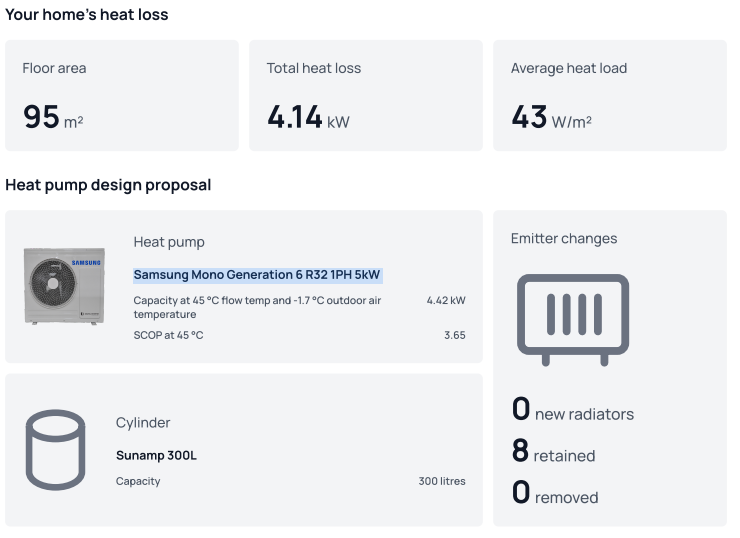

This was the initial heat/loss report

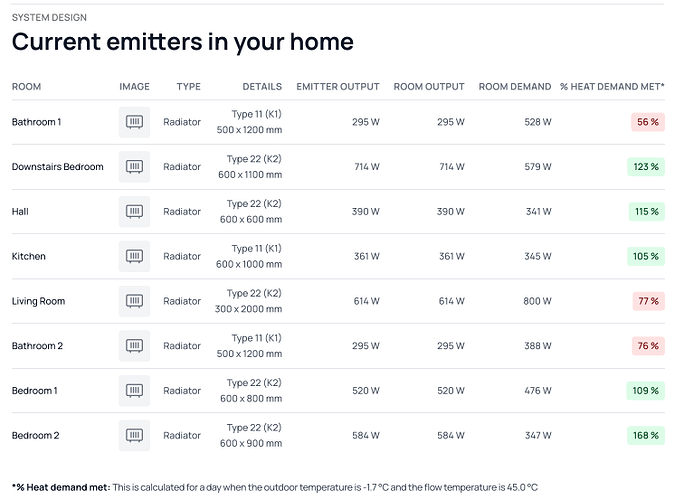

My radiators are as follows
Since the initial report I’ve upgraded the living room to a triple paneled one and the radiator in bathroom 1 has been changed with one that can output circa 530W so barely the room need. To be noted that the bathroom 1 had one of the window closed and isolated so the loss in that room is supposed to be lower now.

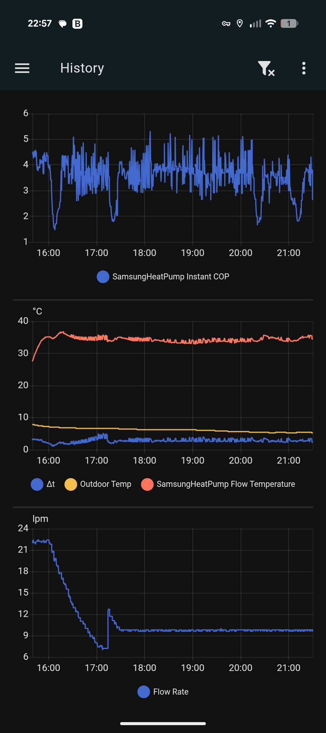

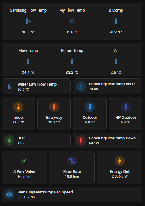

I have built the following dashboard in HA
Samsung flow temp is the flow temp calculated by me as reference using the weather compensation curve above. My flow temp is the weather compensation flow temp using the temperature sensor in the shaded part of my house. The external unit is at the front so when it’s sunny, the temperature registered is not correct so I have designed this dComp value that I push as an offset (-5 to +5) via ESP32 to correct the weather compensation flow temp based on this external temp (Outdoor in the dashboard vs HP outdoor).
Flow temp, return temp and dT are exactly what you are thinking of, taken via ESP32 from the HP. Indoor and Entryway are the temperature of the thermostat (Entryway) and the furthest room from the HP (Indoor).
COP is a calculated value by doing (Energy Out/SamsungHeatPump Power). Flow rate is self explanatory I guess.

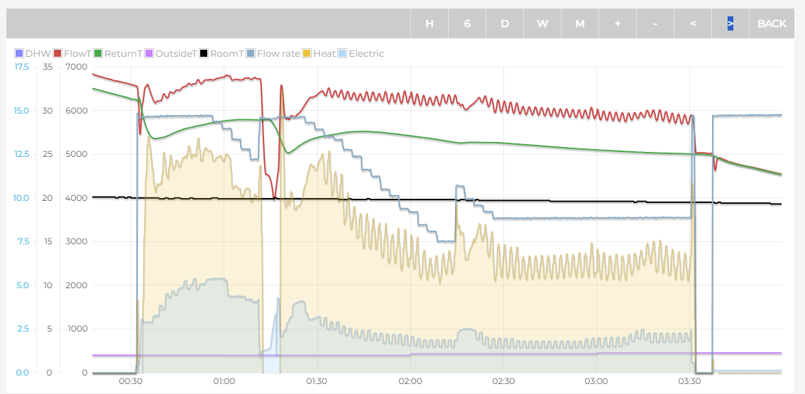

Started the system from cold, after a couple of hours I have the pump running at 56% and flow rate down to 8.6lpm. why is that? I thought it was trying to go for 12/14lpm instead it keeps slowing down. Should I remove more flow restrictions from the lockshields?
Flow temp is supposed to be 36 degrees
It will be slowing down if your dt is less than what you have set as your target dt in #4052. The minimum it will go is 7 lpm, but it often settles higher than this.
It seems like you’re stuck thinking that you should be adjusting the lock shields to control the dt. The lock shields are there to balance your system and ensure heat is being delivered correctly to each radiator. Changes in dt are just a consequence of adjusting the lock shields. Not the reason we do it.
Your heat loss is 4.14kW, so to get 4.14kW with a dt of 5, you need 11.9lpm flow rate. But this is only your design temperature, which is likely around -3 degrees. When it is warmer outside, your flow temperature will reduce because of weather compensation. This means that the output of your radiators reduce. Lets say it’s warmer and you need exactly half the heat loss, 2.07kW. If you maintained the same flow rate, your dt would have to halve, to 2.5, If you wanted to maintain dt5, your flowrate has to halve, to 5.95lpm.
With a flow rate of 8.6lpm and dt of 5, you will still be delivering 2.99kw of heat. So to deliver less heat, the dt also has to drop. To deliver 2.07kW, the dt would have to drop to 3.46.
You can’t have a flow rate of 11.9lpm, a dt of 5 and deliver anything other that 4.14kW of heat. So something has to reduce. Here is the equation: Q(kW) = 0.0698 × Flow(LPM) × ΔT (C).

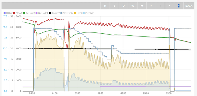

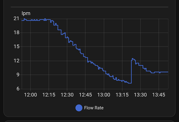

I’ll show you what happens usually.
I’ll paste my flow rate (lpm). Upon startup we are cruising at around 20ish lpm. Then it goes all the way down to 7 something, then a spike up and then settles around 9.6lpm
It is like this every day.

As you could see, my flow rate is definitely variable so the system is able to change it. When running at 9.6lpm (like last night), the pump duty was registering 45% so very conservative.
Is it worth keep opening the lockshields to increase the flow considering that the pump has much more room for increasing the flow rate? Am I under using (damaging) the pump somehow?
I assume that if more flow is needed the pump would just increase the speed, is that right?

This is normal for PWM pumps on Samsung. Look at other on heatpumpmonitor.org.
Look at this one from my system when I was running PWM.
This is because it is trying to increase the dt to match your target dt. The longer the water spends in the radiators, the more time it has to lose heat, so the return is cooler, increasing dt.

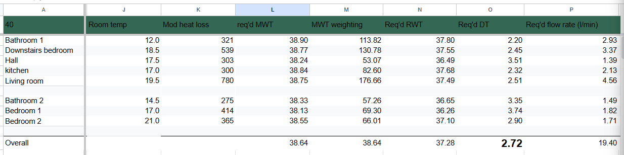

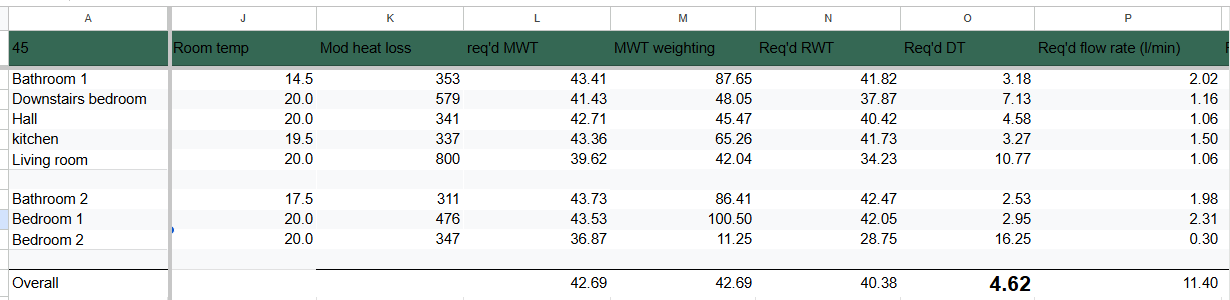

These are the calculations I was running: https://docs.google.com/spreadsheets/d/1Xu_RyPPkYeMDV0U3NpsJyNVBdhWGJyvY/edit?gid=513654403#gid=513654403
I created this calculator a few months ago but have put your figures in. The problem is, that at a flow temp of 40 degrees, you are not able to heat your house enough, even with an extremely low dt which would give your radiators the highest possible output. Radiator output is based on the mean water temperature, not the flow temperature itself.
Here are is the main useful information: At a flow temp of 40 degrees, and assuming a minimum radiator dt of 2, The temperature you will be able to heat each room up to is in column J, with the radiator dt in column O, and flow rate in column P. Of course, heat will flow through the house, so the temperature will even out. But it’s not reaching the anywhere near 20 degrees, and the DTs have to be extremely low, and flow rates really high.
AT 45 degree flow temperature, things look more normal, but your bathrooms are still very cold.
DTs and Flow rates are where we’d expect them to be.
While lower flow temperatures are more efficient, there’s only so low you can go before you under heating your house. Even at 44 degrees, most of your rooms end up under-heated.
