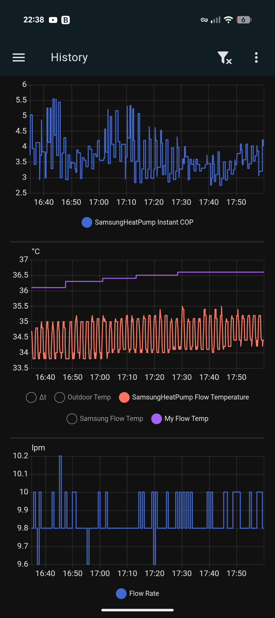

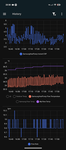

In the meantime I’ve experienced the following today
This is just a couple of hours fragment but after the initial setup the system started going like this.
Basically the purple is the set water temp , the red is the measured water temp. As you can see there"‘s some sinusoidal shape going on with very little variations which when they go up they give me higher cop Vs when they go down that apparently I get a lower cop. Does this mean anything to those more expert?
The flow rate seems to stay in there region of 9.8lpm
I’m happy to hear your opinions on this. Best regards
@bravoleader80 instantaneous CoP calcs are meaningless when based on noisy data like that. If you really need short-term CoP values, I suggest that you recalculate them from hourly averages or, if you want a smoother output, rolling hourly averages.
The rising and falling flow temp is fairly standard for Samsung heat pumps.

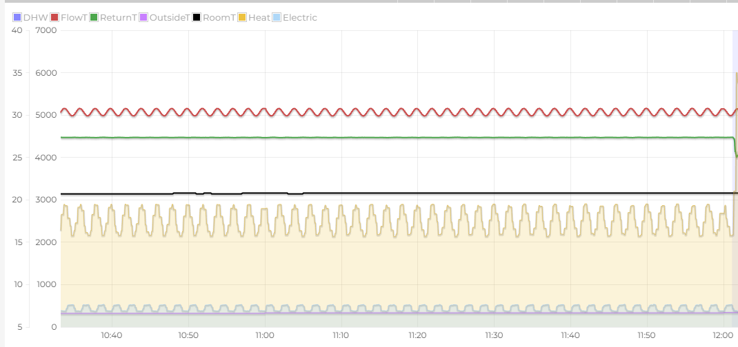

Here’s mine:
Check out more Samsung systems on heatpumpmonitor.org and you’ll see plenty of others doing the same thing.

I’m happy to see this is a standard behaviour but then I don’t get why it’s not always like that. If I should expect the system to behave like this then I don’t get why it not doing this all the time.
Any idea?
The users on here have just put it down to poor control on Samsung’s part. There have been plenty of discussions on the forum about it, but most recently here:

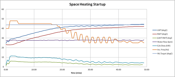

Inspired by @jakeymd1’s plot above, I thought I’d show a recent example of mine (an 8kw HTQ) which shows a few interesting things. This data was collected right after my overnight setback, and are taken from SNET data gathered at 30s intervals:
You can see that:
  • Everything is reasonably smooth until minute ~18, but then as LWT (dark blue line) approaches WL target (grey line, about 3degC delta), the compressor inverter frequency (orange line) starts to oscillate.
  • There is clearly 2- or 3-term control of inverter frequency in the controller algorithm - note that LWT approaches target asymptotically (so as to avoid overshoot) between minute 18 and 40.
  • But this frequency cycling induces a cycle in LWT, hence a cycle in (LWT-RWT) deltaT (green line), hence a cycle in calculated energy output (light blue line). (The water flow rate - purple line - is essentially constant throughout).
  • Once LWT reaches target (around minute 40) things settle down - the inverter frequency becomes almost constant, and as a result so does the energy output (~4kW - close to the Samsung-declared turndown of the 8kW HTQ). I should add that the roomstat was demanding throughout the whole period so was not controlling the process - WL was in control.
  • That the generated energy easily exceeded the nameplate 8kW (maxing at over 10kW) just confirms that Samsung have just de-rated the 14kW unit.
(PS - I’m not pretending that I run an optimised operation. I know I could reduce my LWT and maybe get a lower electricity bill, but I’m happy at £700 per year for a 3-bed detatched, so please don’t throw rocks…)

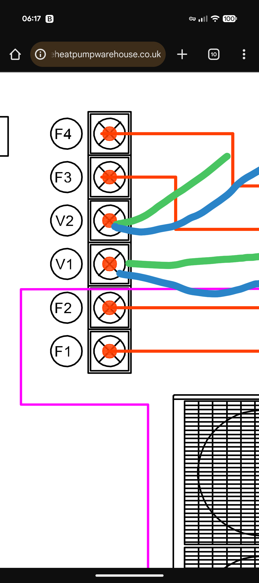

Hi @bravoleader80 I have ESP32 connected to F1 and F2. I have also purchased the Samsung WiFi unit, but I assumed that I would have to choose which device to connect as there is only one 12 volt supply. You have connected both at the same time. Have you had any problems with this and have you any advice that you can give me? How exactly have you wired these two devices?
Many thanks.
Hi @MikeJH .
You know? I’ve never though that the power supply could not be enough. I’m pretty sure they are both connected to the same power terminals. I’m not familiar with the technical terms in English but each + cable is connected to the + terminal and the - to the - terminal. I suppose they are in parallel. They have been working like this for a year now. If you forgive the very bad drawing, with green being the M5 and blue being the WiFi controller. Does it make sense?

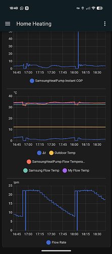

Guys, can anyone explain to me what is happening now?
I’m seeing the compressor stopping every hour (more or less) and restarting with the pump resuming every time from 22lpm like a new start each time.
This has never happened before. The system is not reaching room temp as I’m running it by setting the hot water temp on the Samsung unit (no weather comp) and implementing my own weather compensation.
Any idea what could be triggering this?
