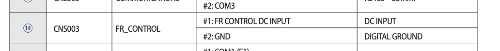

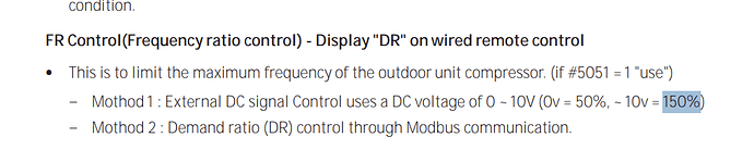

I know this is an old thread @SarahH but have you played with the frequecny control stuff.
0-10v input to the MIM board can control the power from 50-150% (not sure how they get 150%)
If you turn the setting on and don’t connect anything you get 50% throttling out the box

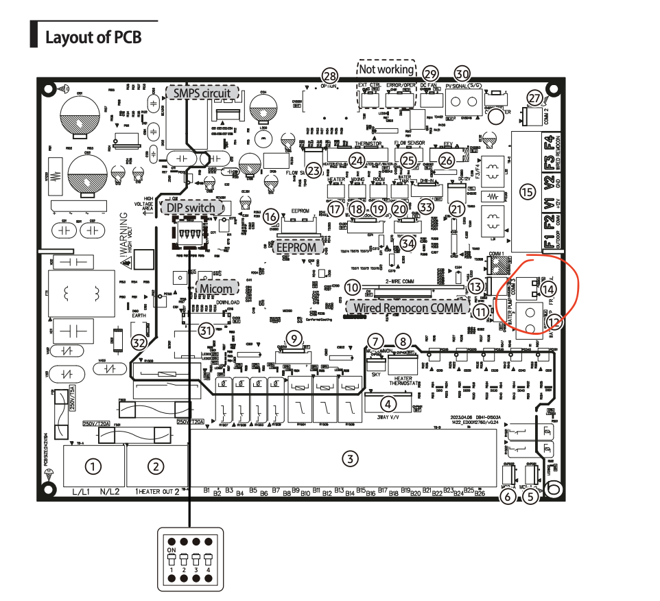

Yeah no worries, I have sorta put the two to mean the same, less compressor power will reduce cycling too esp with DHW

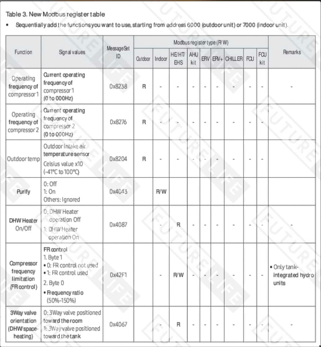

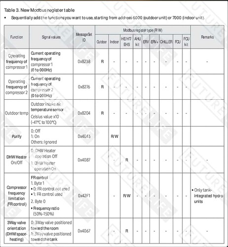

See some screenshots from the MIM installers and user guides.
At first, I was trying to get MODBUS to accept this, having poked around at the registers for too long I found another document online that says this only works if you have the integrated hydro unit that I don’t.

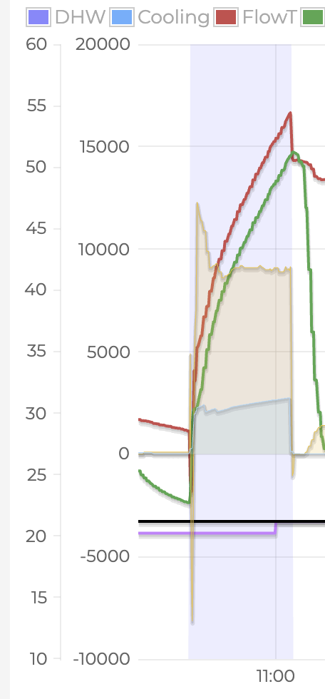

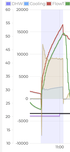

So anyway I turned #5051 to use. And the compressor frequency is capped at 40Hz (or thereabout). I have found this to be a bit lower than the quiet mode, which limits output to about 60%.
By simply turning #5051 to use, and not connecting a wire, you are telling the Unit there is a 0V input, and that will be down at 50% max power. Ideally by setting up some controller to send variable power pins you could go from 50 to 100%. (not sure how you can get 150% unless this is some cheat code :D)

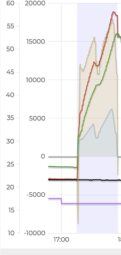

Screenshot with #5051 set to use and 0v

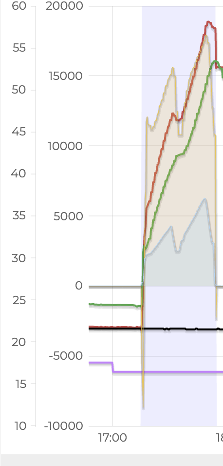

Screenshot of #5051 not used and be turning on quite mode on and off. You can see the power peaked at 18kw. COP was pretty terrible

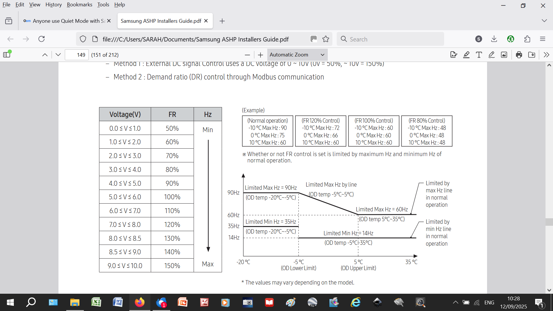

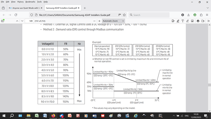

Interesting stuff, @mrsimonbennett, I’d never investigated #5051 before. There’s a bit more info in the Installer’s Manual:
Out of interest, the normal inverter frequency range on my AE080BXYDEG (with FR set to Off) appears to be 20-60Hz, irrespective of ambient temperature. (That’s based on dozens of hour’s SNET-Pro2 output over last winter.) So I find the above diagram rather puzzling, as it suggests that the allowable frequency range varies with ambient temperature.
My data suggest that the compressor BEP lies around 50Hz (i.e. synchronous), and falls off somewhat at higher or lower frequencies. But that conclusion is far from definitive - there’s so much oil circulating with the R32 that the mixture physical properties needed to calculate polytropic efficiency are impossible to estimate without knowing the OCR (which Samsung keep secret, of course).
I was trying to find that diagram to add to my post, but yes I have looked at it many times and been confused by what ie means, like if you set it to FR100% you set the max hz to 60hz no mater teh temp. Does the diagram mean, it will just protect the unit when its cold or does it mean something else?
Like the 120% example shows the max been less than normal operation.
Samsung have an amazing art at making the simple complex
…plus they seem to have employed a school-leaver to translate the manual from Korean…
Yes, that diagram shows that you set the max frequency, but it will be limited by other conditions too (temperature). 120 % max is lower than normal operation because it’s not 120 % of original max value for specific temperature, it’s just 120 % of 60 Hz

I must say I love your findings, I’ve ditched the samsung manual and went toward the reverse engineering side. But I think I misread the part you’ve pinned in this post, concerning 5051 and FR control. I hadn’t checked the 42F1 register just yet.
I do have a question though. I added support for home assistant based configuration. However, when I switch the FR control using 0x42F1 set to 0x0132 (enabled with 50% max). the FSV 5051 0x40A7 register remains set to 0, as if setting enabled to the 42F1 had no impact. should I run some test to see the effect, or had you already went that path?
