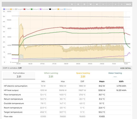

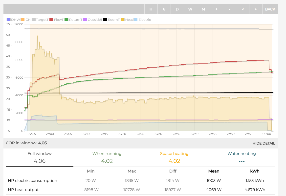

I can see the ramp up to temperature is slower and the compressor is running without any jumps and quickly establish at 22Hz.
COP is pretty good as well! 4.16 during this course of 1h.

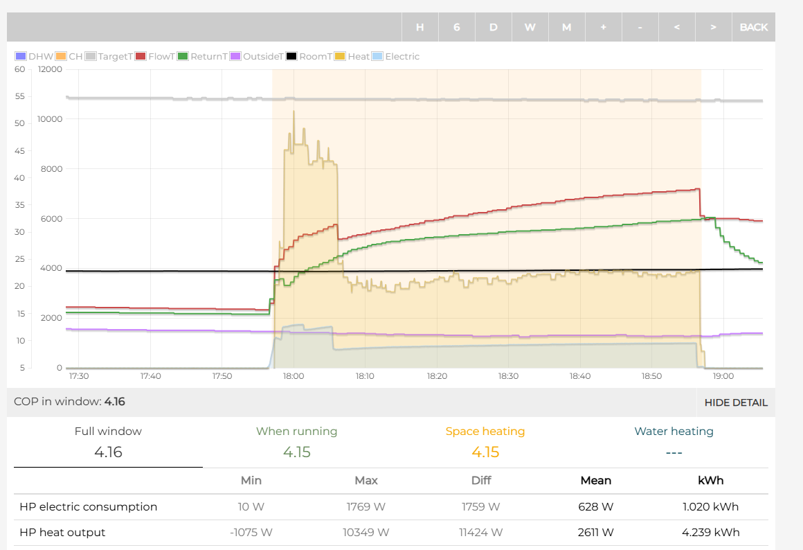

Second run at 10C outside temperature also pretty good.

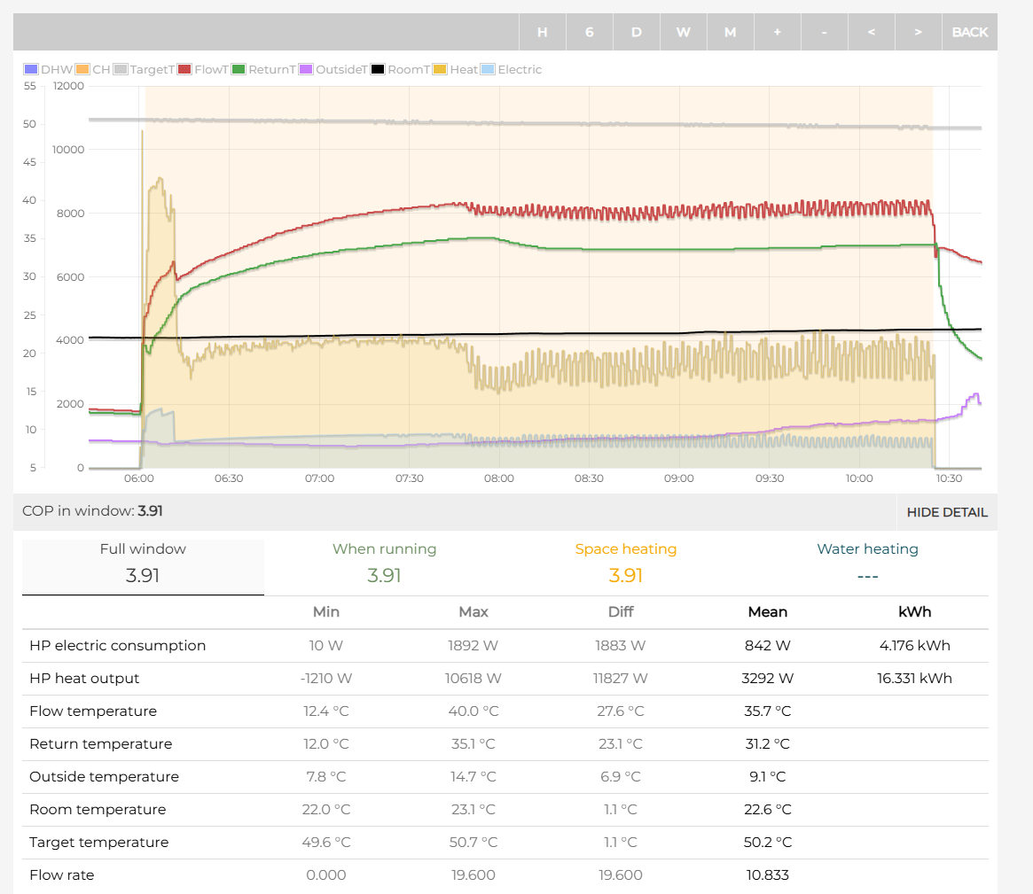

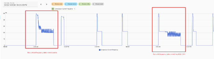

This is one of the run before and the modulation is pretty horrible… After 15 minutes it starts this zig-zag pattern all the way. Every compressor frequency change I can hear every minute when I stay next to the pump. These are definitely suboptimal working conditions.
So let’s see how it will behaves in following cycles but it looks pretty promising. With decreasing outside temperature it can be only better. This also gives me an impression that really my main issue is that the water volume in my circuit is pretty low and with such fast ramp up pump can’t keep with it but why it is doing such zig zag patterns is still unknown to me. Let’s see if FRC will have any impact on this modulation, Iā€˜m curious what will happen if I will be approaching target temperature. Still pretty impressive taking a fact I haven’t changed DR via modbus yet. Adding a buffer tank (volumizer) I think it could really help.
Clearly I see the effect of just enabling it are real!

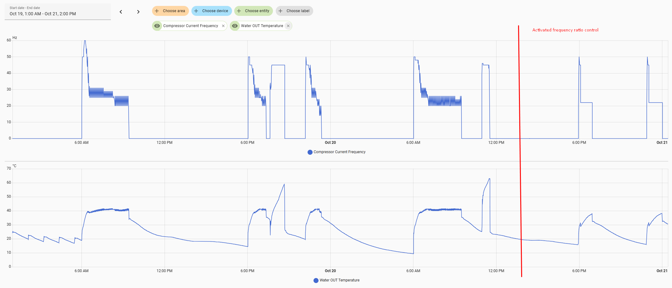

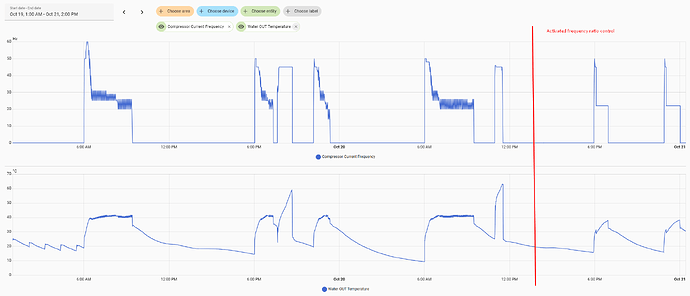

It looked promising at the beginning but it happened what I’ve feared it will happen :slight_smile:
Ramp us is much slower because compressor is capped by 50% or so and the heating process is slower at beginning but with stable COP and heat generation. But as as soon the pump will reach target flow temperature (takes much longer now) the zig-zag pattern and big compressor frequency altering starts again as before.
This is run from this morning.
In this run the pump runs stable for 1h:30m but then again zig-zag pattern started again. The previous day with ratio control disabled it run stable only for 30 minutes. So until the target temperature is reached in both cases. I would really want to know why the the compression frequency is alternating so dramatically. It must have been connected to low water volume but still can’t understand why compressor can’t modulated more smoothly when the target is reached. Why jumps from 20Hz to 14Hz then back to 20 ? Why it is not running constantly at 16Hz for example. This is what I don’t understand with this pump. It is simply too harsh to my liking.
In emoncms it looks like this.
COP is not bad but because of zig-zag modulation pump is not able to reach target flow temp which is 40C. Instead it oscillates between 38C - 40C.
This way pump was running for 4h:30 minutes thanks to the ratio control set to 50%. I’m not convinced that this is good for pump because as Sarah said it can’t work in optimal compressor range. Would be probably more silent but in this weather HTQuiet is pretty silent even at 50Hz compressor. You can hear more FAN than compressor. So at the end it takes longer to reach target temperature which could keep a house a bit colder at the beginning.
I will experiment more with this to see if there is some real benefit but I’d assume at freezing outside temperatures this could be a bit problematic. Would take too long to get into target temp I’m afraid.

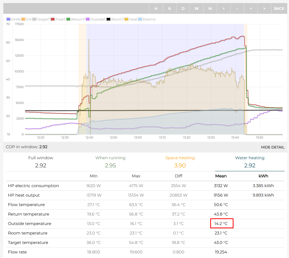

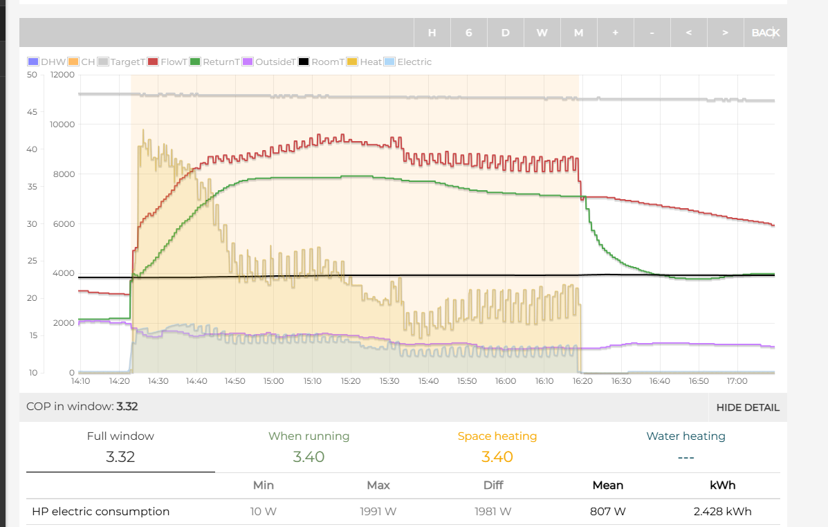

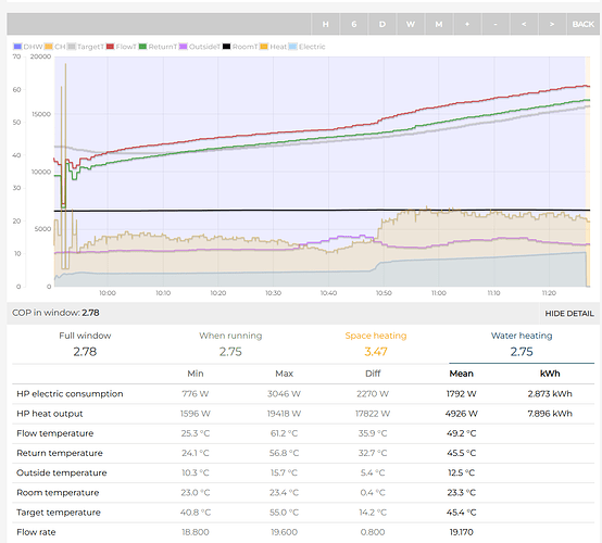

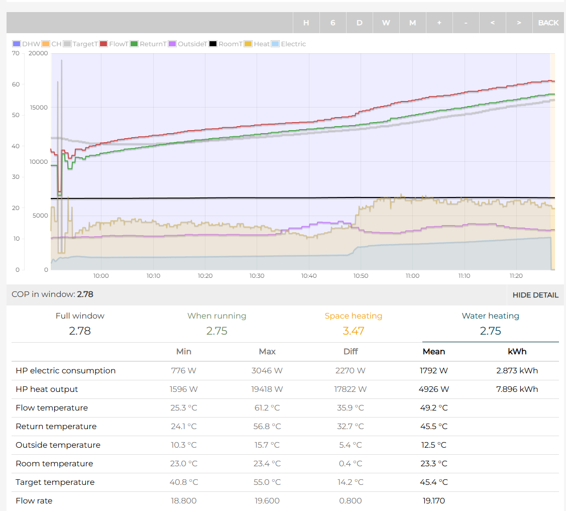

Hi, some comparison of water heating with frequency ratio control enabled and without:
With FRC. Start DHW temperature 42.8C, target 55C. Took 1h:36m. COP [email protected] outside temperature.
Without FRC:
Took 1h:3m from 36C to 55C. COP [email protected] outside temperature.
So I wouldn’t say there is much benefit to use with FRC enabled. It’s much slower to heat and COP is not better sadly.
