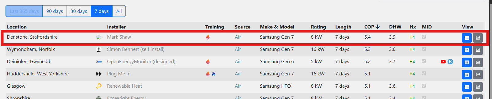

Check out the last couple of weeks on here: HeatpumpMonitor.org
I am top of the COPS for Samsung heat pumps for the last 7 days.

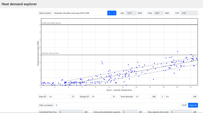

Your heat loss appears to be much lower than 8KW, so you might be able to get away with a much lower flow rate and not have to suffer the temporary noise & high electricity usage of pumping 19lpm at start up.

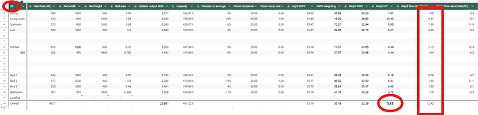

If you know your room-by-room heat loss & radiator specs, you could use this spreadsheet I created to work out the required flow rate to each radiator for a given design flow rate and target DT. The idea, is to adjust the design flow temp in A1 until your overall dt (N18) is close to 5.
You can see in my example, I use a design flow temp of 38 and this gives me a dt of 5.6 and a flow rate of 12.6LPM. I also used this to calculate the ideal dt and flow rate for each radiator and used these values to perfectly balance the system using FRVs. It takes into account the radiator spec and the heat loss of the room. You’ll see, the DT varies a lot from room to room.

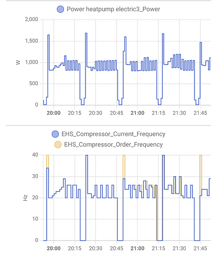

Mine has gone back to jumping the frequency up and down again now it is a little bit cooler.

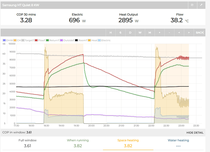

What do you mean it went back to jumping ? Is it doing it again ? Do you have pump on heatpump monitor ? My water pump never goes under 9.6L - this is minimal flow it can achieve. The main problem is that when my target flow temperature is reached and the water pump is running at lowest flow possible which is 9.6l/m then this huge compressor freq oscillation will start. Like the pump is not able to modulate in lower increments, instead it oscillates from 20Hz to 14Hz and then back to 20Hz every minute. It’s really pain to watch especially when I don’t have rational explanation for that. At that drastic compressor change my flow temp will jump from like 40C to 38C then back to 40C… But why ? Why it can’t modulate from 20Hz to 19Hz or 18Hz.. then wait how system reacts and then back to 20Hz… That jumps are simply too big but why ?

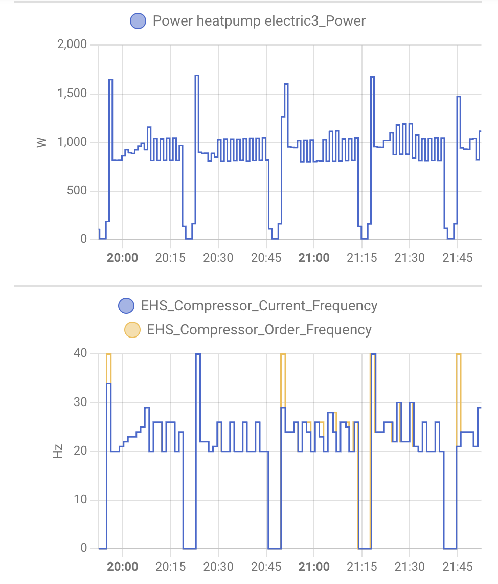

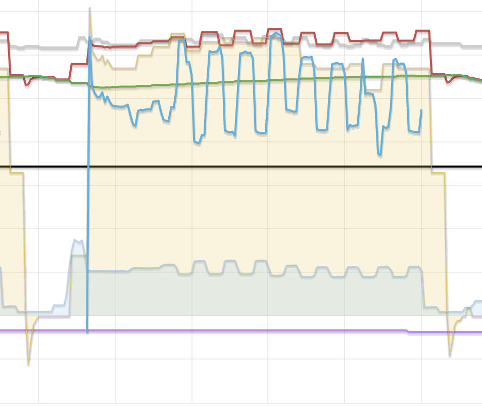

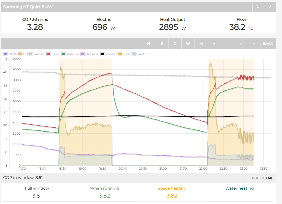

Here you can see few last runs… It’s clear that until desired flow temp is reached (in my case 40C) all is fine but as soon the temp is reached it start to oscillates dramatically. I really don’t call this smooth modulation, instead of decreasing compressor frequency smoothly by 1Hz from 20..19..18..17..16.. and then back up it is doing this. The only explanation could be that probably the compressor can’t run below 20Hz for longer time period but I don’t know if it’s the case.

Thus far, I have not seen any improvements. Still doing what you say with the frequency control/flow temp jumping once at target temp.

Hmm, interesting. Can you post whole graph from emoncms with numbers ? Do you have it online on heatpumpmonitor.org ? It looks like your fluctuates at higher frequency but still the same pattern. Really can’t get it.

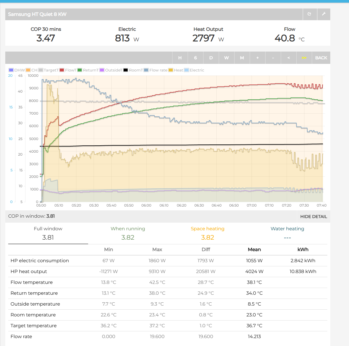

UPDATE: or maybe I don’t understand it at all :slight_smile: Two subsequent runs. First - No fluctuation and the pump was running for 1h:20min. Second run it started fluctuate after 45 minutes but what I did was that I’ve changed pump dT to 8C. Immediately the pump has decreased flow speed aggressively and it started to fluctuate. Next time I guess will disable PWM and let the pump run at 100% to see what happen.

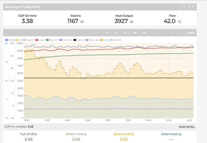

I’ve increased flow temp to 43C for this night and you can see the pump run stable for 2h:20m this time and then again fluctuation started. There were smal dips from 22Hz to 21Hz but after 2h it gave up and again started to modulate erratically changing compressor frequecy by 8Hz from 22Hz to 14Hz which is minimum compressor frequency. I really don’t know why Samsung is doing this. Why doesn’t it modulate smoothly like there is nothing between 22Hz and 14Hz? No explanation for this.
I think the programing logic is simply bad or something and the pump is always chasing LWT very aggressively. Wish I can say do it in more relaxed way.

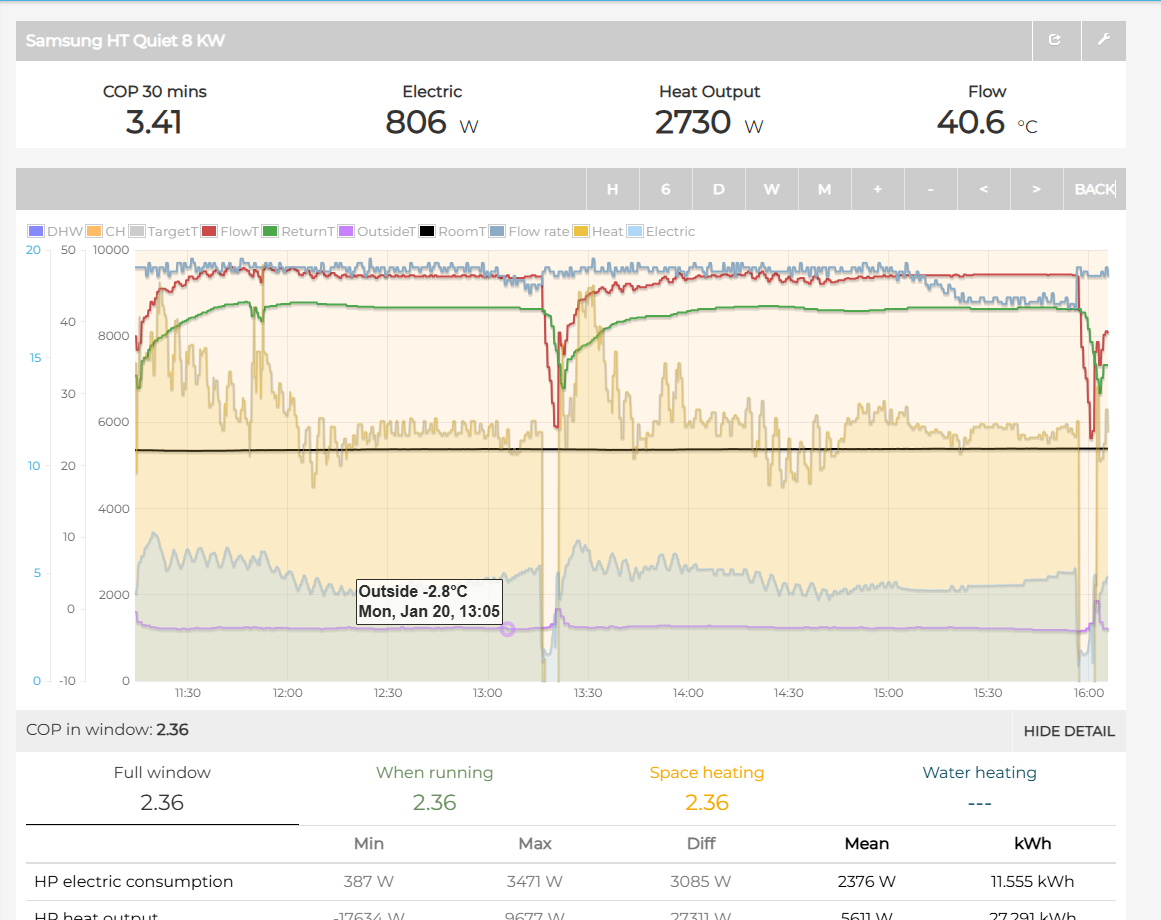

I’ve checked some old records from beginning of the year where it was freezing and the modulation still suck so I guess nothing help this pump. Here you can see it’s stable -2.5C outside and flow is at max. Still, compressor power changes in waves but it’s not that steep. So don’t know think I just give up. Last test I will let the pump run at max. RPMs to see if there is any change how stable the pump is running.
