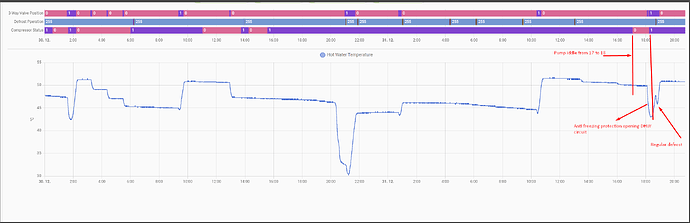

Here what I’ve reheated at 10:00 everything was wasted for “antifrost” protection running at 18:00. 5C wasted from the tank in just a single AFP run. More than 1kWh energy wasted on this. Since I have start to 5C this immediately initiated a reheat. Horrible implementation. When I did not have DHW tank it circulated water through CH circuit and there was no issue. I even didn’t notice it. I’m pretty upset I can’t choose which circuit Samsung should use for this freezing protection. It simply opens DHW circuit for 6 minutes no matter I do. Even with DHW turned off it is doing this. Crazy.

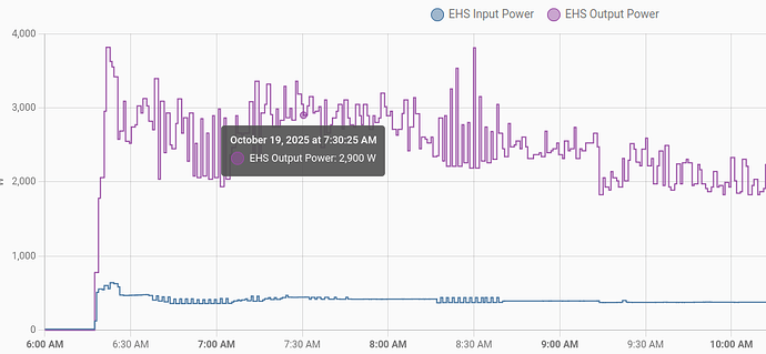

Hi Topaz, interesting findings. Can you tell me more about this Frequency Ratio control? I have an issue that because of low water volume the power consumption at start is pretty high even where there is warmer outside. So it rumps up pretty fast. Wonder if changing this value could help me with COP or stabilize the system more.
The Frequency Ratio (and its actionnable part the Demand Ratio) is a way to cap the compressor input (output is only capped by what it can perform out of the input and the climat conditions and flow temp request).
More info page 149 of the following doc : Samsung EHS install guide
When FSV#5051 is enabled, then, from modbus, you can set nasa message 0x42F1 to adjust the demand ratio, as described in Samsung MIM B19N manual page 18.
From my experiment on my AE050CXYBEK, the demand ratio is applied for both heating, cooling and DHW. Therefore it can be a way to cap a too big heatpump to force a lower capacity, and hence, reach requested flow temperature more slowly => good CoP.
Here is a snapshot of the cycle start overshoot, which is fairly small on my 5kw system.
Cheers
EDIT: ifixed both link sharing properties

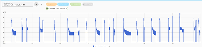

Thanks, so you are capping the compressor max. frequency to 50% all the time ? What if there is a bigger cold outside ?
These are my standard compressor frequencies during heating. Seems 60Hz is the max. and then it drops to ~20Hz.Yo can see it always starts high and then drops to minimum. Do you thing capping to 50% would be beneficial for me as well ?
During DHW heating I often see that compressor is running high but fan spins very slowly. This I can see also with space heating when there is warmer weather outside. In my opinion the pump always starts too high for my water volume and then it overshoot and needs to reduce pump speed rapidly. I don’t know what would be good for my system. But I would prefer the compressor is running lower with the FAN speed at high so it can extract as much heat from air as possible. But if the FAN is barely moving then condenser can hardly extract much. Or maybe I’m missing something.
