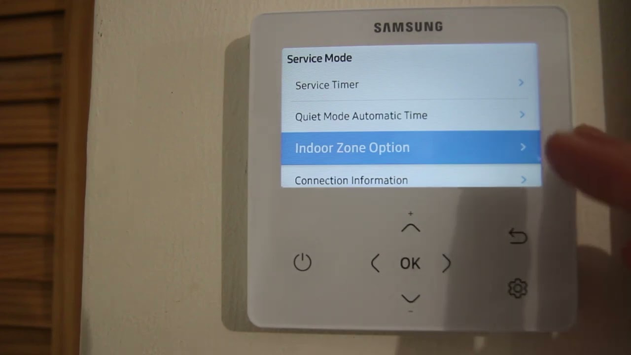

Hello @lukso
Setting a schedule for the DHW reheat is often a good idea. E.g rather than have the heat pump heat up the cylinder straight after the shower, have it wait until 2-3am to do the reheat at that point. Potentially lower tank losses, though perhaps offset by lower COP if it’s colder overnight? In general it’s more efficient to try and heat up the tank after 50-75% of the hot water has been drawn off, rather than lots of short top ups.
FSV 3023 sets how many degrees the tank is allowed to drop before the HP reheats it. The default is 5 degC so the HP will kick in as soon as the tank drops 5C below the set point. I would recommend increasing this to maybe 10C or more? The colder the tank is the better the efficiency of the re-heat will be.
And or setting a daily schedule for DHW as @TrystanLea suggested is also a good idea. When setting a schedule for DWH you have to specify a ON and OFF time as two separate entries.
I would also recommend increasing FSV 3032 which specifies how long a DHW cycle can run before the immersion heater kicks in. The default setting is 20min, I would recommend increasing this to 60 min. If you’re only heating to 45C the immersion should never be required. The HP should be able to heat to 50C/55C no problem without the immersion.
I think you’re looking at the flow temperature? A flow temperature of 56C will result in a tank temperature of about 45C
Here’s a slightly rambly video of the settings I use on my Samsung ASHP:

In my short experience FSV 3023 is actually only DHW setting that matters. All the other 302* values are mostly some kind of user interface limiting parameters.
Right now I have DHW set to 46°C and with 3023 Start temp at 7°C it means it starts reheating at (46 - 7) = 39C.
I tried both DHW ON and ON with hysteresis and haven’t noticed any significant difference. My temp sensor is close to top of the tank and once it shows 39C it gets lukewarm pretty quickly.
When the pump is heating DHW it looks like running full steam ahead no matter what setting I use.
When closing those 46C it is using 2kW with outlet temp 60C and inlet cca 57C. It takes around 30minutes and 1,1kWh to heat our 150l tank. That happens twice a day usually.
I don’t use DHW scheduler as I found it doesn’t take actual temp into account and started reheating even when water temp was near the set temp.

No, I don’t have a max flow temp set. The flow temp during DHW will raise until the tank sensor measures the designed temperature plus overshoot. The smaller the coil in tank the higher the flow temp will need to be to achieve a given tank temperature. Maybe check the position of your tank sensor? And the overshot FSV?
I have my DHW set to 40C (45C on Eco), this results in a max flow temperature of 50C.
Do you know the size of the coil in your tank, and how long is the pipe run?

My DHW tank is not optimized for heat pump, it has only 0.7m2 coil exchanger, rated 9kW. The temp sensor is near the top so when it shows 37C it gets cold quickly…
Is there any way to tell this Samsung pump to not rush that much during DHW?
Which FSV do you call overshot?
Is my calculation correct?
“Samsung weekly Energy Usage shows consumption 12kWh and generation 29kWh. Does it mean COP (29+12)/12 = 3.4? Is it OK for DHW?”
That’s probably why your flow temp needs to go higher. No, not that I’m aware of.
SarahH
(Sarah Hanson)
20
Hi Lukas, I’m new to community so only just seen your post. I have an 8kW Samsung Mono Quiet so not identical but similar.
- As Glyn observed, there is no ASHP flow temp constraint for DHW (unlike the WL settings for CH). So the ASHP winds itself up to a high temp (with consequent high power requirement) until the hot tank temp setpoint is reached. I’ve moaned to Samsung about this to no avail (“no consumer demand for adding such an FSV”). This may be because most folk have DHW on 24/7 and the few minute’s top up takes hardly any power.
- Samsung advise at least 2m2 coil area (pref 3m2) for 8kW unit to limit this temp wind-up, so your 0.7m2 explains the high power you see. I have 0.9m2 (I retained my old tank) but as I only enable DHW 2 days per week I can’t justify a new tank/coil.
- I mitigate the high power during DHW demand by splitting scheduled heating time (2 x 15min bursts with 15min in between). This drops peak power demand by ~50% by giving the tank chance to convect some heat.
- You really need the tank temp sensor near the bottom, otherwise most of the tank will not be heated.
- Unless I misunderstand your numbers, your DHW CoP is simply 29/12 = 2.4 (not the 3.4 you posted). But happy to be re-educated…
