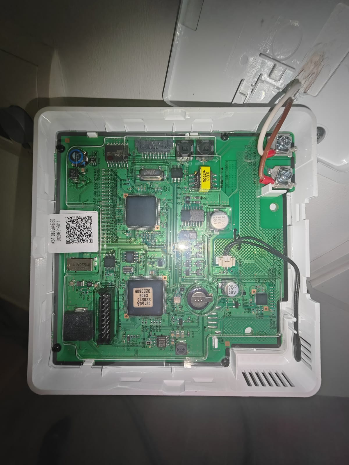

Hi Glyn, when I select indoor on MWR-WW10N, Im getting error E121. Power on and off dont solve it. Do you know what can be the reason?
Hello Michal.
The manual says “short- or open-circuit error of the room temperature sensor of the Zone 1 indoor unit” (i.e. a faulty roomstat). Might this make sense?
Sarah
Hi Sarah,
Yes, I have seen that in manual, but I thought sensor is internal in the panel? Glen YT video was suggesting that and my gas heater panel is like that. Maybe some more settings have to be change before #2091 and #2092 before enabling indoor sensor.
As I understand things :upside_down_face: there is a roomstat in the controller remote display, and if your installer located this somewhere useful like your living room, then you would set FSV 2091/2 to 0, and programme your room temp on the remote display. If the display is elsewhere (mine was put in my utility room - OK for access, but no good for living room temperature control - then a remote roomstat is required, with 2091 (if WL1 is used) or 2092 (if WL2 is used) set to “Use” with one of the codes for using weather comp or not.
There are potential problems with using a TPI wireless remote roomstat (see above and other threads) but otherwise the remote roomstat setup works fine (unless it is faulty of course…)
The installer is me :wink: and this is not my daily job but I’m electrical engineer and just came to same conclusion as you, panel is placed in my dinner next to gas heater panel. I’m just playing with setting as I use it for DHW now and it will be few months before I switch it on for floor heating. FSV 2091 and 2092 have separate input for thermostat in heat pump, so can`t be related to panel thermostat I tested it anyway and alarm came again when switched control mode.

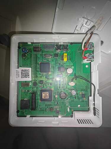

Mmm I’ve not seen that before, that sounds like a possible faulty LCD touch controller. The sensor should be inside the controller, unless you’ve connected an external sensor. Could you share a photo of your main control board?
Hi Glyn,
Looks like temperature sensor is connected.

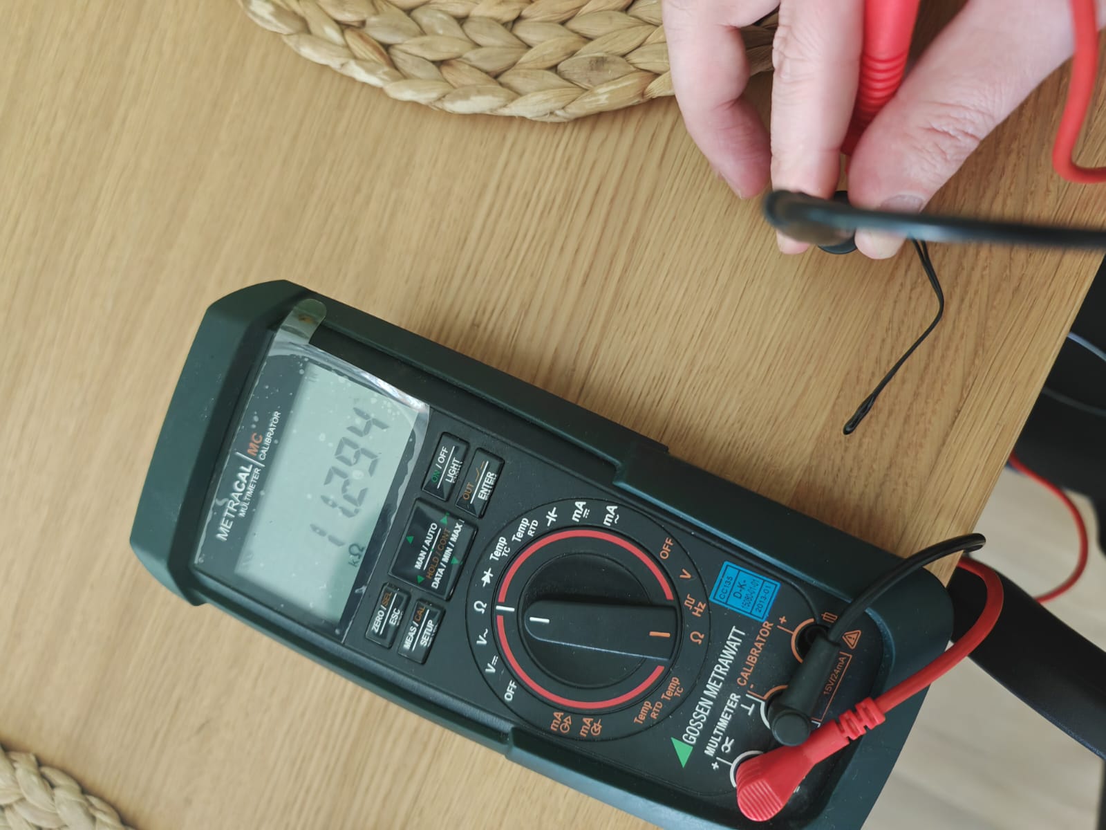

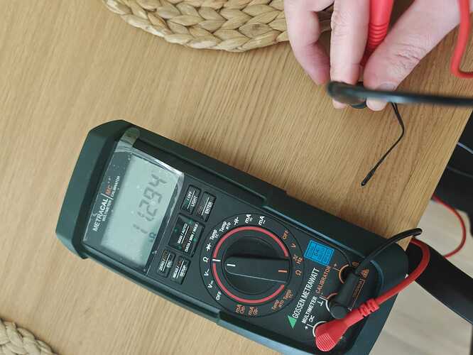

That’s cool. Can you measure the resistance across it? It should change with temperature.
Could you share a photo of your main controller board? Do you have any additional temp sensors connected to it? You should just have a DHW tank sensor.
I measured 11,3kOhm with 23deg C. I think this is correct for NTC sensor with this temp. I have only DHW tank sensor (blue wire) with works fine.

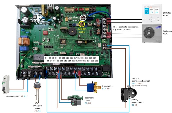

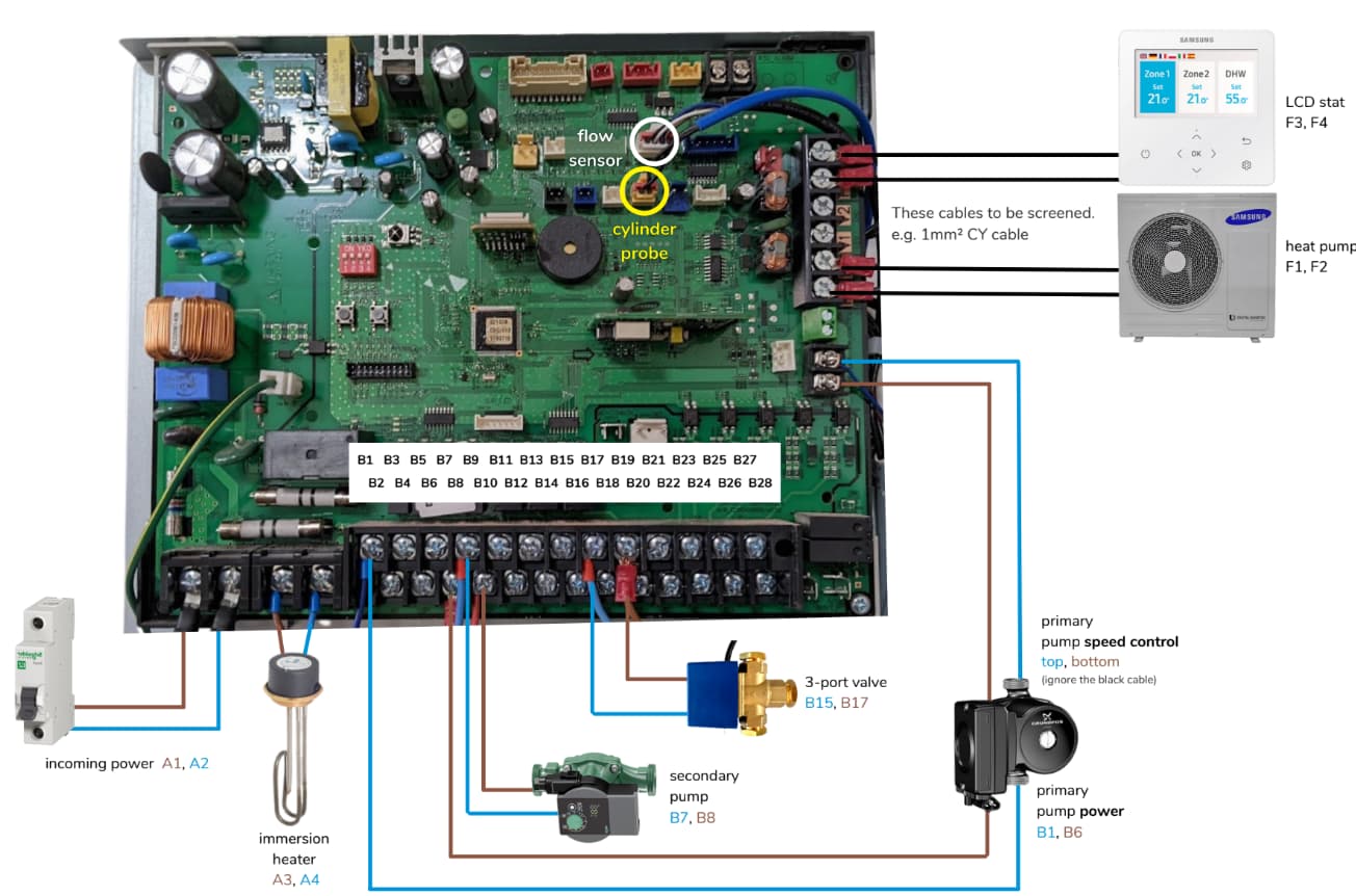

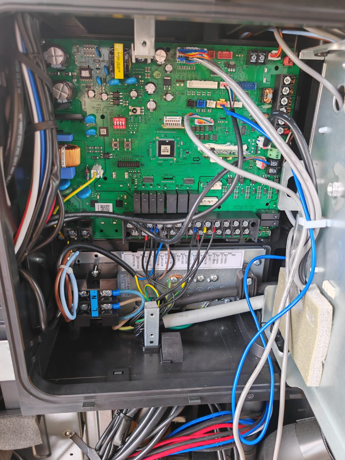

How is your LCD touch controller connected to your main PCB? I see the F3/F4 connections are not connnected. This is what the wiring diagram for my Gen6 looks like, the touch controller is connected to F3/F4:
Yes, you are correct the the controller is connected to F3/F4. Picture was taken before I completed connections and on the begining I connected it wrongly to F1/F2. The unit main pump is originally connected to B7/B8 and my excising pump (after buffer tank) is not PWM so I connected it together only as signal output to relay with is controlled by 3 port valve signal so it`s enabling signal only if DHW circuit is not running. This pump is controlled by gas boiler/heater and heat pump signal via integrator. I have also B4/B5 connected as gas heater start signal set up from -15 deg C.
Ah right, that makes sense.

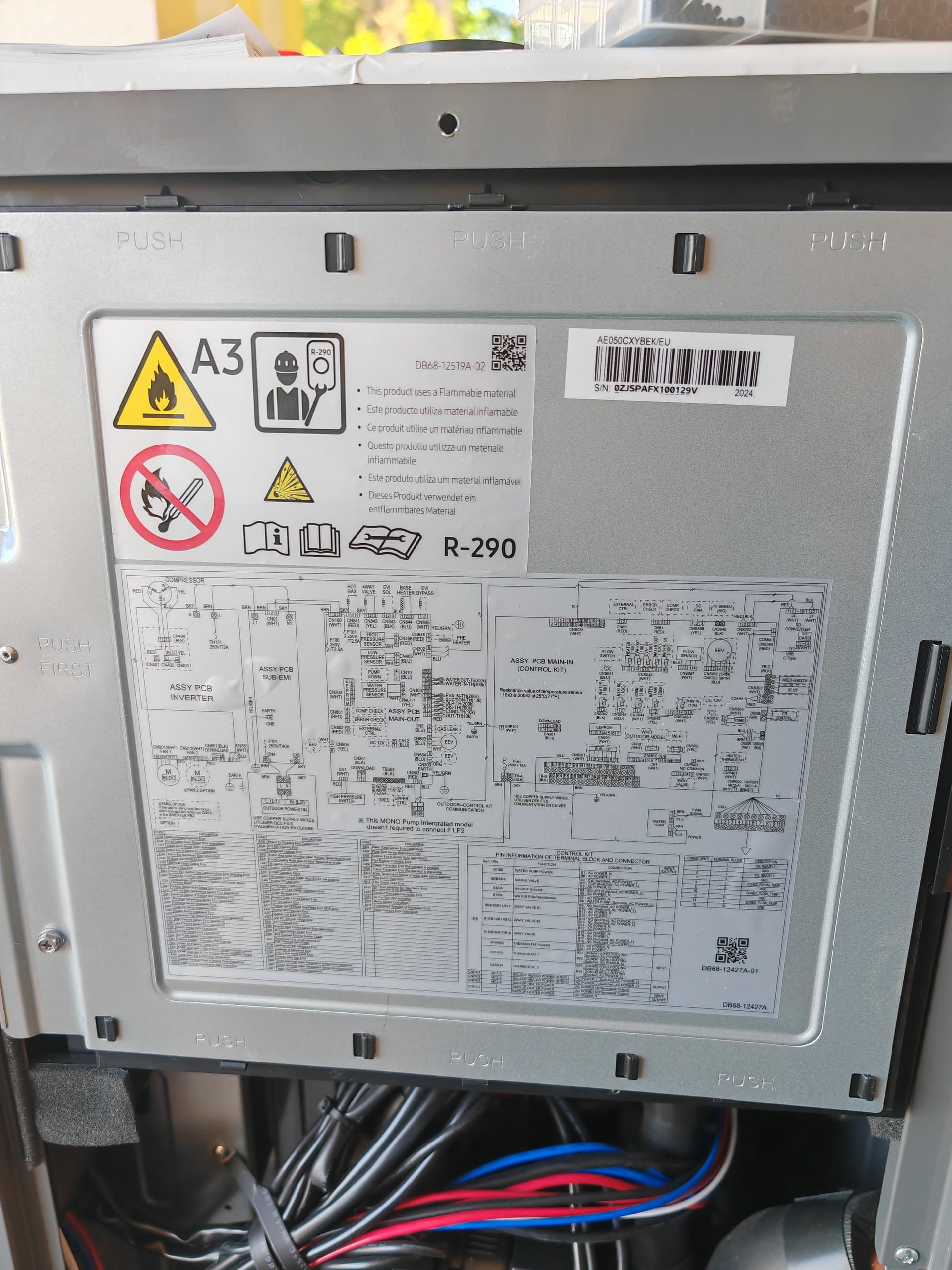

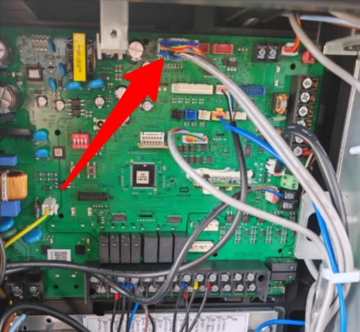

What’s are these connectors? I don’t have anything connected here on my system, and the UK install manual does not even label this connector
Samsung-EHS-mono-5kw-settings-Hardware-Heatpump-OpenEnergyMonitor-Community
There is front PCB and it looks like is connection CNS051 to terminal in front SG Ready and zone room temp. but I don’t have nothing connected to it.
Ah interesting, I don’t have a front PCB on my system. Is yours some sort of all-in-one integrated indoor unit?
If you’re not using it, you could try unplugging it? It may be interfering with you using the indoor touch controller as the main thermostat
Yes, It have everything inside: flow meter, pump, safety valve etc. I got in touch with local Samsung heat pumps installer (listed on Samsung website) to get my guarantee validate, I will check with him first.
