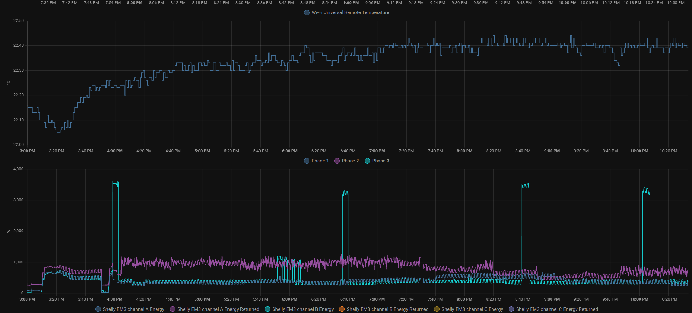

I’ve set it to indoor thermostat but during this evening there was from 9C to 6C outside and it’s running stable at the lowest compressor speed consuming around 0.8KW which is big improvement. Water outlet temperature at 9C was 37C and at 6C 38C. Indoor temperature 22.6C.
So seems it can modulate pretty fine now. Flow is 9.6 l/m. Without PWM regulation flow would be 16 l/m and dT very low so heatpump would probably switch off.
That’s only 4kW continuous, therefore your heat pump is very oversized, but this does mean that your current pump with max 16L min might be fine.
