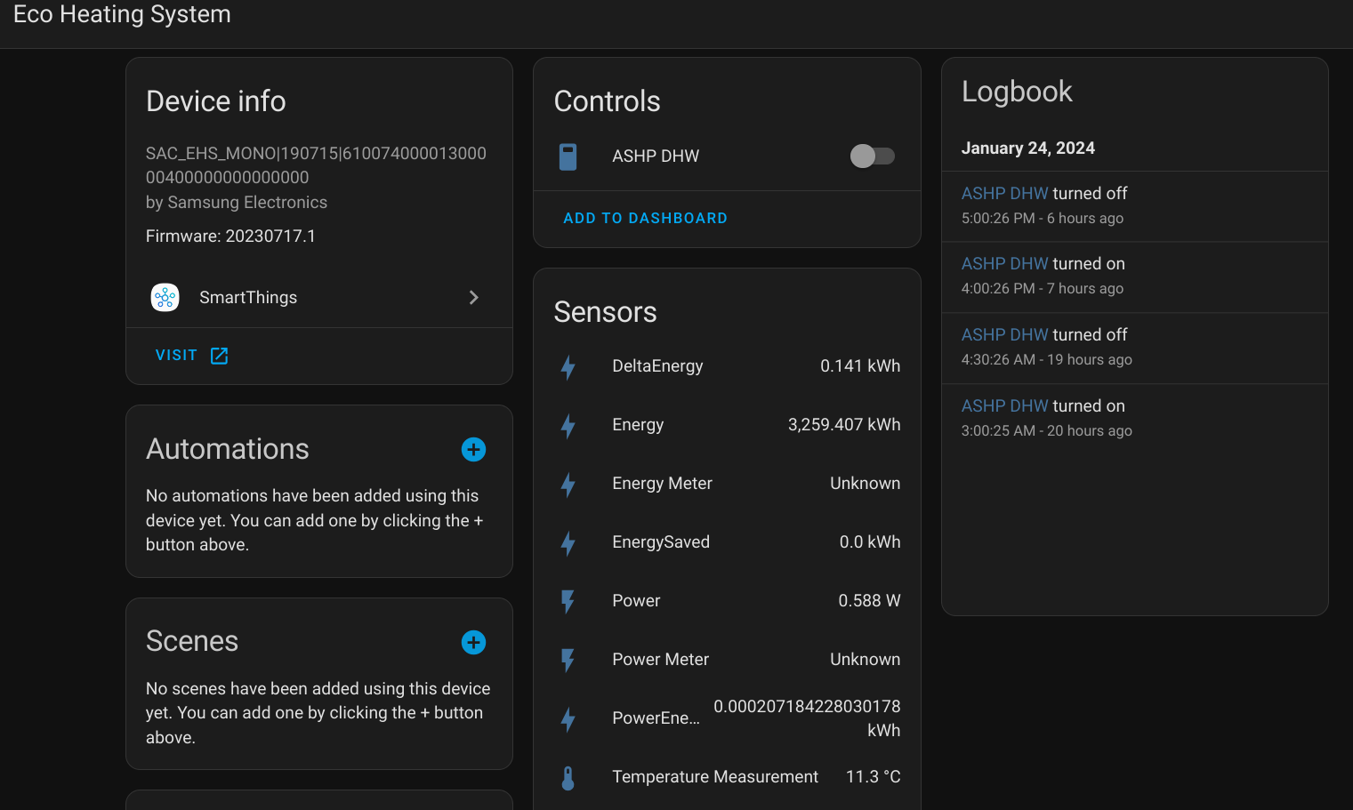

Hey Glyn, how I can connect Samsung WIFI gateway to home assistant? I’ve tried to search for new devices but it didn’t find it ? Thx
You can use the SmartThings integration to connect the Samsung WiFi to Home Assistant. However, the integration is very poor, only DHW on/off controls are available. I don’t really use it.
The Samsung SmartThings app is very basic but useful to adjust set point and turn on/off ā€˜away’ mode when going on holiday
Enabling ā€˜quite’ mode will slow down DHW as this limits the max compressor speed.

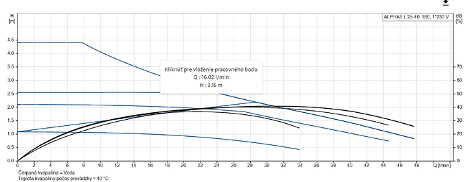

I’ve just noticed they’ve installed Grundfos 25-40 !!! Not 25-60 as I’ve thought… I think that’s why I have such poor flow rate. What do you think Ian? I don’t know why I thought it’s 25-60.

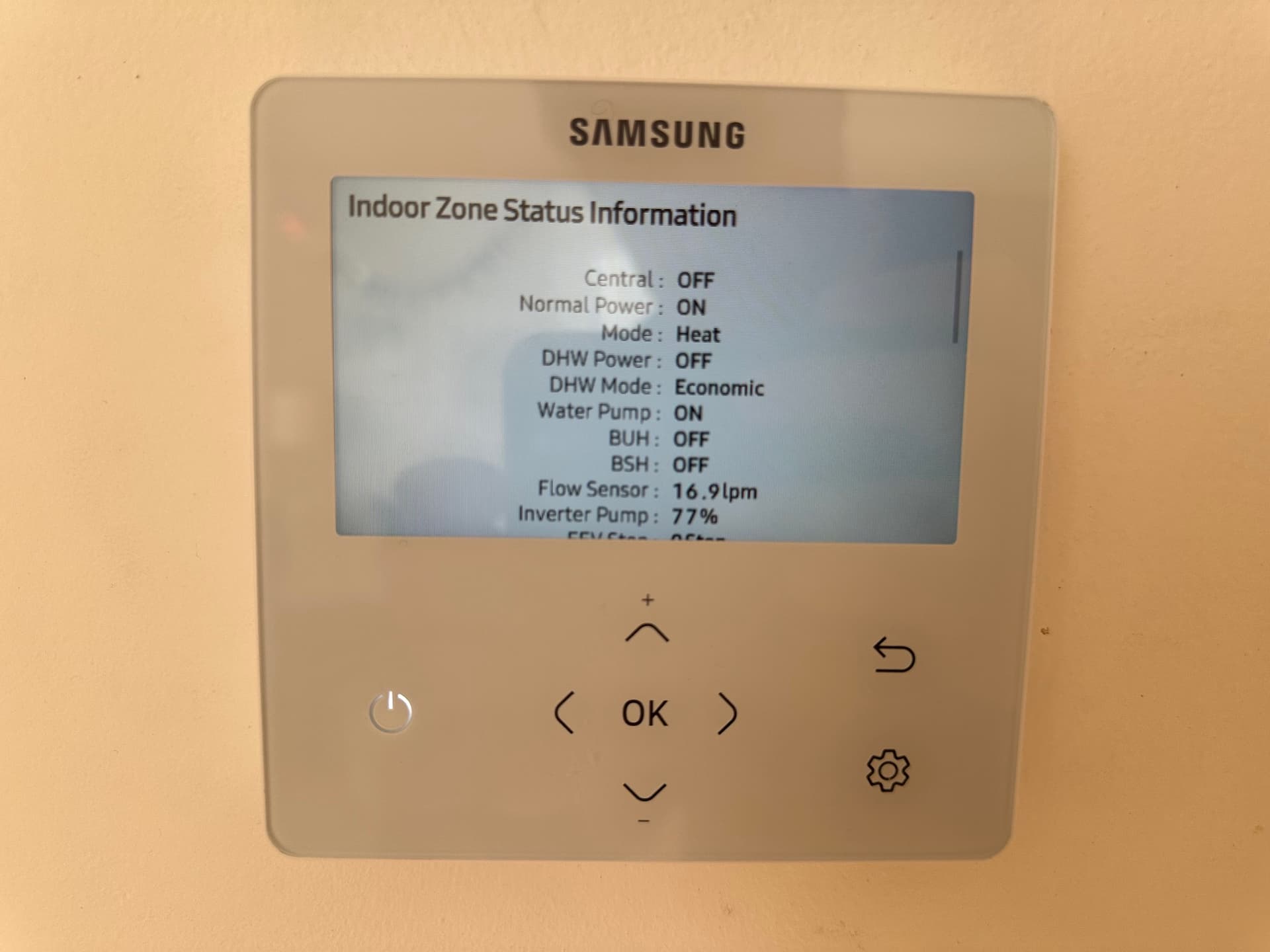

Guys tell me if I’m dreaming or what. So by accident I’ve found out that if you go to self-test settings to e.g. watch your LWT and RWT then guess what? The PUMP will shut down!!! (because it automatically set pump to OFF) So then I can wonder why the pump shuts down after a while! OMG. Who implemented this ? Once you go out from self test menu, it start working again but this means you can’t watch inlet and outlet temperatures! Well you can switch pump ā€œONā€ in self test menu but this will put your PWM pump on MAX. SPEED, resp. the last fixed value which has been set on the pump. So monitoring temperatures makes no sense. Jeeeeesus Christ, tell me this is not a truth.
Sorry guys, I know I’m a bit boring but I’m really out of ideas.
It seems that PWM regulation does not work a bit. Now the HP is able to turn off the pump off and on but seems that speed control does not work at all. If you look at these two pictures you can see that HP requested to lower the speed but pump completely ignores it. At 77% is bigger than it was at 93%. All circuits are fully open. Do you know if I need to setup besides just connecting the PWM cable from pump to HP ?
EDIT:
Seems now it decreased the speed but only if inverter pump was below 70% or so. Now it is at 58% and shows 13.9 l/s flow rate. Do you know how the pump determine maximum and minimum speed of the pump when it is only sending signals and not receive ? Don’t understand if HP does not have a terminal for output signal from the pump. I thought that it will somehow determine the max. flow when it is on 100% and then decrease to 0 where 0% is no flow of pump. If anyone can explain how this PWM works exactly I would be glad. Now it is at 54% showing 13.3l/s so seems it’s doing something. Dos it mean that 1% is minimum flow rate of the pump which is 7 l/s ?

thats actually good news. that means the system is running only about 3.2m head at the moment. So , if you get a normal 8m head pump (something 25-80) that should be able to get the flow rate you need. you need a curve with at least 6.1m head at 1.4m3/h (thats 24 l/min).

don’t worry about exactly what the PWM % number says. if its varying the flow rate, its working. you can alter the target DT which affects target flow rate but given the pump and emitter issues on your system I wouldn’t mess with that value yet.

PWM works but seems it starts lower down only from 75% and below. Don’t know why. Do you know what is the control factor in pump settings ? I have set it to 2.
But now I guess the main problem is the weak water pump. They’ve installed 25-40 and not 25-60. So characteristic +/- match. 16L at 3.3m which is height of my radiators on the 2nd floor.
So now we can assume this pump is really not sufficient, can’t we ? 25-60 should be sufficient:
Much higher flow at that height. What do you think ? Not sure what exact issues this will solve but I know that the HP always asks for more flow when I start it since it shows 100% at 16 l/m. How much more I have no idea but could be easily over 20. That way it could heat more efficiently since it takes some time until water in the system gets to the temperature.

please, its getting a little bit frustrating. I did say all these things before:
  • height of radiators is irrelevant.
  • you need about 6.1m pump head meaning at least an 80 pump will be required. I thought before you needed something like a 120 (because you said you have 60) but now that you said you have a 40, then the maths tells me an 80 is enough (as per previous message). 60 will not be enough, it only has 4.5m head at 24l/min, you can see it in the graph you copied above.
  • control factor is a PWM/DT tuning. don’t mess with PWM / DT tuning until the pump is sorted,
if you can get more flow and achieve the flow rate that your HP needs, 100% flow will be a larger litre/min number. system will startup faster, it will be able to achieve full power output.
