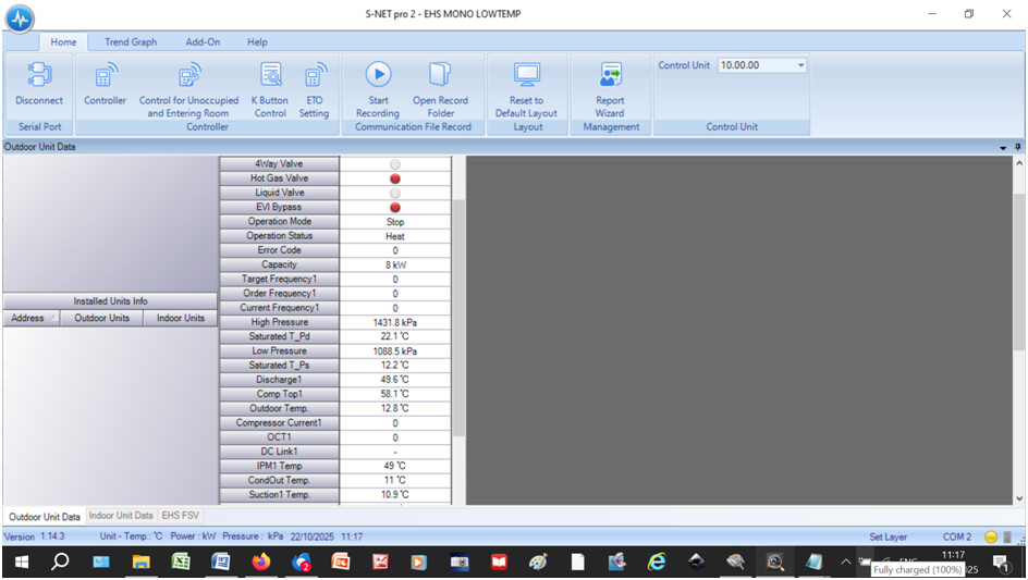

I have an 8kW HTQ series heat pump, for which the SNET display (Outdoor Unit Data tab) looks like this:
I wanted to insert a field for the Outdoor Unit Power Consumption (in W) between the IPM1 Temp field and the CondOut Temp field.

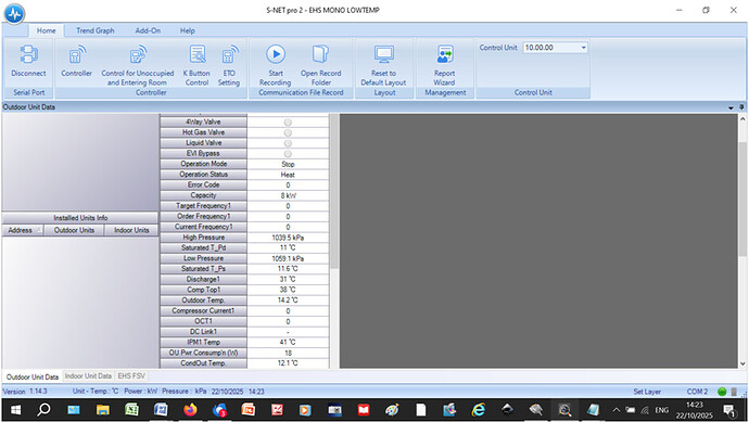

So to add my Outdoor Unit Power Consumption field, I need to:
  • Obtain the correct message number for this variable from the NASA codes list (it is 0x8413) and confirm that it appears in the NASA.ptc subset of permitted entries (it is, with the label LVAR_OUT_CONTROL_WATTMETER_1W_1MIN_SUM).
  • Edit the EHS Mono Lowtemp.dis file by adding an additional programme block between the IPM1 Temp block and the CondOut Temp block (which is where I want the new field to appear):
Column ProtocolID=“LVAR_OUT_CONTROL_WATTMETER_1W_1MIN_SUM”
    Name
      String>OU Pwr Consump'n (W)</String>
    /Name
  /Column
The String can be any meaningful name for your new field. The reason that I added “(W)” to it is because SNET only recognises a limited number of measurement units – “kW” is recognised but “W” is not, and any displayed value would have no units.

Although 0x8413 contains the value in W, the above code would result in SNET displaying kW (with a single decimal place), when I really want the extra precision of W. So I need to edit this block by replacing the kW with W and (for simplicity) replacing the 1000.0 with 1.0.
Having made these modifications in my text editor, I need to save the two files back to their original locations. However Samsung have placed access restrictions on them, which must be removed before saving. This is straightforward (at least on Windows PCs):
  • In File Manager, navigate to NASA.ptc
  • Right click on the name and select Properties
  • Click on the Security tab and Edit the permissions to allow full control
  • Repeat this process up the full PATH (i.e. RuleScript and Projects)
  • Repeat this process for any edited .dis files (EHS Mono Lowtemp.dis in the above example)

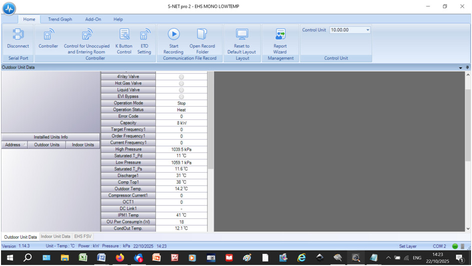

When done, reload SNET. You will now see (on the Outdoor Unit Data tab) the following, showing the new field “OU Pwr Consump’n (W)”:
So now I can monitor my Outdoor Unit power consumption in real time* from the comfort of my laptop. The new field also appears in the Excel log file, in the correct place, so I can calculate my instantaneous CoP on the spreadsheet from this number (Outdoor tab), and LWT/RWT/Water Flow (Indoor tab), along with known water density and heat capacity correlations. (Obviously, true CoP should include indoor power consumption – in my case two circulating pumps and the MIM – but these are small and because the pumps are fixed speed I know the values to within a few W, so I can make a simple adjustment on the spreadsheet.)
