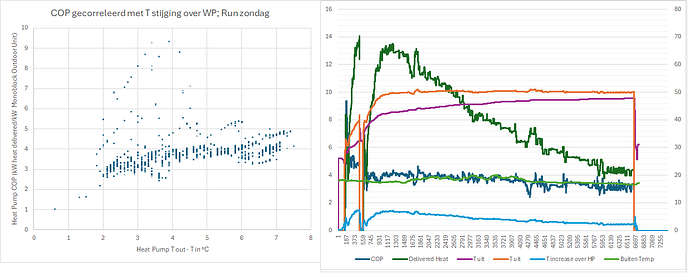

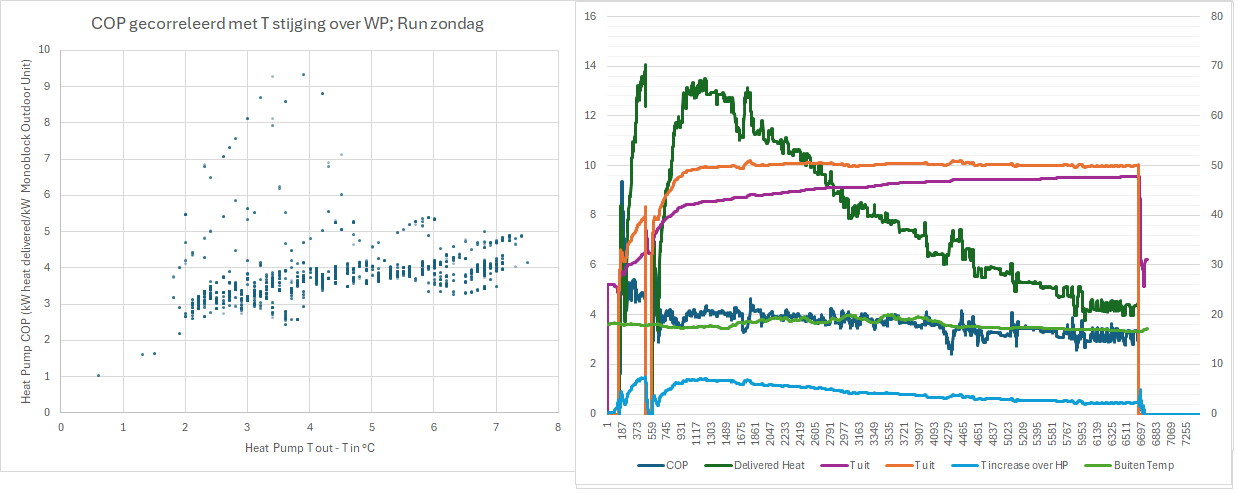

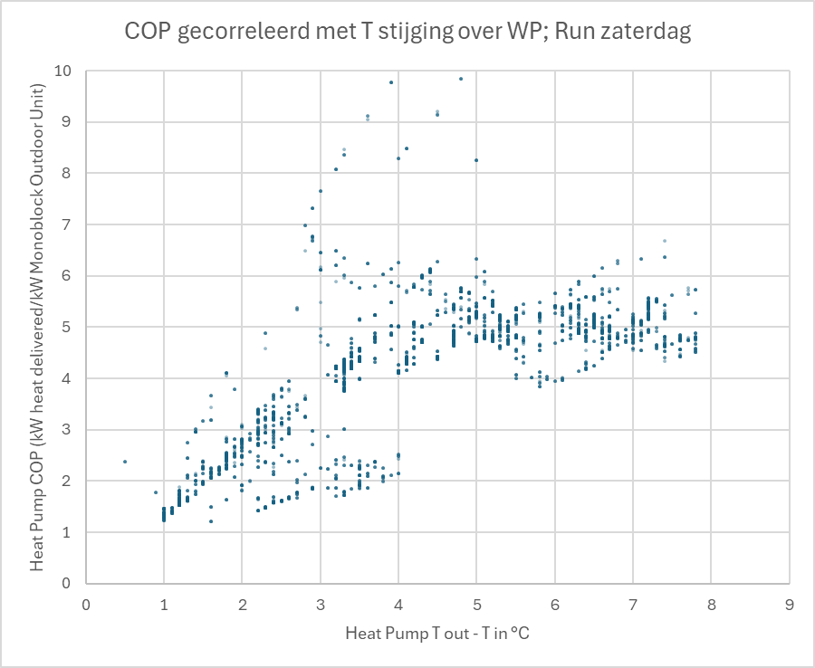

I used a service tool (Samsung Snet 2 Pro) this weekend to analyse the poor performance of my Samsung AE160RXYDGG heat pump.
Did various correlations but this one is the most interesting.
Apparrently below 4 °C something happens in the heat pump that reduces the COP.
Note that I have a fixed flow water pump so no means to influence temperature over the heat pump independent of the heat output.
Most of this data is a run of a few hours where the heat pump was filling my 3000 liter heat storage with a fairly constant output temperature of approxim
ately 47 °C. As time progressed the storage slowly filled and the return temperature of the heat pump slowly increased while the outlet temperature was fairly constant.
Outside temperature remained fairly constant during the day.
Does anyone know what happens in the heat pump that ruins the COP when temperature increase over the HP drops too far?
Update: Run of today added…slightly higher setpoint (~50 °C) and slightly lower outside temperature. Run lasts from 14:30 to 20:00 approximately.
Due to less irregularity the curve is more gradual and does not slow the sudden change in slope of the run yesterday.
Very interesting observations, @Martijn_Hinderdael.
What is this, and how does it work? (That is, where exactly does it get the measurements from?)
I 'm not familiar with the AE160RXYDGG, but things I’m thinking:
  • Is there an energy consumption overhead load that isn’t proportional to compressor energy as its speed falls? This might, for example, include the fans if they run at full speed even at minimum compressor speed (thus energy produced), your fixed speed circulation pump, the electronics (though those would likely not be significant), and the compressor seal OCR (oil circulation ratio) - if the machine needs a fairly constant oil flow to maintain the seal even at low speed. (Samsung don’t seem to publish the OCR data so it’s hard to make the calculations.)
  • I also have some evidence (though far from proof) that the compressor BEP (in my AE080BXYDEG) lies at roughly 50Hz inverter output, with a 10-15% efficiency drop at 20Hz (the minimum). If this is actually true, it might partly explain the lower CoP at lower HP outputs. This could be linked to the above OCR effect, but could also reflect other machine non-linear losses such friction (e.g. bearings), and inverter losses.
  • Could the (LWT - RWT) calculation be less accurate at lower DTs (the effect of instrument precision)? Or might your CT have a zero error which becomes more significant at lower compressor speeds?
  • Does the AE160RXYDGG have an intercooler circuit with compressor vapour injection at the interstage? If so, the controller may be diverting some of the R32 at lower compressor speeds which could increase the machine energy requirement.
If you can tell us more about your instrumentation (location, precision, accuracy etc.), other possibilities may come to mind.
Should have been more specific: It was just Samsung Snet and relying on the heat pump’s own instrumentation :slight_smile:
Ah, so where is your Outdoor Unit power data (for the CoP calculation) coming from? Just the remote display? (SNET doesn’t show it.)
One other thought. At constant LWT (which you have, looking at your last graph), an increase in RWT will increase the required R32 condensing pressure = compressor discharge pressure. At constant ambient temperature (which you also have) the suction pressure will be constant, but the pressure ratio will be increasing, which consumes more energy.
(This assumes that the controller compressor energy minimisation algorithm minimises discharge pressure consistent with minimum subcool in the condenser, and maximises suction pressure consistent with minimum superheat in the evaporator.)
I’m beginning to wonder whether your CoP calculation method needs closer examination - those data >> 5 worry me, even if they are only scattered…
Snet shows compressor current and dc voltage. I also have a separate power meter behind the heat pump.
I checked a few times if DC Voltage x compressor current was equal to the output of that meter and it was within a small enough margin to consider that figure useful.
Voltage x Current was actually slightly higher than measured power on my 3 phase meter so I guessed that even fan power is included in the measured compressor current.
It may of course be that this is not the case and part of the current is what we call blind current/blind power in the Netherlands and the calculation somehow gave a fairly similar figure to active power as measured by my power meter. Not sure how that works with DC though.
In any case I think this way of calculating gives a figure usable enough to work with as a comparison between different values in the same log.
On the very high values: If the heat pump ramps up or down the compressor frequency the thermal power is always a bit lagging. So dropping the compressor frequency will lead to a few seconds with a very high COP. That is what you see in the log.
Sarah I see 2 main degrees of freedom in the heat pump when using Snet: Compressor frequency and an actuated valve between condenser and evaporator. (Yes the fans are there too but I ignore these for this moment :slight_smile: )
Do you have any info on how this valve is controlled?
With "how’ I mean: What parameter is it set to control (R32 condensate subcooling at condenser outlet? Temperature difference between entering water and leaving R32?)

I imagine that the valve is to guarantee full condensing before letting the pressure down. If you also let down vapor that just ends up being recompressed by the compressor consuming big amounts of power and ruining the COP. So in my opinion anything other than some form of guaranteeing full condensation of the R32 would be not sensible as a control target for the EEV valve.
Suction pressure is then determined by outside temperature, refrigerant massflow & fan speed. That is: Presuming the heat transfer coefficient on the outside air side is dominant in the heat transfer from outside air to the mostly liquid refrigerant. For fan speed it would be logical to optimize such that the amount of power consumed by compressor and fans together is minimized for whatever outlet condition the compressor is trying to achieve.
For the compressor control algorithm I would have guessed it would strive to achieve a certain pressure but instead there is a column stating a target discharge temperature. Taking a look at some output of Danfoss Coolselect (a program to design refrigeration/heat pump cycles with Danfoss hardware) and then especially the LogPH diagram of the designed thermal cycle I can only imagine that the amount of superheat (and from that: Estimated condensing temperature) correlates fairly well with the temperature difference between compressor in- and outlet.
Measuring temperature instead of condenser pressures is comfortable since it does not require physical contact (and therefore a potential leak source) between sensor and medium.
The compressor current being displayed with unit degree C is in my opinion just a blunt error or something meant to cause confusion. In any case the unit is nonsense for the quantity displayed. Similar for DC Voltage.
This and some other peculiarities (such as the compressor shutting down upon exceeding the water outlet temperature setpoint without much of a timer and without the additional boundary condition of the compressor having achieved minimum RPM for some time) make me feel that much of the programming was done rather quick and dirty.
I have noticed on my display that power consumption does not update frequently. Much less frequently than the values on Snet and the output of my power meter. So I do not take that value too seriously. Again the instantaneous value of Voltage x Current in Snet correlated well with the instantaneous value measured on my external power meter.
Expecting a good correlation between compressor frequency and temperature increase of the water (presuming fixed water flow) or heat output is logical as the compressor has a sort of fixed suction volume per rotation and as long as pressure at the inlet does not vary that much the refrigerant massflow per compressor rotation should be fairly constant.
