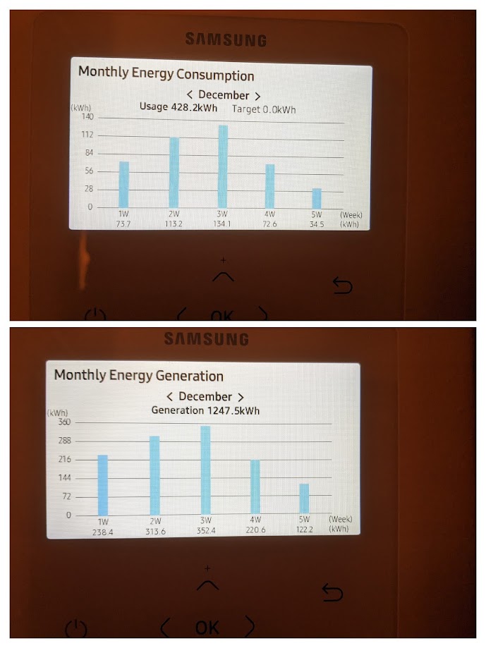

Glyn, how accurate is the data from the Samsung control panel vrs your data? Do you know if the ‘Energy Generated’ is total heat output or output - electrical input?
Samsung measures the electricity use pretty accurately, although it doesn’t include the power used by the pump(s).
However, Samsung does a very poor job of measuring heat output. At least on my system, the heat output displayed by Samsung is 30% less than my heat meter. I think this is party down to Samsung assuming glycol is used (I’m not using glycol) and party due to the Samsung temperature underreporting the temperature of the flow/return. Samsung’s temperature measurements are about
1° C below what my MID approved heat meter and my own digital DS18B20 sensors report. 1° C equates to about 1kW difference at a flow rate of 16.5L/min e.g yesterday Samsung reported 33kWh of heat while the heat meter reported 50.7kWh.
The result of this is that in December Samsung reported a COP of 2.9 while my MID approved heat and electricity meters reported a COP of 3.9.
I’m inclined to believe the readings from the MID approved meters, I’ve also double-checked the temperature readings from the heat meter which another set of independent sensors and confirmed that Samsung’s readings are wrong. What I’m not sure is do all Samsung ASHPs underreport heat deliverd? Or is it just my unit? It would be interesting to find another Samsung with a heat meter fitted to compare.

Thanks Glyn, that is very interesting to find out and puts the COP of my system in a very different light (I had also been calculating the COP from the Samsung data as Energy Generation/Energy Consumption).
I wonder if you could give some advice on how to configure my emoncms.org inputs to get closer to the values obtained from the Samsung controller.
Year Month Energy Consumption Energy Generation Energy Output COP Emoncms COP
2023 June 71.9 204.8 276.7 3.85 2.38
2023 May 102.7 306.6 409.3 3.99 2.59
2023 April 184.1 560.3 744.4 4.04 2.71
2023 March 408.3 1215.1 1,623.4 3.98 2.65
These are the calculations I have used in Emoncms:
I used the formula below as the basis of my calculation:
kW (heat) = water flow (litres/sec) x 4.2 x Temperature rise (dt in Celcius)
I have used an SHC value of 3.9 as this was the closest I could find a reference for (20% Glycol) although I think my system is closer to 10% Glycol
