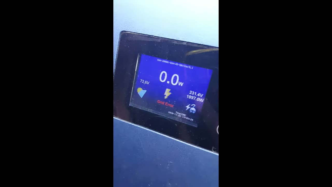

Hi everyone. Somebody can help me this error on SUN GTIL2. Please kindly help…
try that
if not join this group
https://www.facebook.com/groups/958155904321773
from the group –
Reheat/ re solder with soldering iron R6, R7, R8, R9, they are under right cooling fan. There was a manufacturing issue with those resistors, they are drawing moisture.
