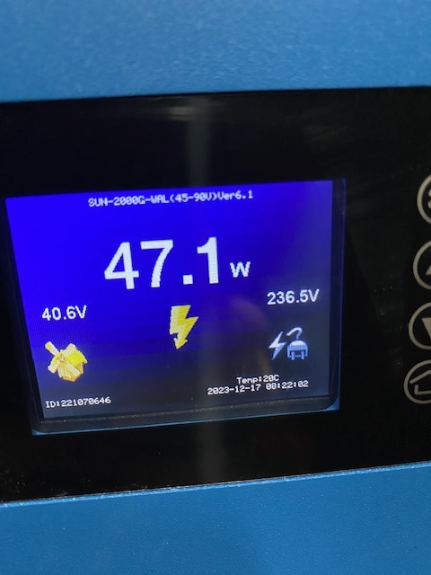

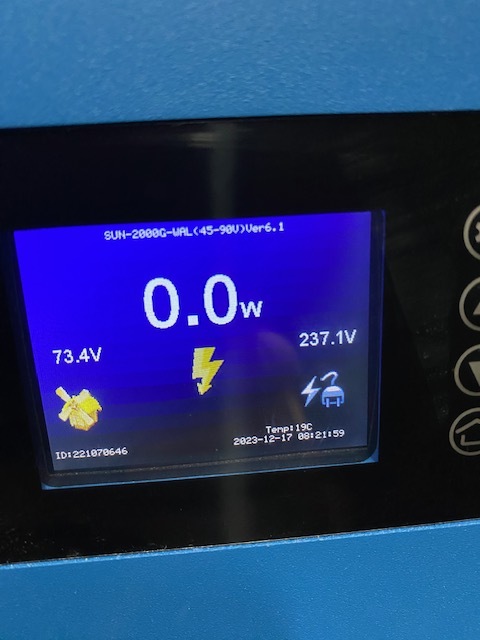

Hi everyone. I have found this post and some of the comments sound familiar to the problem I have. I have bought SUN-200G-WAL inwerter with an LCD display and connected it to the wind turbine (96V). The inverter should start producing electricity when the DC voltage reaches 45V. However, it is only able to reach 44-44,5V no matter how strong the wind is. As a result no electricity is produced. I have changed / adjusted the curve settings to zero for 48V, 52V and 60V, but this hasn’t helped. Does anybody have a clue what might be wrong and how I can fix this, so the inverter allows the turbine to pass more voltage and produce electricity.
When I save settings, the inverter allows the turbine to pass more voltage for a couple of seconds and there is some production, but it only lasts a couple of seconds and after that the production goes to zero and voltage moves back to 44-44,5V. I attach some photos of the problem and the current settings:

Hi Stephen,
Thank you for Your answer. I have 3-phase 96V turbine, so no rectifier is needed as the inverter is also 3-phase (WAL version). The turbine is directly connected to the inverter. The connection has been made by a qualified installer who specializes in renewable energy equipment installation. From the description of how You turbine works, I would expect the same for mine but within 45-95V range. For some reason it doesn’t work as expected. The turbine hits the brake when it reaches 44,5V (at inverter’s DC midpoint as written on the inverter specification) no matter how strong the wind is (it’s been between 4 and 9 m/s during the period I have had it connected to the inverter) and the the blades rotate with the same speed at 4 and 9 m/s. After disconneting from the inverter the turbine can easily reach 60-70V (at wind rate of 6-7 m/s) and it is running much faster. Turbine starting wind speed is 2 m/s and rated wind speed is 13 m/s. What is more interesting is the fact that I have thought that if I buy inverter version You have it is going to work, so I’ve bought one with the working volatge between 25 and 65V. The only effect - the turbine has hit the break when the volatge shown on the inverter reached 22V. I have returned this inverter and stick with the 45-95V model.
I’ve thought that maybe the turbine is too weak to pass the 45V, so it the inverter settings I’ve changed the curve settings as shown below, so the trubine should be able to reach 60V, but nothing has changed with the new settings (the turbine hits the brake at 44,5 and it rotates much compared to the situation when I disconnect it from the inverter. I also hear a “booooo” sound when it reaches 44,5V coming from the turbine (after disconnectting the turbine from the inverter the “booooo” sound stops. Tne turbine is VAWT type of turbine, so the blades are not furling (if I understand that term correctly)
What is interesting is the fact that when I save the settings (even if I do not change anything in th settings) the inverter allows the voltage to surpass this 44,5V hurdle for a couple fo seconds and it produces energy. After 4-5 seconds the break is activated again and the voltage falls below 45V and no electricity is generated (please see below - the production starts with a small lag to voltage increase)

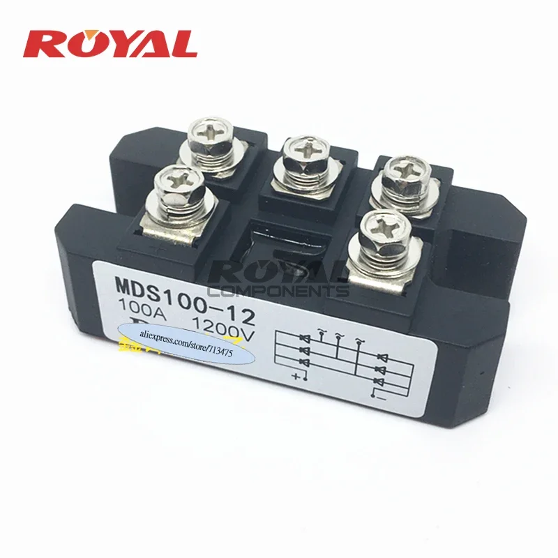

For my inverter bridge rectifier, I use one of these:
mounted to some cooling fins and connected to the DC inputs on the inverter. (after removing the other bridge rectifier) You can test the bridge rectifier with diode function of a multimeter.
