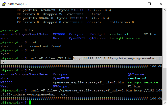

The last V2 GUI I installed yesterday won’t allow any update - the update does nothing and doesn’t ask for a file etc.
I’ve power cycled, reset on the GUI but still no luck. What do I do now??
There was change yesterday to the release process changing filename, it broke the UI firmware update. I’ve fixed it this morning and added some security to prevent UI breaking if there’s other changes.
You can still flash it using curl ( you can use latest build, it’s fixed on them ) , it’s only on the UI side.
To flash with curl :
curl -F file=./yourfirmware.bin http://openevseIP/update --progress-bar | cat

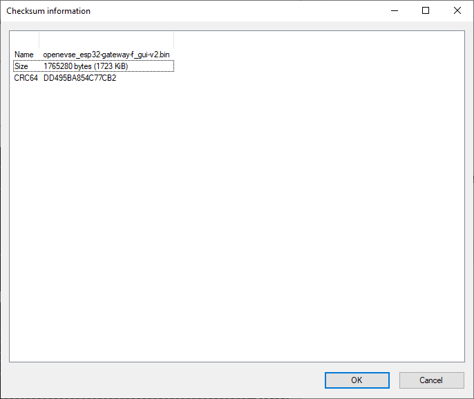

I’ve just used the last V2 gui pre-release posted at 11:43 and it isn’t fixed …
Commit: 2d34a3a
And the time is wrong again!
I’ve just tested it and it works ok, so you either put the wrong file after extraction, or some cache issue somewhere .
edit: or previous update has failed
you should get those, not the 4.1.9 pre release : Release V2 GUI pre-release Ā· OpenEVSE/ESP32_WiFi_V4.x Ā· GitHub
Also if you have the time wrong it means it’s not a recent build or you haven’t updated time since the time fixe or you’ve switched back&forth to an old build / new one.

The update button after doing this still doesn’t work.
Can you post the chrome console output ?
In developper tab
There should have an error here
