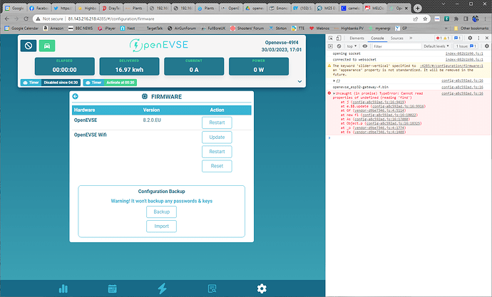

Cleared cache, the browser is Chrome (on Windows but also doesn’t work on Android) and the output is below …
pretty sure the fw is not good. Are you behind a kind of Squid proxy ?

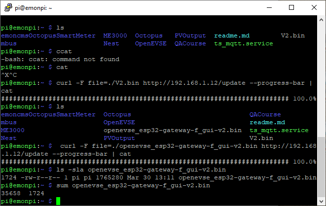

This is the problem then, it has not updated at all, your openevse web interface is protected by login / pass.
The curl progess bar probably jumped to 100% directly ( and because of displaying the progress bar using the | pipe , you don’t see the error message )
You need to either remove http openevse credential before updating or add the login pass in the command line, something like --user user:password

so for those with the same problem the curl command if you use credentials is
curl -F --user:login:password file=./yourfirmware.bin http://openevseIP/update
with the progress bar ( but hide errors )
curl -F --user:login:password file=./yourfirmware.bin http://openevseIP/update --progress-bar | cat
That didn’t work. I removed authentication and ran the curl which jumped to 100% immediately and the GUI restarted, then the curl eventually stopped with an error (Recv failure).
The retstarted GUI has the same issue with Update.
I took the board out of the unit and used esptool.py to flash the firmware and still no dice.
The latest version is still showing the console error when trying to update (and hence doesn’t).

It’s certain you still are not up to date. This bug can’t happend anymore ( I had removed this part of the code on ui )

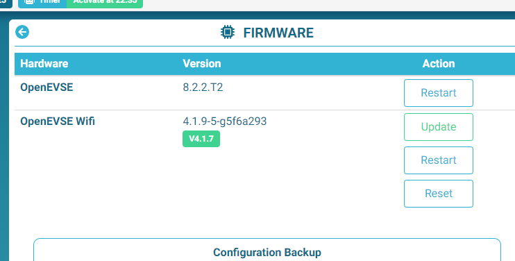

That’s what I wanted to see. Look if it has updated to my build, you should see that :
The empty version showing in your screen is still the build from github, and so this is certainly still the one from yesterday.
Something is not upgrading on your side

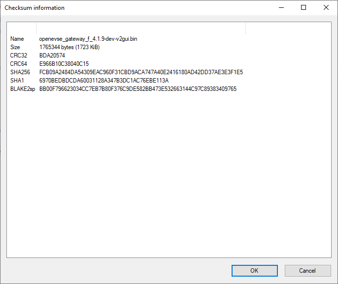

can you md5sum the binaries ?
I’d also try a full flash erase on the esp32 (but not sure how to do that).
