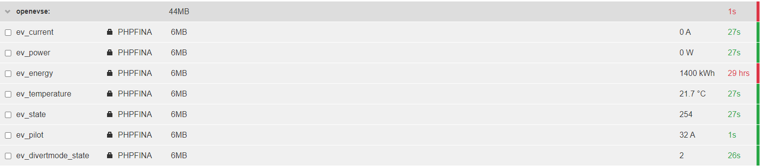

Hi,
since the last update I did I have lost the ev_energy feed. Just updated to the latest version and still the same :frowning:
John
What openevse property where you getting for ev_energy ?
there was changes with the latest energyMeter in wifi firmware. some properties will be deprecated soon, but should works. The ‘wh’ has been removed, it was trailing around for long but there’s no sense to publish the same value twice ( conversion to wh can be done on client side )

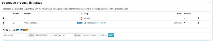

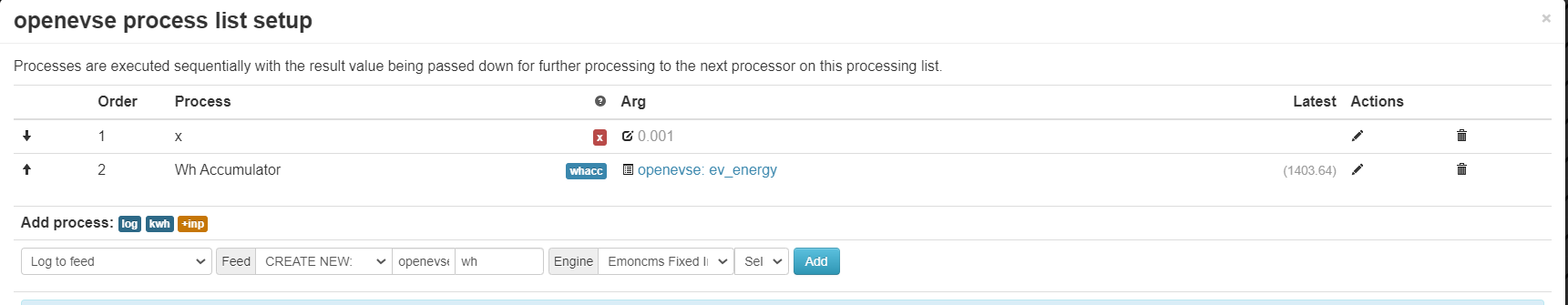

Hi, @Guillaume_S
yes it is the wh feed that is used by the emonpi to give you the session charge amount in the phone app.
what should I change in the input section to get ev_energy back again? Thanks

Do you have any clue now that “wh” is not fed to emonpi emoncms what should be used to get the bar graph back on the phone app to see the session’s charge?
John
The charge delivered in the session is in the topic “session_energy” as mentioned above and it is in watt-hours. I am running it now and looking at it increment during a charge session.
HOWEVER, it is being published to MQTT but not to emon. Lots of other stuff is, but not session_energy nor total_energy and the former is probably also tied up in the wh topic also not working.
Ho I think I know why. I’ve completely forgot to add the new energyMeter data to the emoncms_publish().
I’m adding it now:
new build here :
https://drive.google.com/open?id=1FjYBbFW2SXE_5jxBuc-knzxWo3vFwJwK&authuser=hotlobster75%40gmail.com&usp=drive_fs
With the new build, there are more feeds working to emon but still not wh, volt, session_energy, total_energy, elapsed, session_elapsed.
Wh has been removed as explained above. It was a duplicate of total_energy (*1000) and announced to be obsolete for more than a year now :slight_smile:
there’s probably some stuff to change a bit on emoncms part to integrate those new data. But they are published indeed. ( but “wh” that has been deprecated for total_energy )
