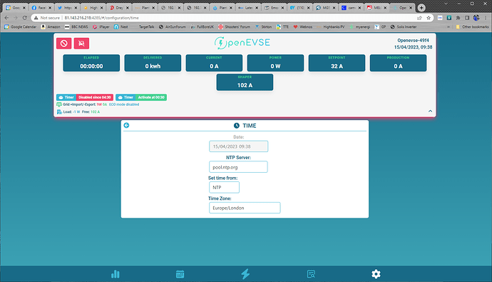

I updated to the (then) latest build sometime yesterday and immediately afterwards the time displayed was out and still is now after upgrading to the latest (at the time of writing).
I’m on the Europe/London TZ and hence confluent with UTC right now but the UI thinks it’s an hour ahead for some bizarre reason.
I wasn’t charging a car last night but my wife’s needs a charge tonight as she’s working tomorrow hence I’ve got to stay up and possibly initiate a manual charge just in case.
Why has this been broken?
have you checked your time zone settings has not been reset ?
There was a bug with config reset after firmware flash from few weeks. Looks like it is solved with today builds

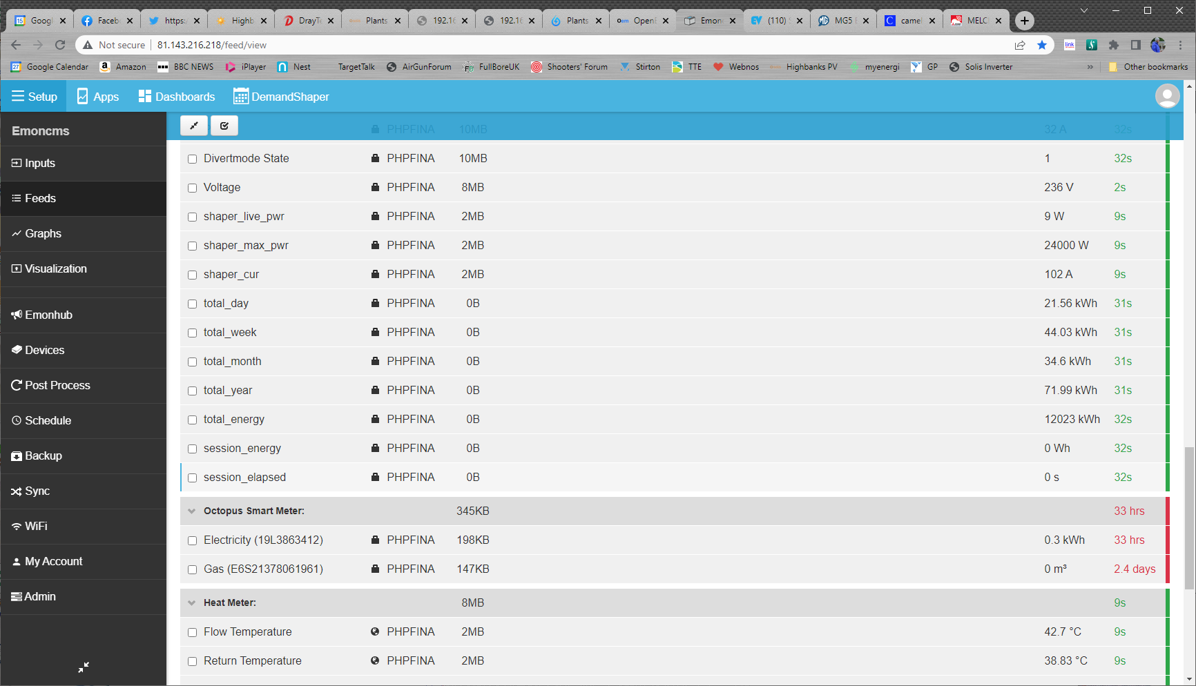

Has something changed recently in the beta that altered published mqtt feeds?
For example the wh feed which is used in the total energy delivered accumulator hasn’t come through for 2 1/2 days.
Definitely updated to the latest firmware once or twice since then.
@greentangerine watthour and wattsec has been deprecated for a while, it has been removed.in dev builds.
Please use new energyMeter data ::
  • session_elapsed ( sec )
  • session_energy ( wh )
  • total_energy (kwh)
  • total_day (kwh)
  • total_week (kwh)
  • total_month (kwh)
  • total_year (kwh)

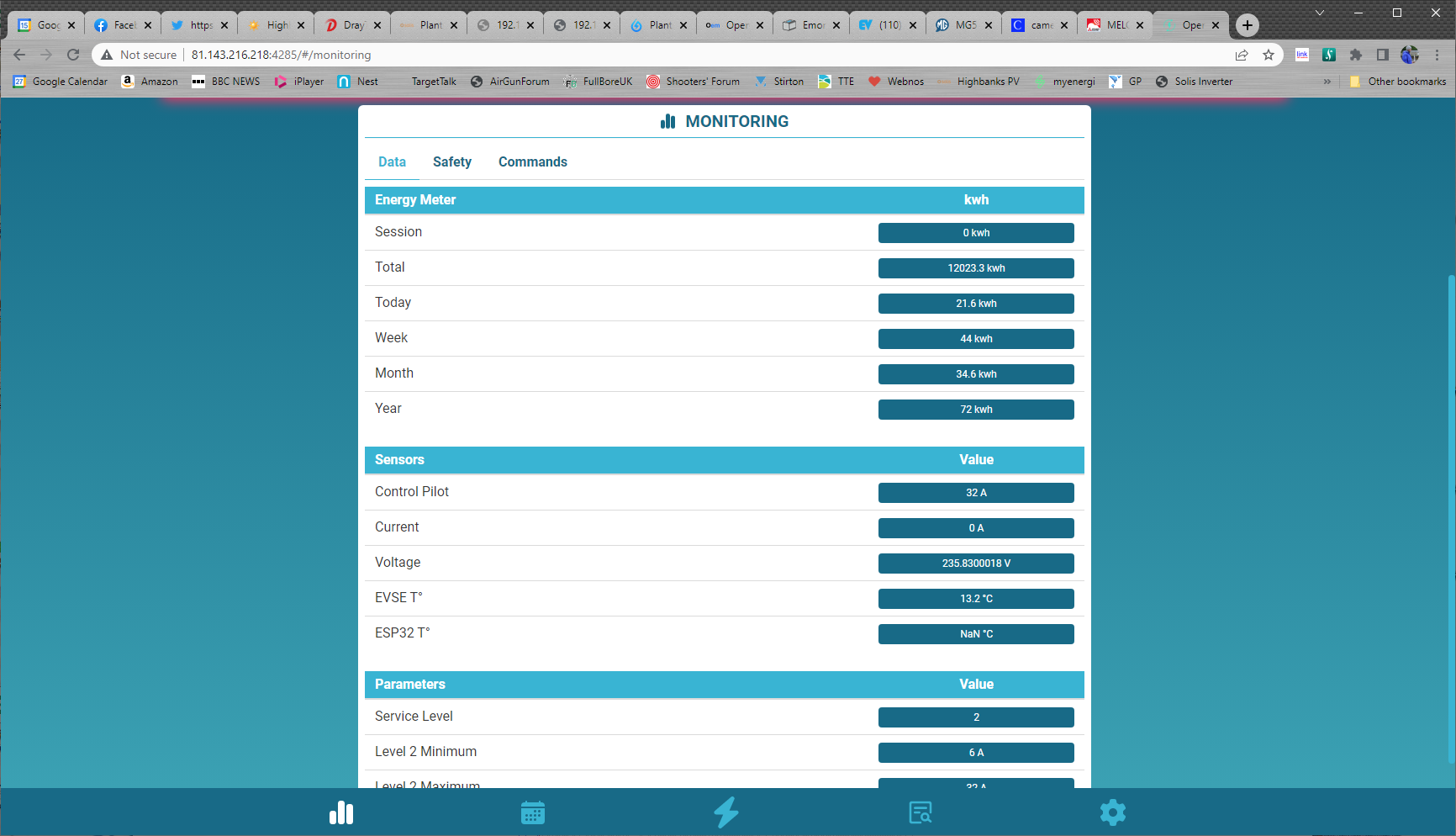

Any idea why the month value is less than the week?!
And the time is still broken somehow. It’s one hour ahead again …
yeah it’s normal for the time problem, I’ve pushed an update on the UI before the time/schedule fix from jeremy has been merged on master, because I’m leaving for a week.
Should happend soon.
I’ll need to check when I’m back for the weekly/monthly. Saw womething strange happening too.
Have to figure out first which one is wrong.
Given my wife’s Zoe has taken about the same the last two nights and assuming week begins Monday then the daily and week values are correct.
Month is someway off what it should be given we usually charge every night and it is generally between 20kWh and 28kWh and so therefore is year (but I guess depends on when it started).
If you have tested different buids the last days, I’ve perhaps already fixed it but your counter has not reseted yet.

Interesting, the time shown in the web browser in the UI is correct but the time shown on the display of my OEVSE box is one hour earlier!
Jeremy fixed some timezone issue,.it was merged yesterday I think. I need to update the UI to the new /time endpoint when I’m back
