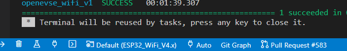

How do I tell platformio to use the new GUI to build against (ie set the env variable in platformio.ini).

Thanks, I don’t know how to get PIO or VSCode to see that env variable that I set in the shell. The export only applies to the current instance of the shell ? (I’m on a mac)
set it in your .bash_profile :
export GUI_NAME=…/openevse-gui-v2
export PLATFORMIO_BUILD_FLAGS=‘-D DISABLE_WIFI_PORTAL -D WEB_SERVER_ROOT_PAGE_INDEX’
When you will open platformio it will then have access to those env variables ( if started from the same user )
You’ll have to logout from your shell after setting the .bash_profile, and login again to get the env var ok
I guess you’re on linux and launching vscode from the prompt, which would take the variable into account.
On mac it launches in it’s own environment.
When I build it, I get ‘Not found’ when going to the root URL :frowning:
I’m on windows, using WSL vscode extention

try to run the shell from the icon at the bottom :
there set your env variable and run pio command from here to compile your build
the first shell provided is pretty pointless it doesn’t even has pio to run.
ack… you are thinking like I did.
I did that, the build worked, but when I do a PIO upload, it does a clean build and doesn’t take into account the variable setting.
I’ll keep playing…
Use the argument -t upload to build and upload from the command line

I’ve got it working… you can just replace the contents of the existing gui directory with the new repo. The trick is you need to run npm install in the new repo too. I missed that step. After doing that and a correction to the path to timezone.js in vite all seems to be working.

Good news is I’ve got it working. In all my messing around, I simply forgot to rename the directory back to gui. Did that and it all works.
In summary, what I did (not caring about the v1 gui) :
  1. Download the the v2 gui is here : GitHub - KipK/openevse-gui-v2
  2. Rename the old gui directory to gui.bak
  3. Rename the downloaded openevse-gui-v2 directory to gui
  4. cd gui
  5. npm install
  6. add the -D DISABLE_WIFI_PORTAL -D WEB_SERVER_ROOT_PAGE_INDEX’ to the [common] section of platformio.ini
  7. Build & upload !
