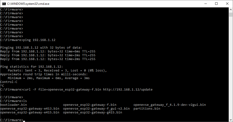

Still try to use curl but without progress bar to catch the error if there is:
curl -F --user:login:password file=./yourfirmware.bin http://openevseIP/update
Yes I did and no difference, hence why I’m going back to something I know works.

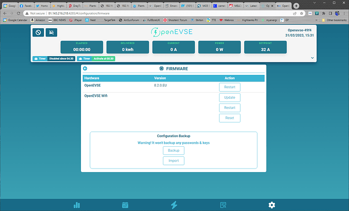

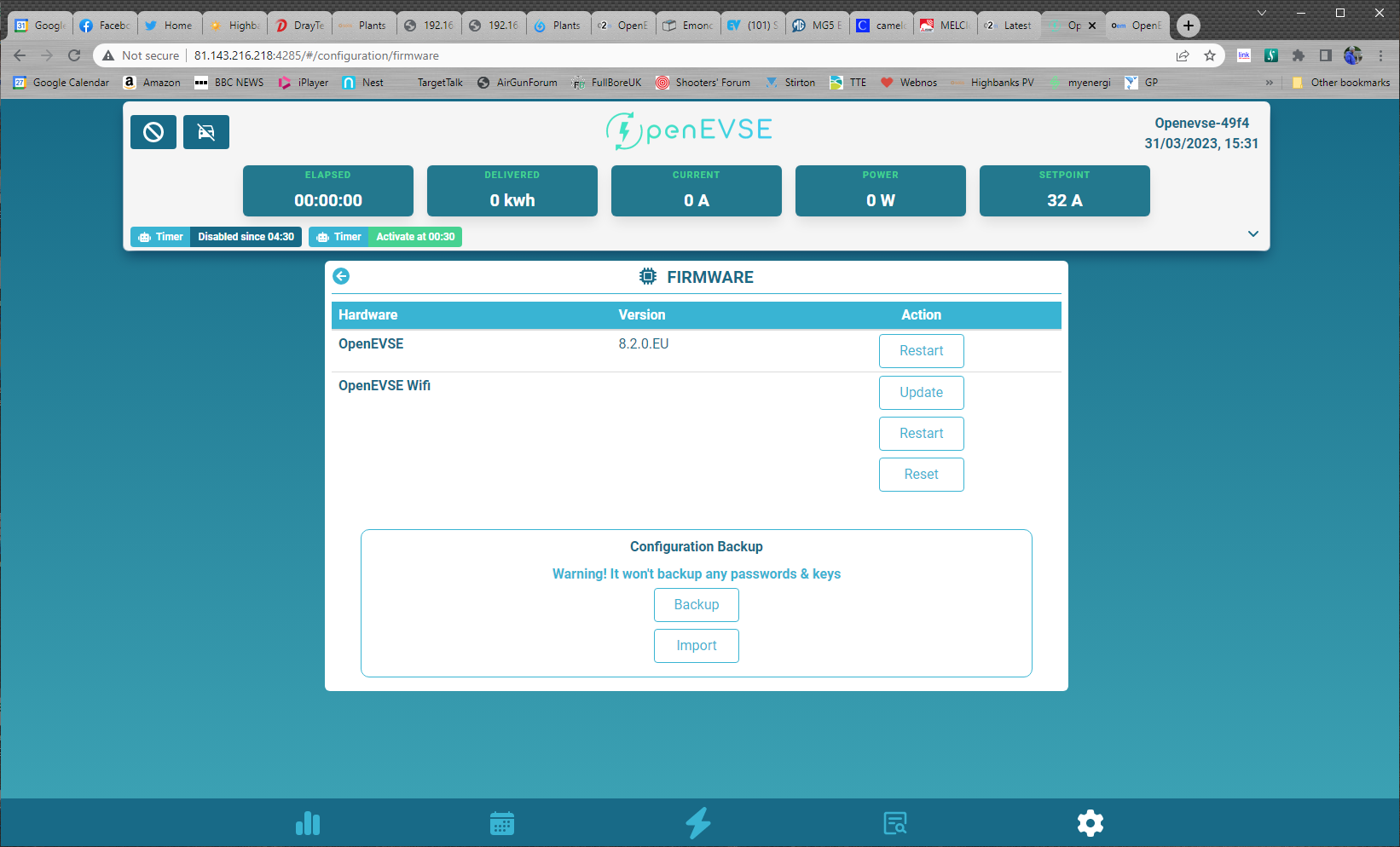

so definitively your board is not upgrading, as it still display empty field in version.

and you have an F board or E board ? I see yesterday you have put the F firmware, and now there’s booth on your folder. Haven’t you mixed up things ?

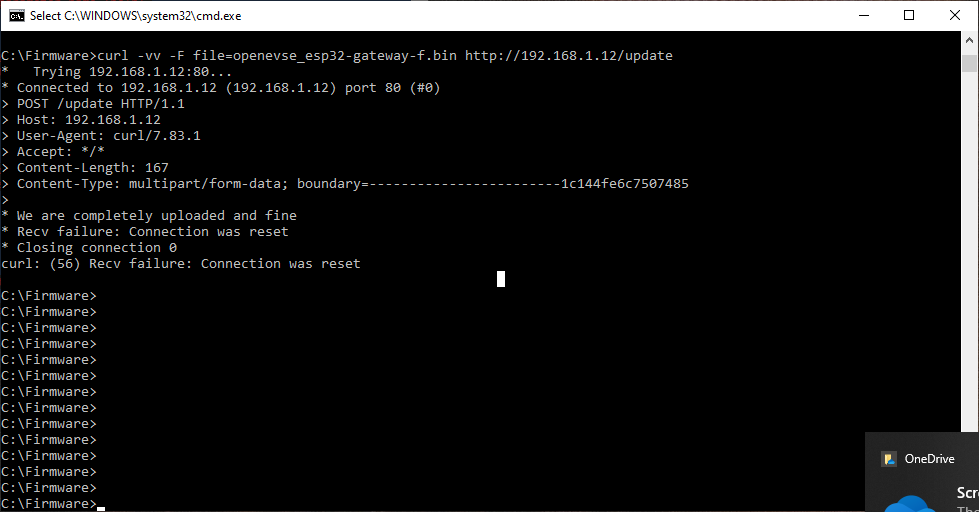

can you also try curl on linux ? ( windows wsl is ok )
seems your windows curl binary doesn’t output much
try to add -vv to the command too
G board - those files are legacy and didn’t work back in the day (but there was no F/G release then and now there is).

Ran on Windows with -vv and get the below. So it seems to have uploaded and the screenshot of the GUI shows the time is wrong again so it did something but that .bin file is 4.1.7 with the original GUI yet that’s not what’s there!
Has something changed in the boot and it’s picking up stuff that isn’t being written by curl or esptool?
That’s what I’m saying, something is not flashing on your side, that’s what you have to figure out.
The time beeing wrong again is normal if you have set the time with the installed build that is not working, then when you restart, time should be wrong again.

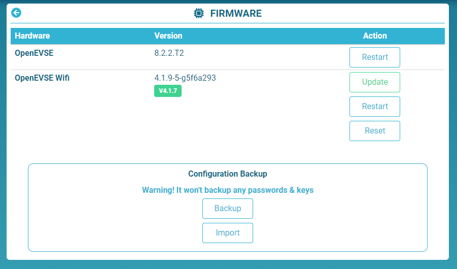

Anyway, a complete wipe of the flash before loading again did the trick.
Lost all my settings which is a PITA but all working again now.
